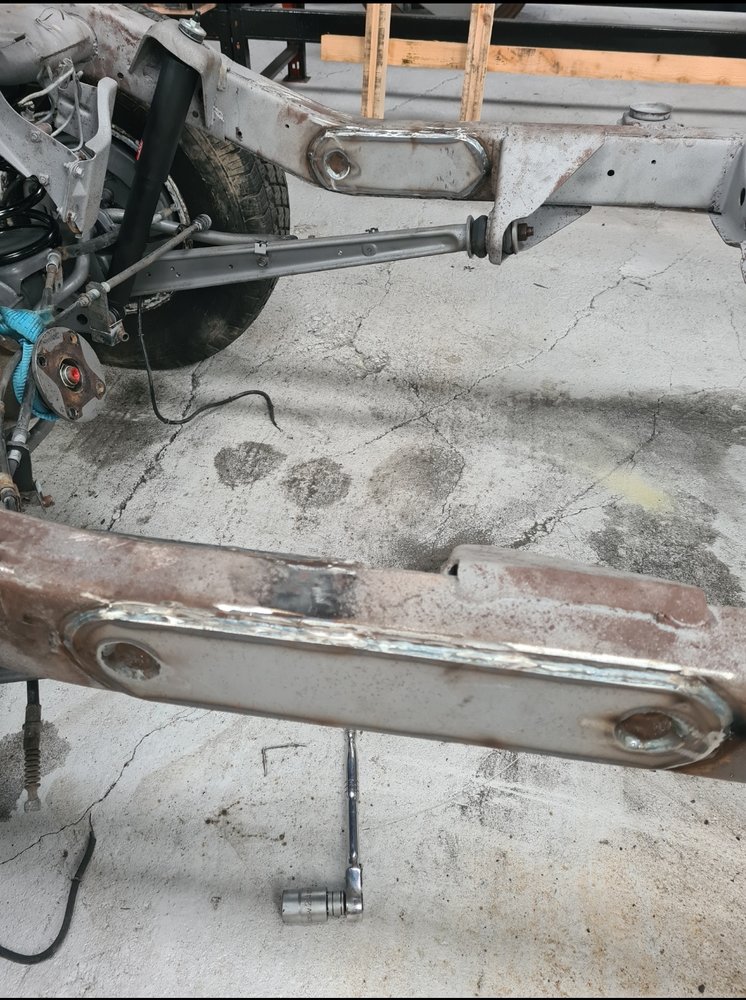

K Kop77 New Member Messages 2 Location Ireland Feb 24, 2022 #1 Hi all,.. I've a chassis that I want to get dipped and I'm wondering if I'll have any problems where I got it braced, It's plated on both sides of the chassis and either side of the chassis leg, I'm worried about expansion between the steel..?
V voipio Member Messages 4,044 Location Not Cambridge Feb 24, 2022 #2 The galvanisers won't touch it if the breather holes aren't in the right places.
