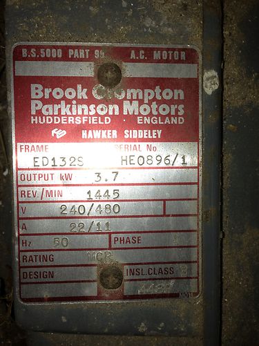

B Bsmith Member Messages 2,674 Location Leyland UK May 13, 2013 #1 Can someone tell me what hp this motor will deliver please? I imagine it would be 22amps to start then 11amps run. On second thoughts, is it 22amps @ 240v and 11amps @ 480v? Thanks fellas. $(KGrHqV,!k8FF-jBtGQ8BRj5!8ZEdQ~~60_12.JPG 43.3 KB · Views: 418

A anjum Member Messages 1,201 Location London UK May 13, 2013 #2 5hp and its 22a at 240v OR 11 amps at 480v.
graffian Seer unto the end of his beard Messages 3,809 Location gatwick May 13, 2013 #3 anjum said: 5hp Click to expand... 3.7/.75
A anjum Member Messages 1,201 Location London UK May 13, 2013 #4 Actually 3.7/.746 Neigh bother. So watts a watt between friends!!
B Bsmith Member Messages 2,674 Location Leyland UK May 13, 2013 #5 Great! Thank you. I thought (info i got somewhere) it was worked out like 22 x 240 / 746 = more like 7hp, which I know is wrong.
graffian Seer unto the end of his beard Messages 3,809 Location gatwick May 14, 2013 #6 Bsmith said: Great! Thank you. I thought (info i got somewhere) it was worked out like 22 x 240 / 746 = more like 7hp, which I know is wrong. Click to expand... That's input power allow maybe 70% for efficiency and you will be closer. so try (22*240*.7)/750.
