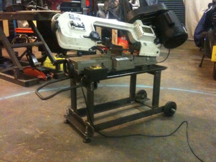

Thought I'd post a picture of the stand I made this week for my 6x4 bandsaw. The factory stand was so flimsy it scared me into over engineering this out of 50.50.6mm angle, 50.3mm rectangular box and 3mm plate for the drip tray. The plans for this were taken from the yahoo group, specifically George M Carlson, credit where credit's due!
Wheels and adjustable feet from RScomponants, handle is retractable too which is a nice touch. Few other mods to do yet...
