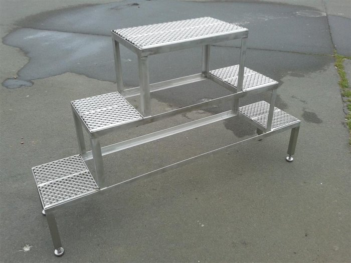

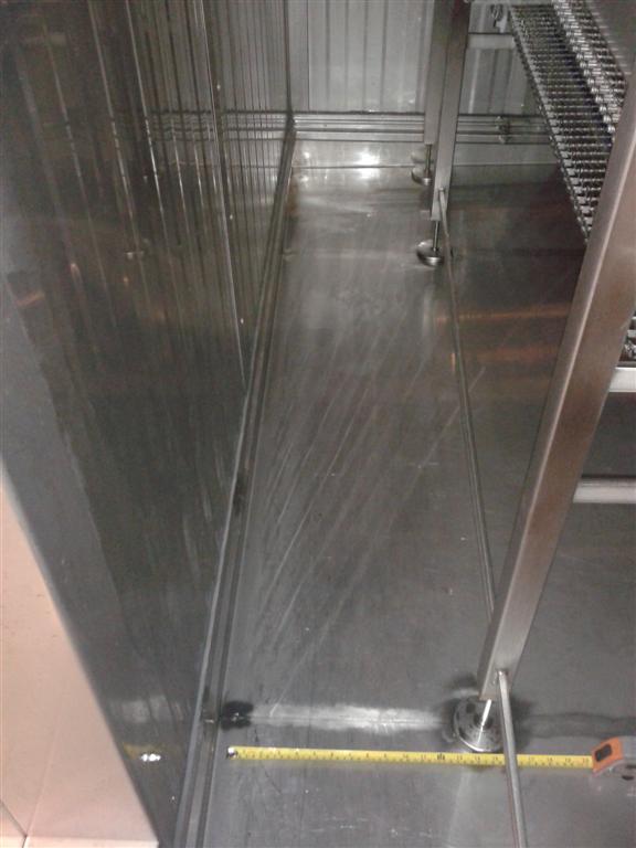

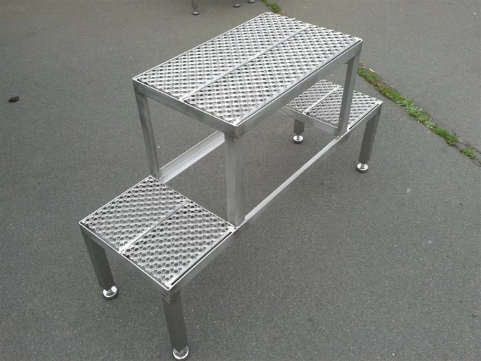

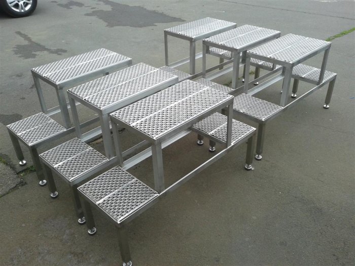

Hop up steps for use by cleaners and engineers, these will live inside a nitrogen chiller and spend most of the time at minus 35 deg C so the perforated planking is to hopefully prevent ice / frost building up, all stainless of course and fitted with adjustable feet with rubber bases.
