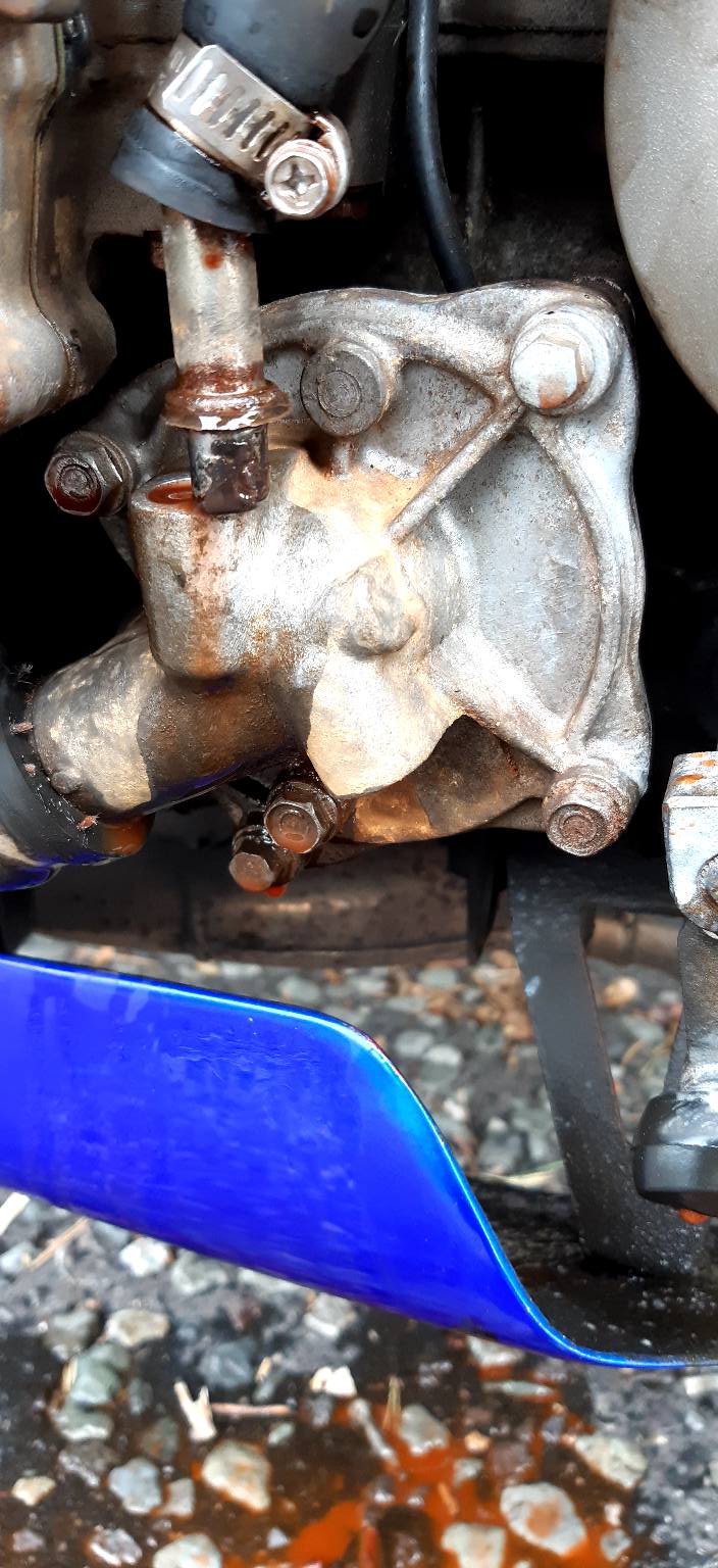

looks to be the wrong size and squeezed down
Motorbike coolant hoses look like that when they age. Never causes any problems.
It is water cooled, unless you are pumping hot water which is unlikely I would have thought.
Aaaaah, I was thinking it was a water pump as in pumping water, I realise now it’s a engine water pump. My mistake. The**
It will be running at engine temperature so it will be hot I should imagine, fan kicks in about 90* C
Not so sure about JB weld, I used it on a wallpaper stripper & with the steam it went like jelly, that really surprised me as I’ve used it before without a problem. When I built my trials car years ago, I cut a hole in an A series thermostat housing & Araldited a radiator filler neck in, that lasted several years. That was the old stuff that goes really hard, not the new quick set stuff, that remains softer. I think I would pin it as well, belt & braces, just in case.
JB weld is good for 250C, I used it a few years ago to make the inlet ports on a cylinder head smaller
