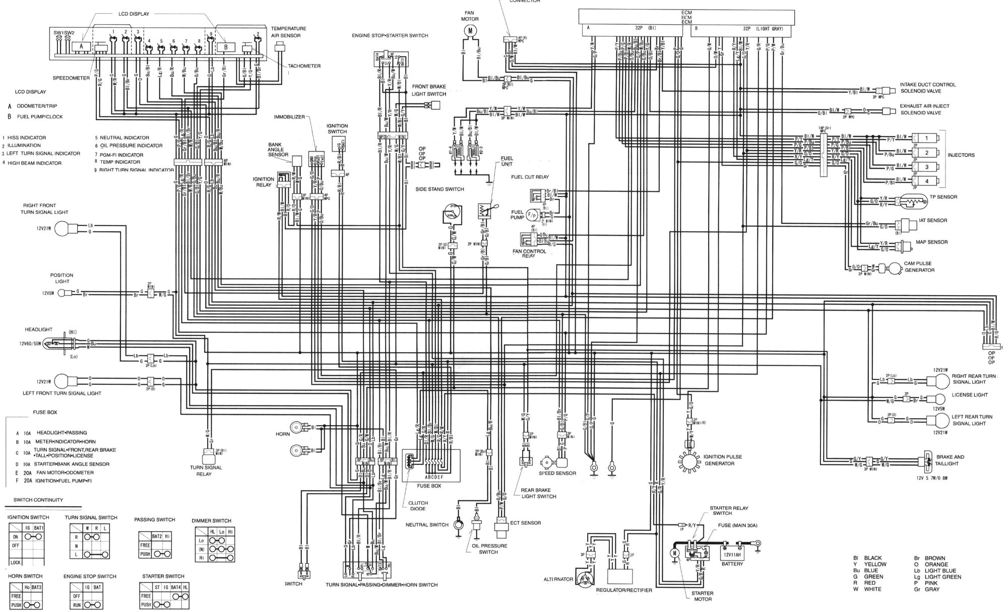

As the title suggests, would anyone have a wiring diagram for a Honda CB1300.
Mine keeps blowing the 20A FI/Ign fuse, and I'd like to look at a diagram to see if there is anything else that runs off that fuse.
I suspect it's some damaged insulation somewhere as it ticks over just fine till I move the bike or stand it up. and then it just blows again. Had the same thing on a CB500 a few years ago.
Initially I thought it was associated with the switch on the side stand, but I disconnected it and it still happened, so looks like a strip down is in order
