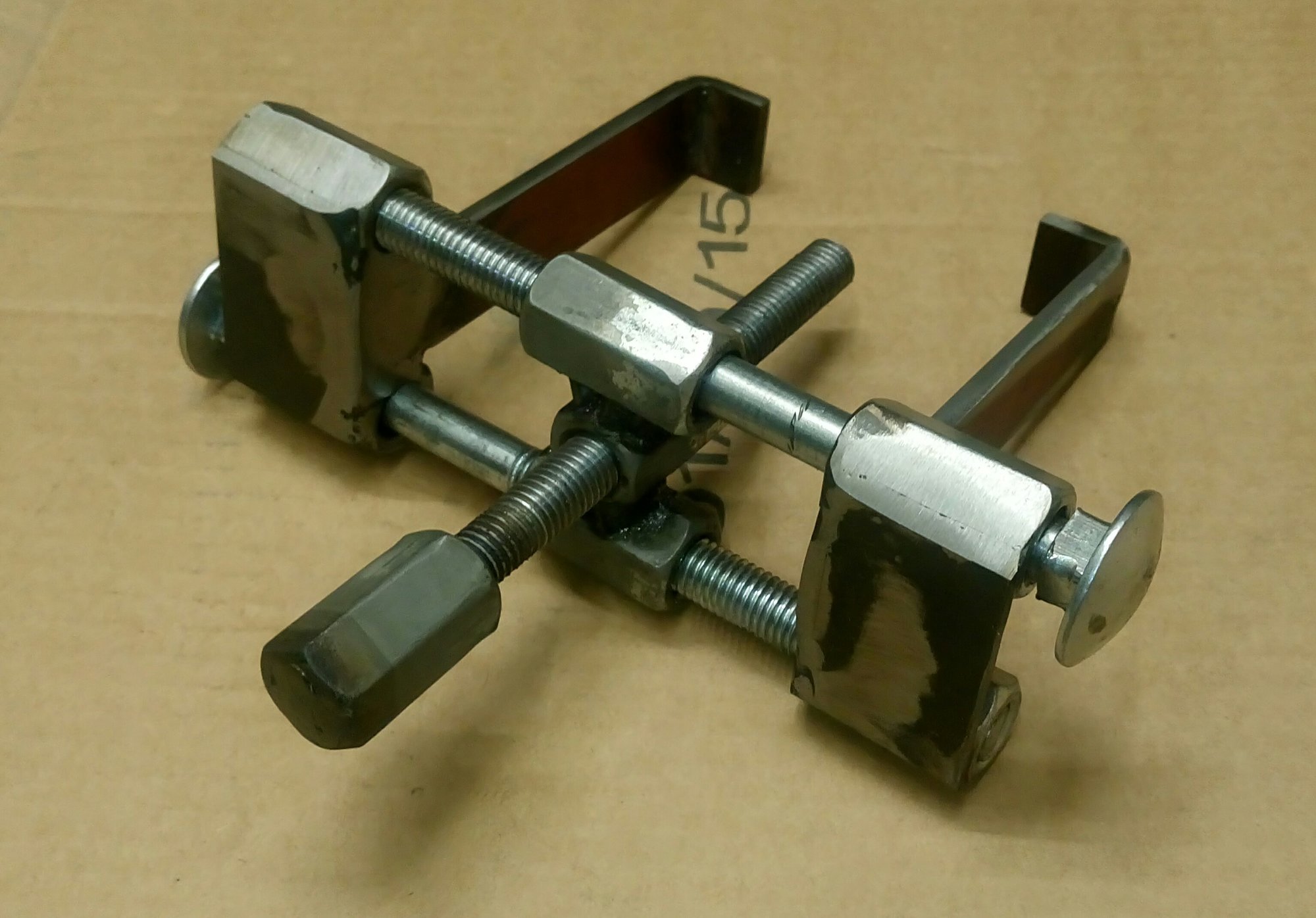

Made a 10-70mm puller with some M12 coach bolts & some connecting nuts:
Nothing particular, But thought I would make one as its one of those tools you need once in a while. For anything bigger I would make something more heavy dutyWhat is it intended to pull?
I know what your saying, Shall wait & see when I actually use it!The small amount of experience I have had with similar pullers is the friction of the thread under load tries to twist the complete puller off the job so spreading and unseating the grip of the hooks.
