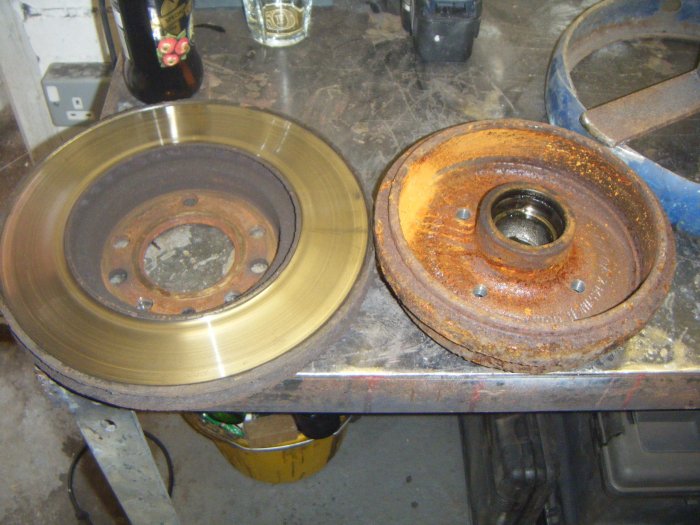

i had a chat with my mate who luckily works at a local ats garage and he gave me these beautys.
its an astra front disc and a rear drum off an unknown vehicle,

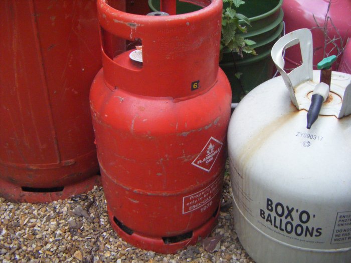

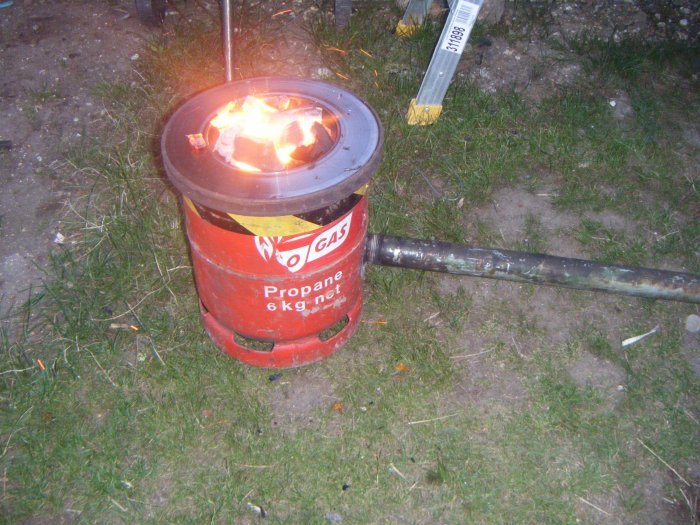

im thinking of using a small gas bottle with the top chopped off as an ash catcher and welding a tube on about a meter long to supply the air via a hairdryer,
im hoping to heat up some rebar and have a bit of fun with scroll work and other projects.

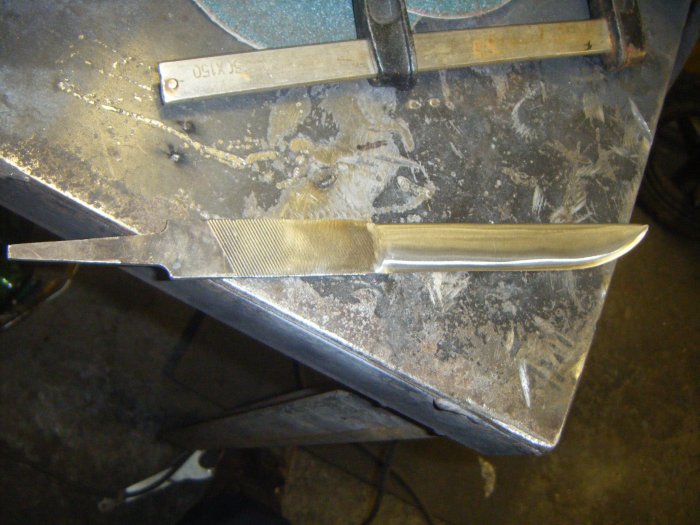

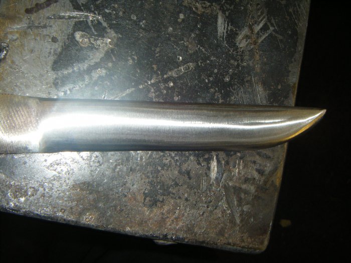

also fancy making a nice bushcraft knife from some big dull files ive got laying around.
they,ll get heated cherry red, beaten to the rough shape then quenched in oil, then out comes the grinder and discs for some final shaping,
