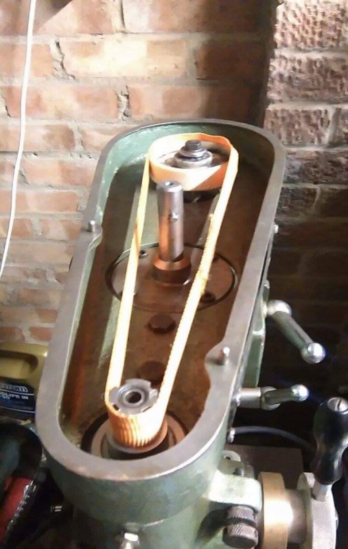

A bit of nylon webbing stitched into a loop to make a belt
. (The large pulley was also quickly made from a knackered gear turned smooth
I had trouble getting accurate holes in a brass part yesterday with a hand drill and I wondered if this would be any easier (Of course the answer is yes
It probably won't last too long but I felt it worth sharing in case it anyone needs a random sized belt fast while a proper one is delivered
