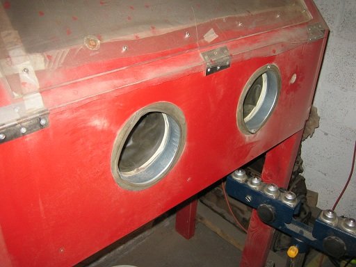

Hi all, I have recently started to make a blast cabinet at home, it’s not finished yet but thought I’d share what I’ve got so far and also ask some advice on where to get bits from.
Here is the build so far in a couple of pics:
Got to use the air drill I bought ages ago but never got around to using it. It sounds awesome, I felt like a professional ; )
I still need to sand down the edges so they are flat and then add the top, attach the door via hinges to the top of the box and also figure out what I want to do with the bottom bit to catch the media as it is spent.
I have a big sheet of Perspex and need to sort the window out. I have two plastic Ikea lights that are going inside so I can see and an aluminium grate already on the inside. It is 600mm x 570mm and takes a 17” rear motorbike wheel and is big enough to turn the wheel around inside without having to open the door. I have lined the rear of the cabinet with rubber sheet so any media that hits it will hopefully just drop down instead of pinging around.
The plan is to have the media gun live inside the cabinet and the hose to come out of the side of the box in to the media bucket that will be below the cabinet for pick up. I have bought a big square plastic vent from B&Q which can slide left and right to open close for when I’m blasting.
What I need help with is:
• The airline fixing, the gun will live inside and I want a coupling on the outside so I can attached and detach a compressor line easily for when it gets put out of the way. The wood is (from memory) 36mm thick and is too thick for the thread of the couplers to get through. How can I sort this out?
• Air/dust extraction. The general idea is to have an outlet that I can put the vacuum hose around until I figure out a better way for the extraction.
• The arm holes. The idea here is to have 2x 6” metal tubing go through the front wall so that I can attach the blasting gloves around them on the inside of the cabinet with jubilee type clips. Only problem is, how do I stop the tubing from sliding through the wall? Remembering that I have just joined this forum to learn how to weld but have not got the gear yet so cannot even attempt to weld.
All comments welcome but I do realise that it is a small compressor and I would love to have a bigger compressor which is more suited to the job but that is just not going to happen and as a result of which this is to be no more than a hobby blaster that will let me strip the crap of carbs and fork lowers and so on for a bike re-build I would like to do in the future.
