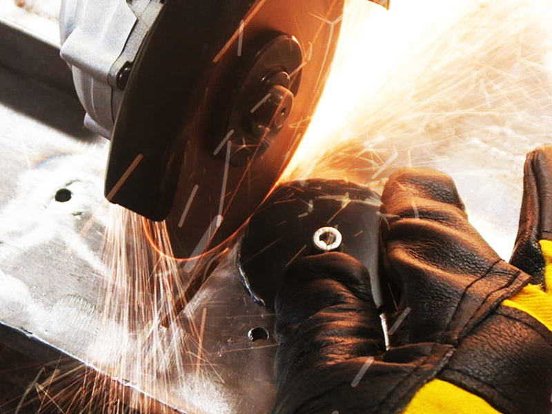

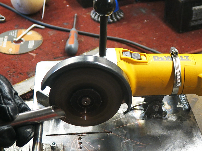

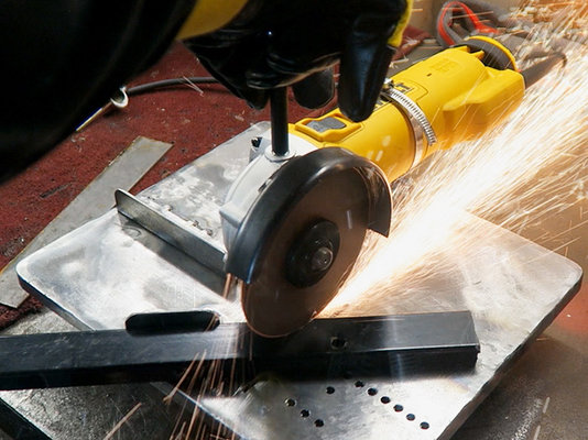

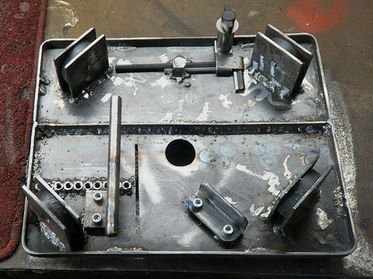

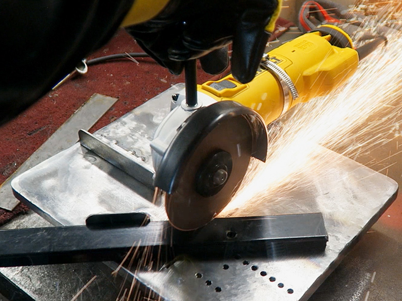

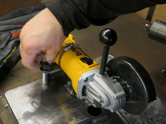

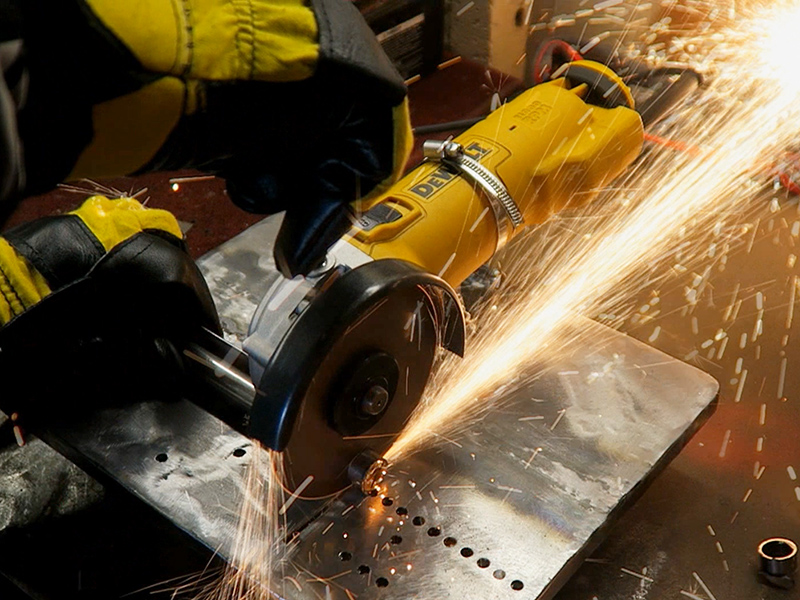

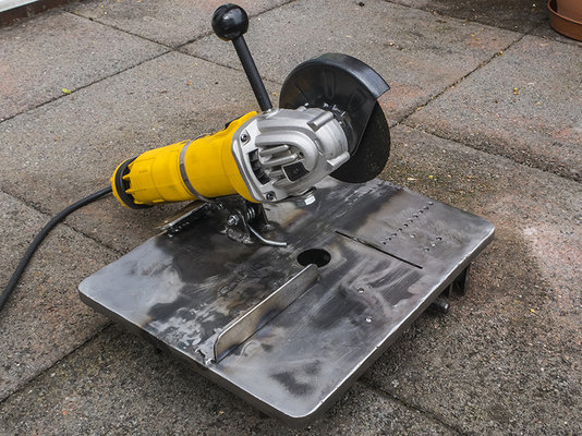

This is by far my most useful homemade tool I have ever made, It makes my angle grinder much more functional and versatile so I bought a 2nd angle grinder and had it permanently attached to the tool
Most of the pictures are screen grabs from my youtube video which is viewable at the end of the post
All attachments fit to the underside of the tool for convenience and also it has magnetic feet which are made from the magnets out of microwaves
It cuts metal at 90 degrees....
and 45 degrees
It can cut circles of various sizes
It can be locked in position for metal grinding
