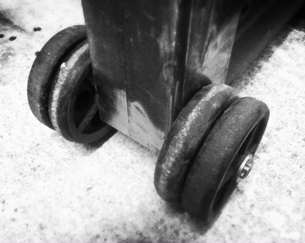

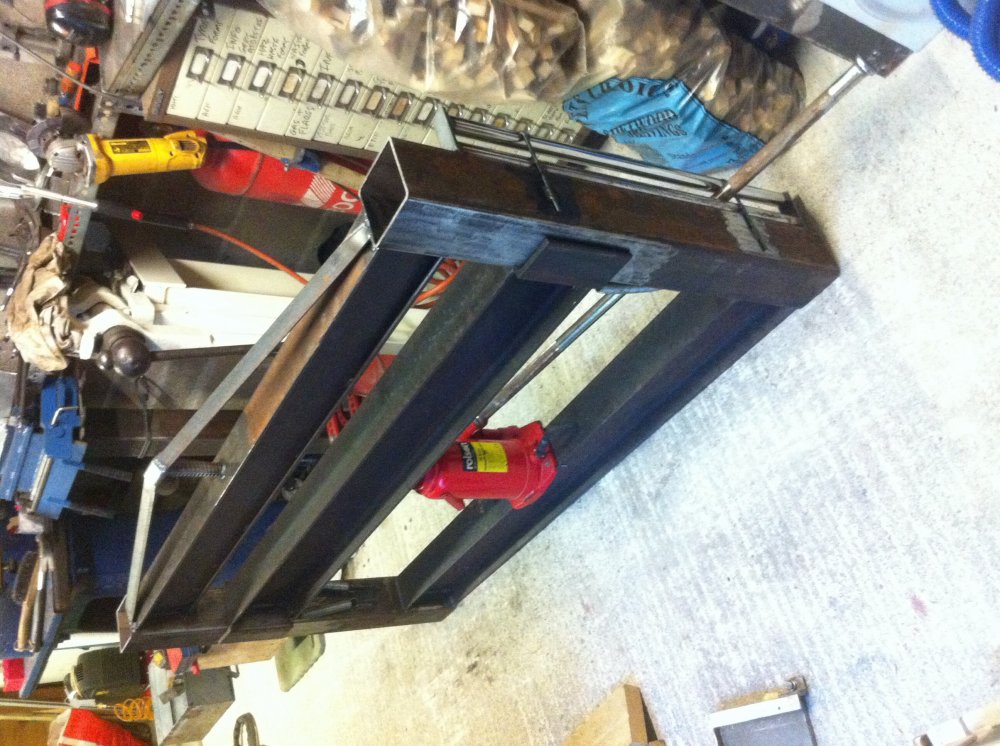

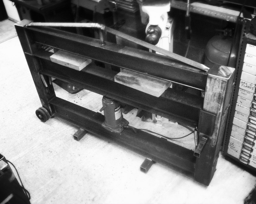

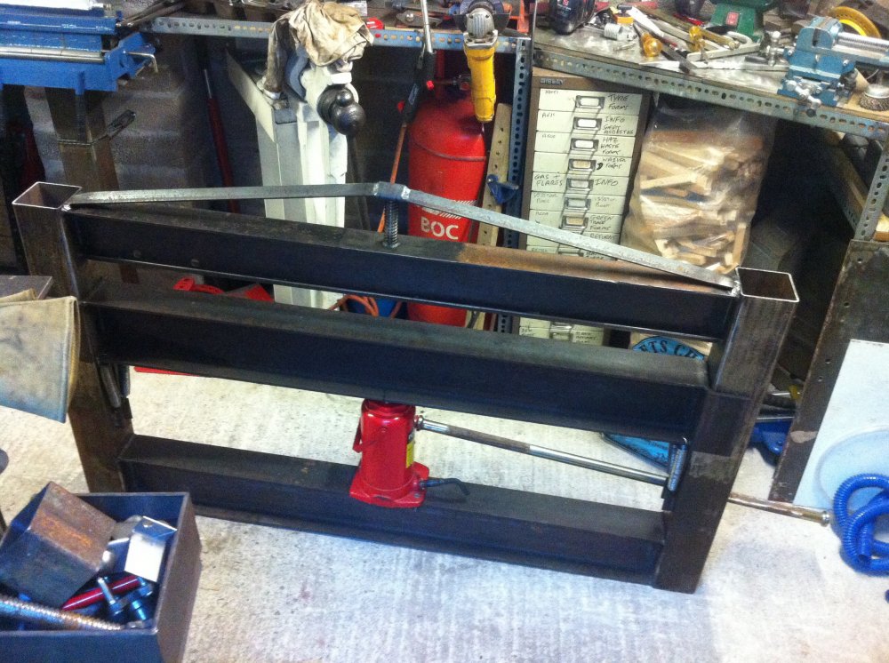

Ok, so this is a work in progress.
I have for over a year been planning to build this project and yesterday finally got round to starting it.

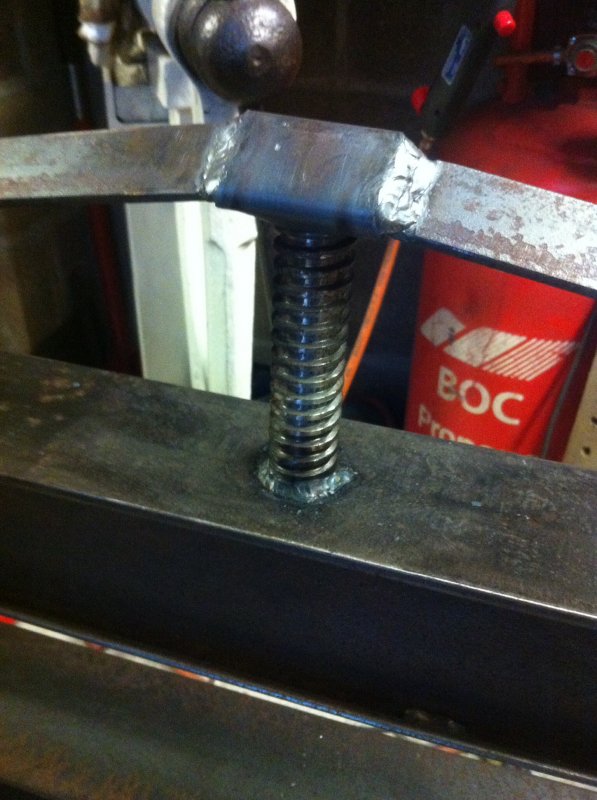

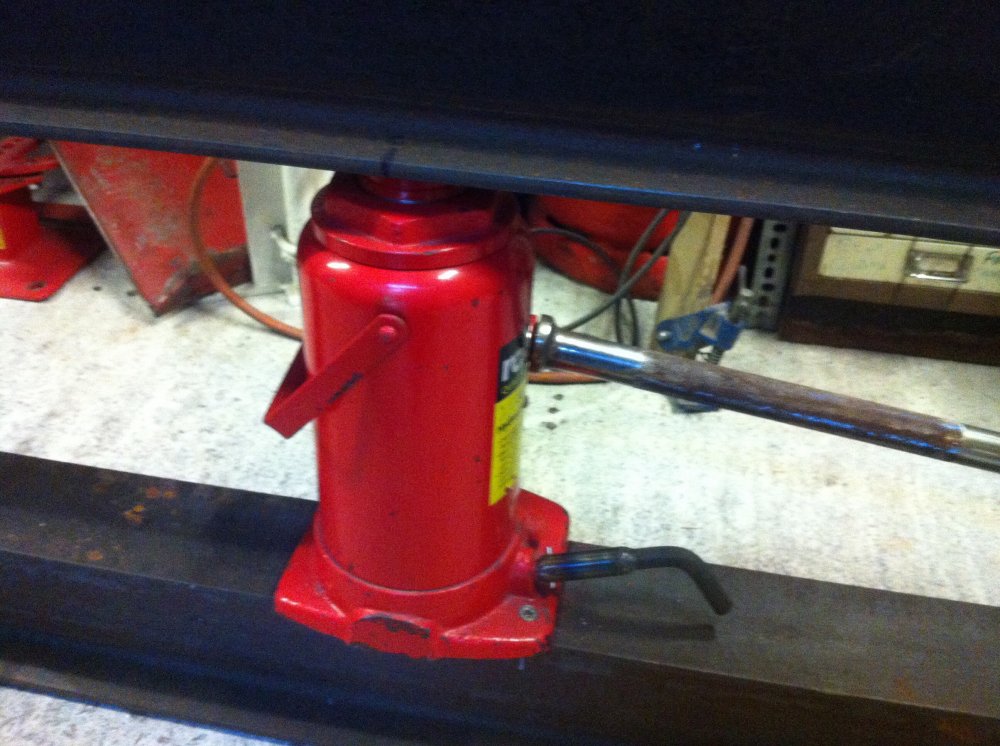

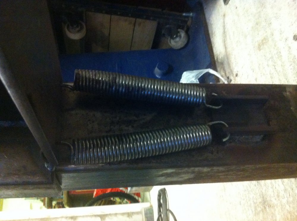

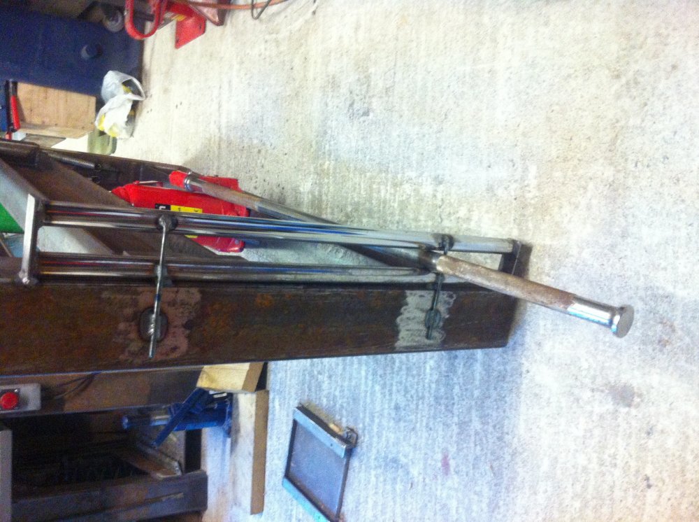

Fundamentally this is similar to the smaller 30 ton metal press/punch I made several years ago and posted on here. However this is purely for metal bending and has a fixed bending die at the top which is welded to the sides. The central 30 ton bottle jack is balanced by 4 washing machine drum stabilisation springs at either side. There is a long boom arm that operates the jack so it can be operated when there is a large sheet of metal in the bender.

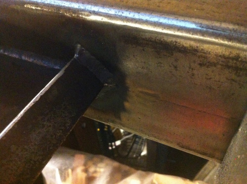

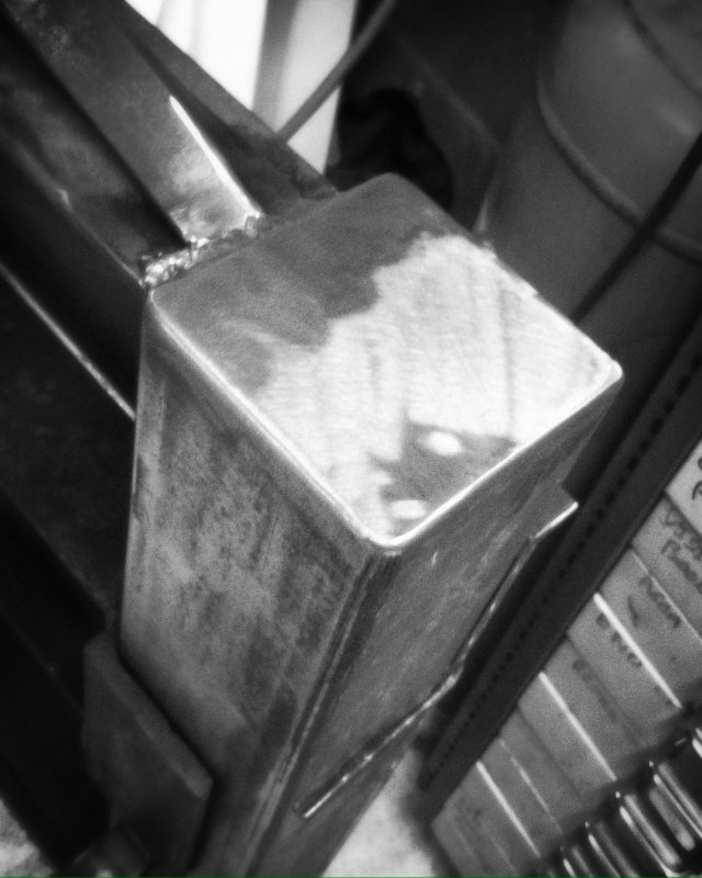

The RSJ's are 6"x4" and the top one has been cut chamfered and has a 25x5mm angle iron welded to the chamfered edge. The sides are 100x100x4mm box.

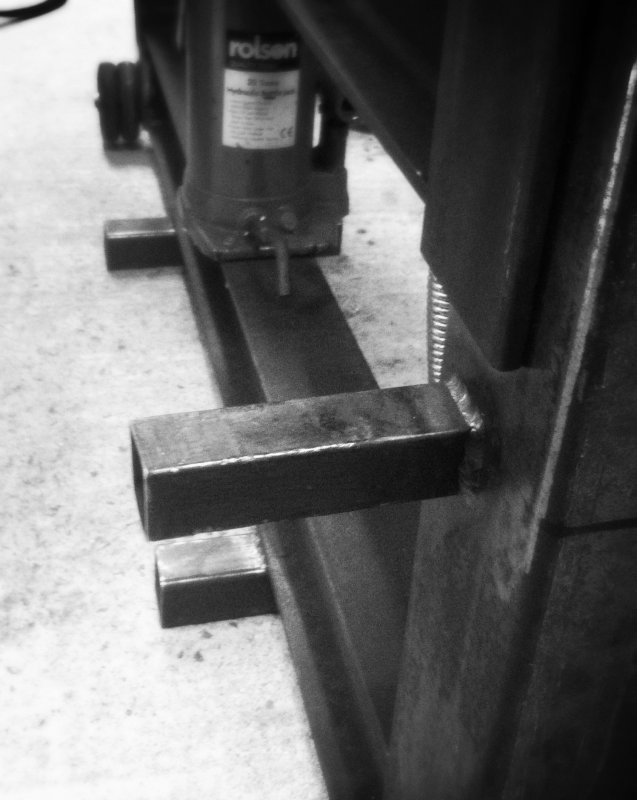

I still have to weld two pieces of upside down angle to the moving RSJ and it need some feet and wheels as it weighs nearly 200 - 300 pounds.
More piccies to follow when it's finished.
