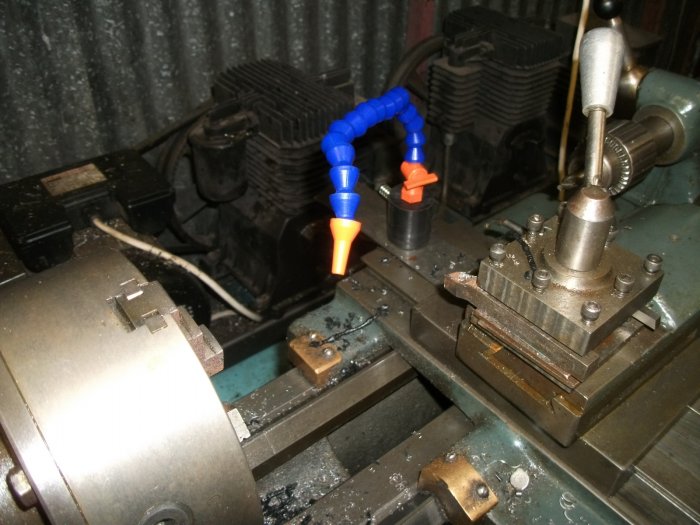

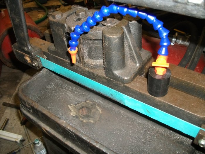

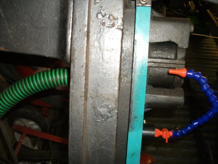

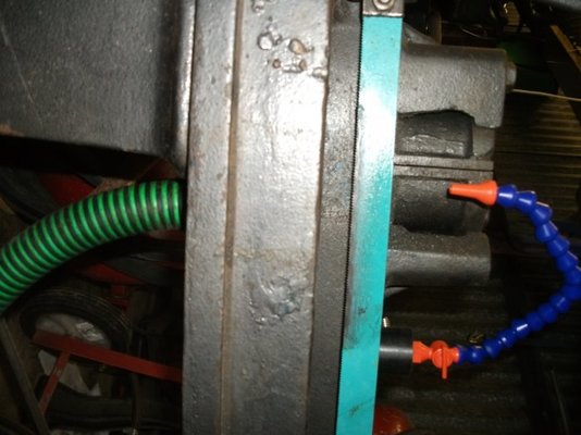

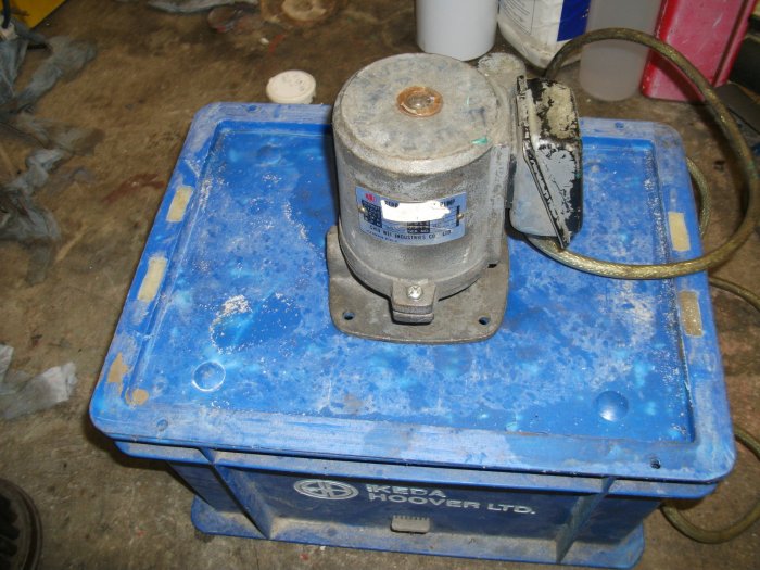

i picked a pump up at autojumble for £15.00 and a flexible hose and feed tap of ebay a fiver. the tank is made of 2 storage bins one with the base cut out for the lid . using a piece of nylon i drilled and threaded it 1/4 bsp and a couple of holes in the bottom and fitted a few magnets in the base . it can be used portable on any machine using the mag base. the one for my saw ive drilled a hole in the base and pressed in a 1 inch sleeve and fitted a plastic hose to go in to a bucket. after use the white water can be cleaned and filtered and returned to the tank
