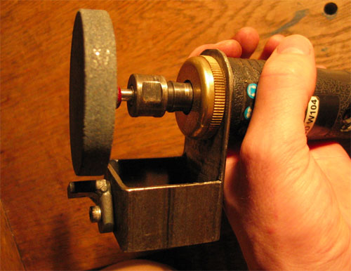

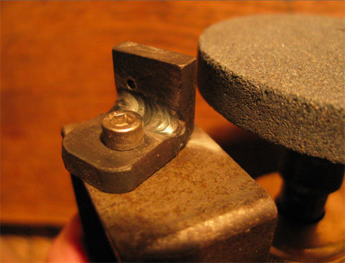

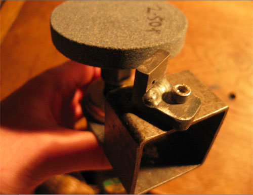

hey all,
came up with an idea for a tungsten grinder, take a look
easy to make and works, think i'll refine it more in the future, the hole is a little big 2.5mm could do with a 3/32" and some extra holes for other size tungstens, anyway it works
