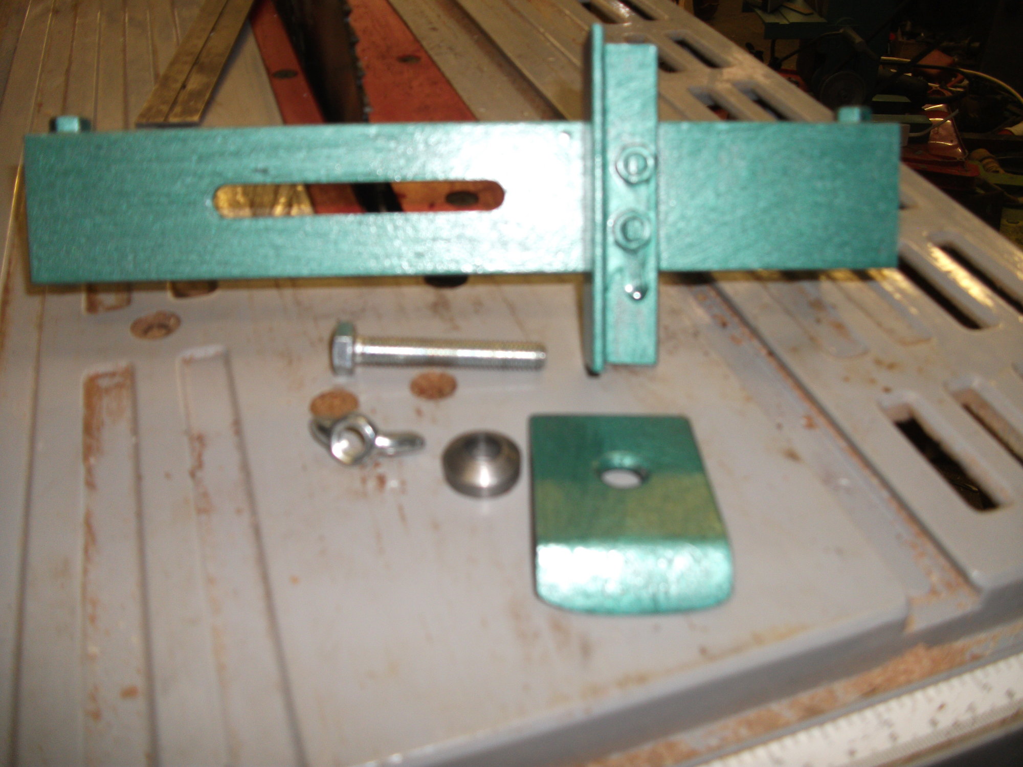

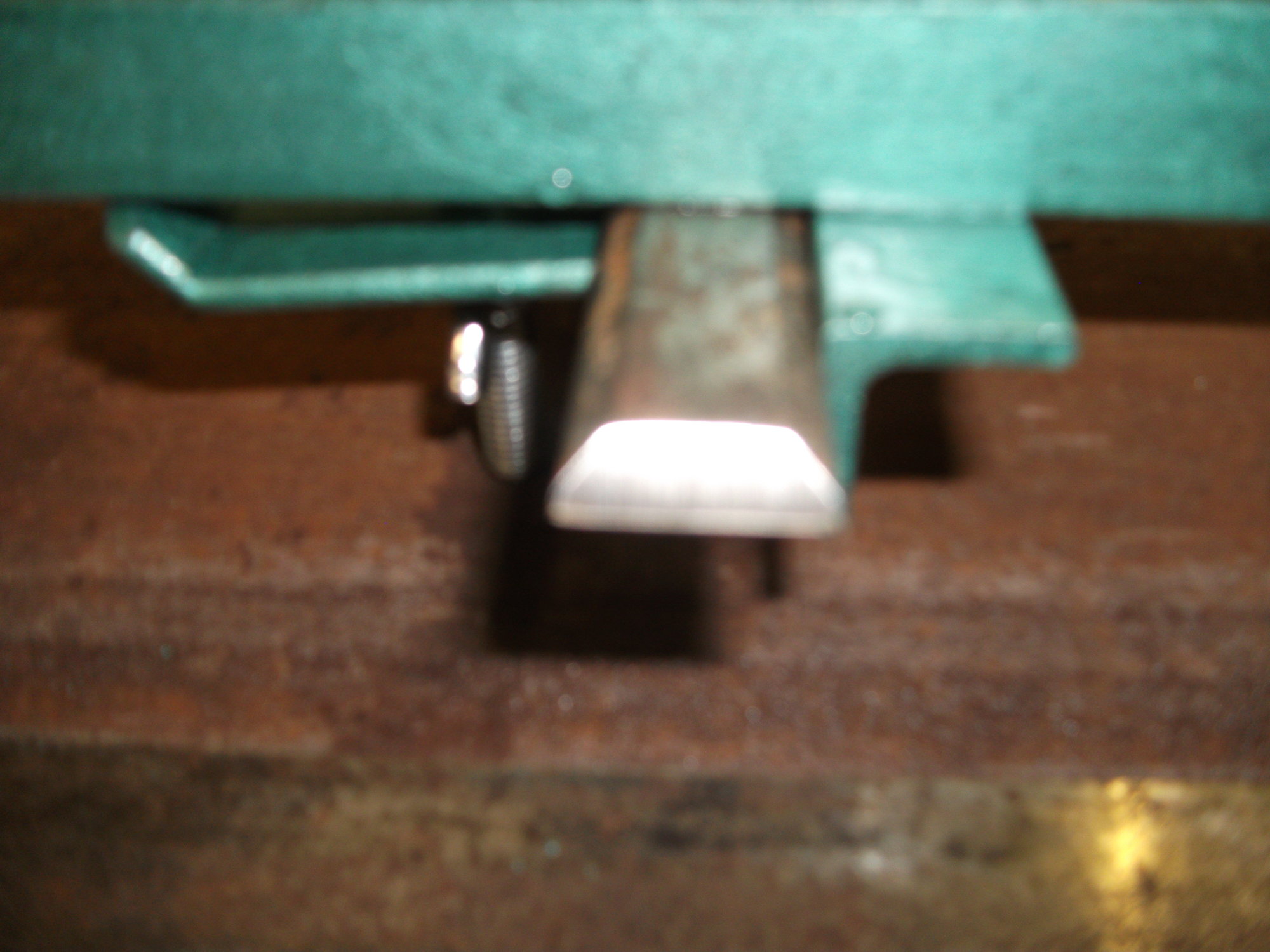

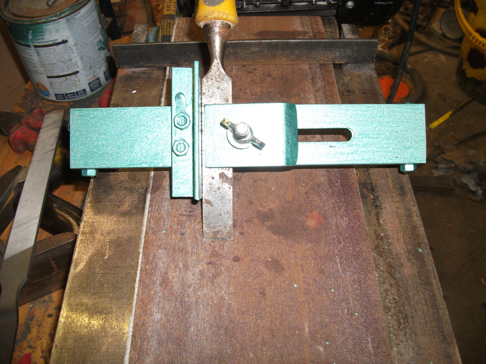

got fed up of grinding them by hand on the grinder so now do them on the belt sander with a jig I knocked up its simple fast and accurate . a bit of milling done for the slot a few bits of angle bolted together a rounded washer made in lathe for the tilting clamp as the chisels are tapered down there length and not flat. the chisels are set and clamped to 32 degrees and the jig just sits over the belt sander and rocked over to cut the blade and easy removed to look at the finish
