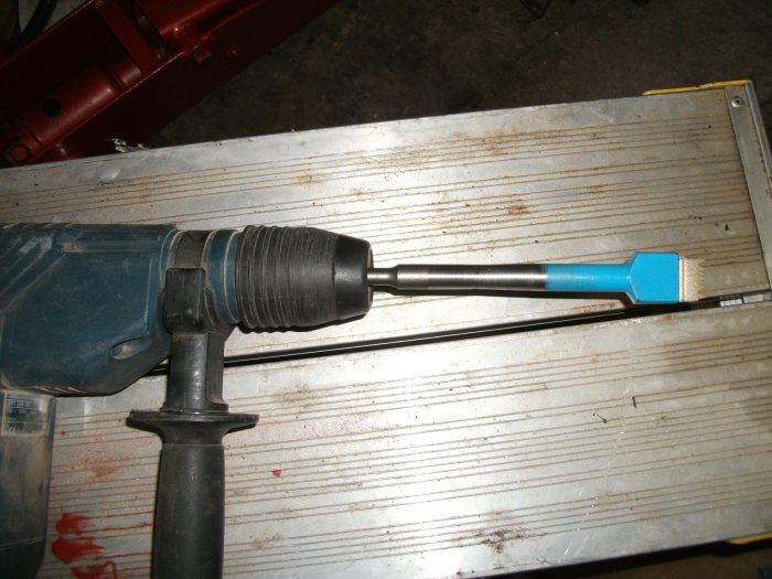

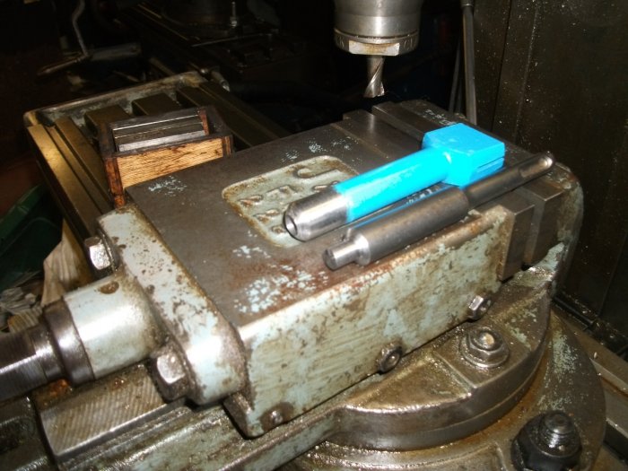

i priced an sds chissel up£30,00
i happened on a hand held one at autojumble £2.00 and had an old sds chissel spare i cut the pair in half ,bored one side out and turned a spigot on the other tapered them off and welded up a quick go on the grinder and it works fine
mainly speed and less damage
