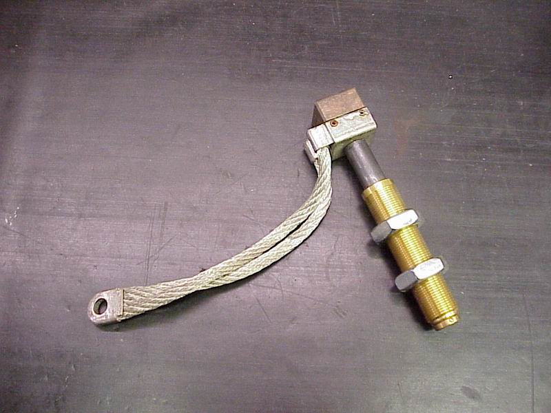

This is the earth pick up, this is one area that needs work, as you can see from the other pictures, it's arcing and cuasing the aluminium discs to become pitted. All the joints and bolts are either rubber mounted or use plastic washers, so the earth can only track through the copper parts.

. Is the brass barrel insulated from the copper wear pad?
