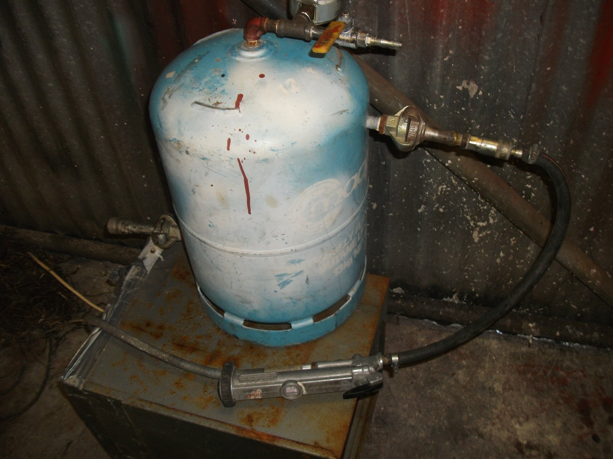

wondered what you other diy'ers do to try and keep water /moisture out of the airline when painting at home?
links /pictures please
was hoping for something smaller scale /budget thats mobile
i just have a mini compressor and gun that i drag around as need be
You only need a water filter, not the lubricator.
but that thingy on the wall or dragged around with me would do the job ? maybe a micro filter on the gun?
apologys for the questions, ive worked in bodyshops all my life and used their gear , never really paid any attention to what home users do , i dont repaint whole cars just the odd wheel or bumper corner etc really
I use an HVLP system i.e. a mlti stage turbine with no air receiver
