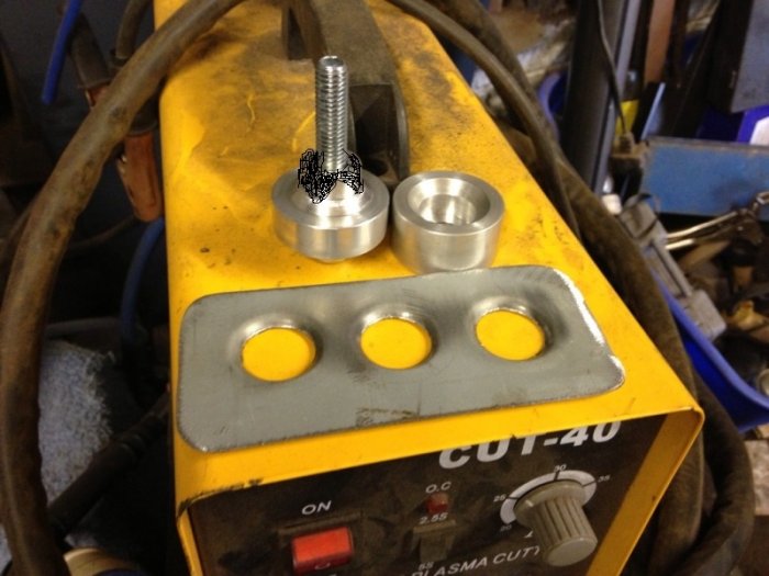

Got a few new bits today, started looking after seeing the Rally Mk2 Escort in the projects threads. Got 20mm and 25mm Hole swagers. Basically it you have to drill a hole and want it to look a little less plain and boring as well as putting a little strength back in, you insert the appropriate sized swager and wind up the high tensile bolt until the tool has closed up and the centre of the hole has an extrusion along it's edge. I tried it with a piece of 1.0mm zintec and even before folding the edges the difference in strength of the flat panel was considerably stiffer. Cost me £17 each plus post from this guy but it looks like his price has been increased by £3. It will do 1.2mm steel and 2mm aluminium.
