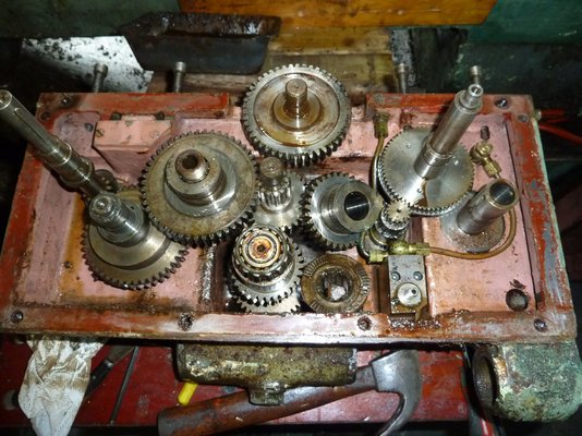

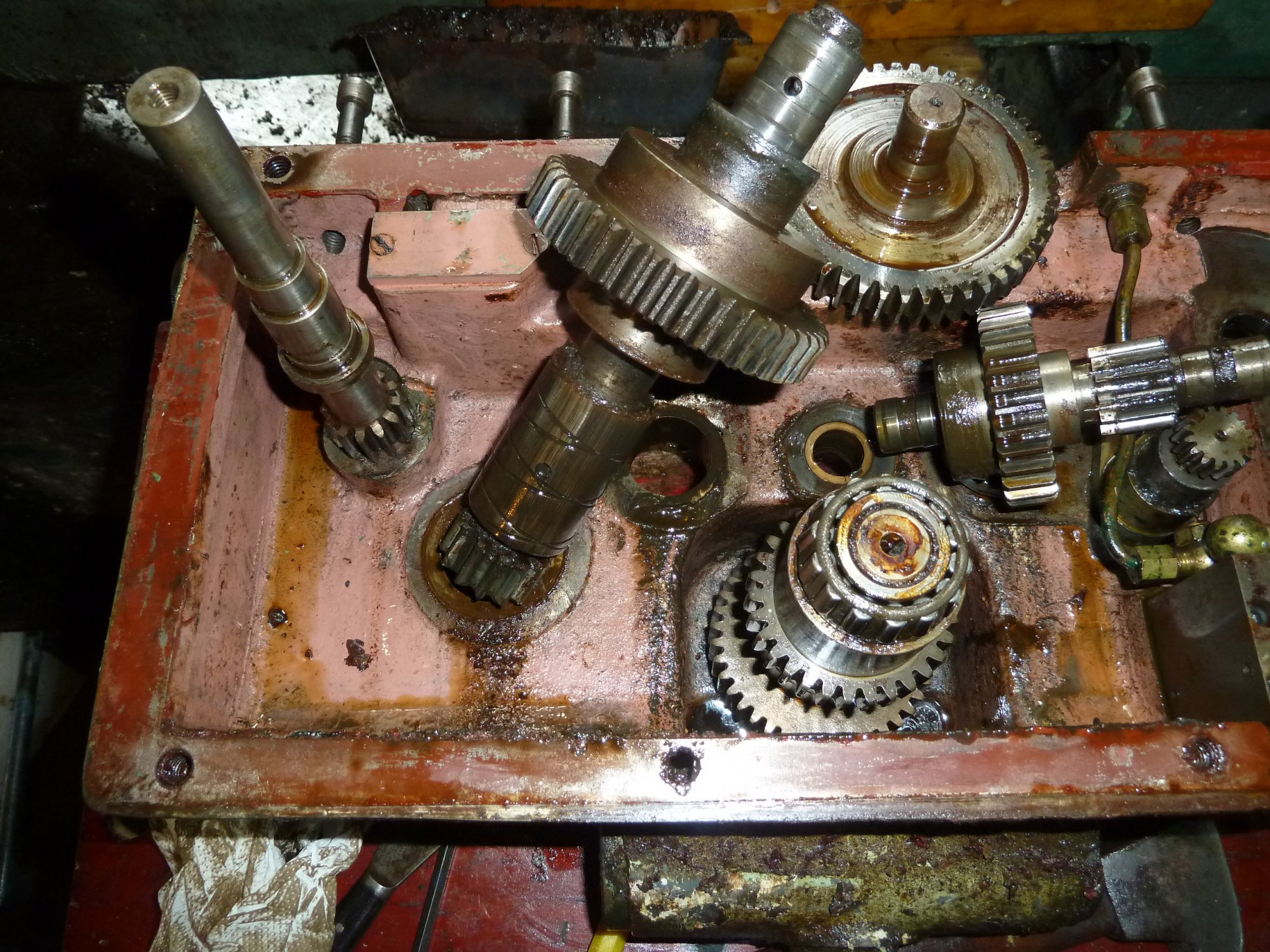

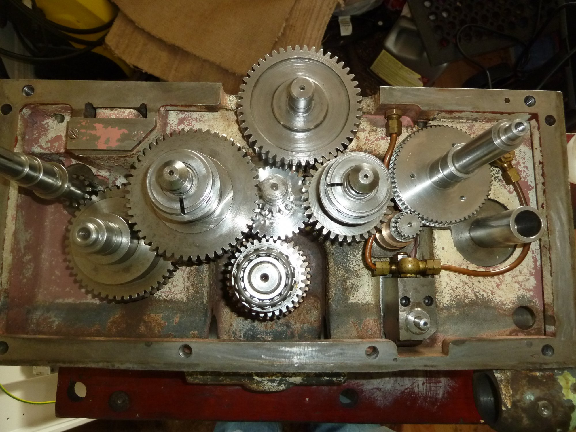

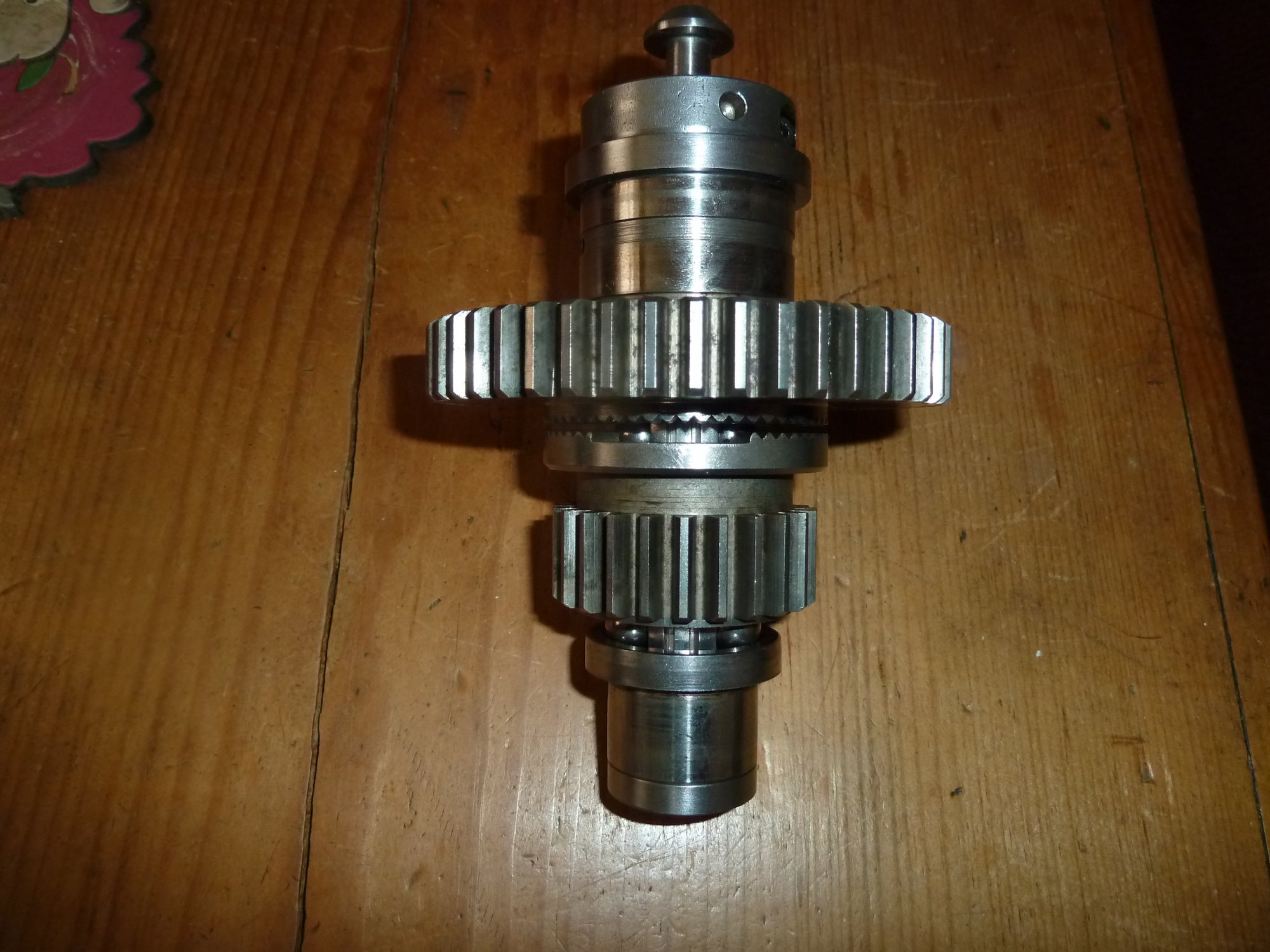

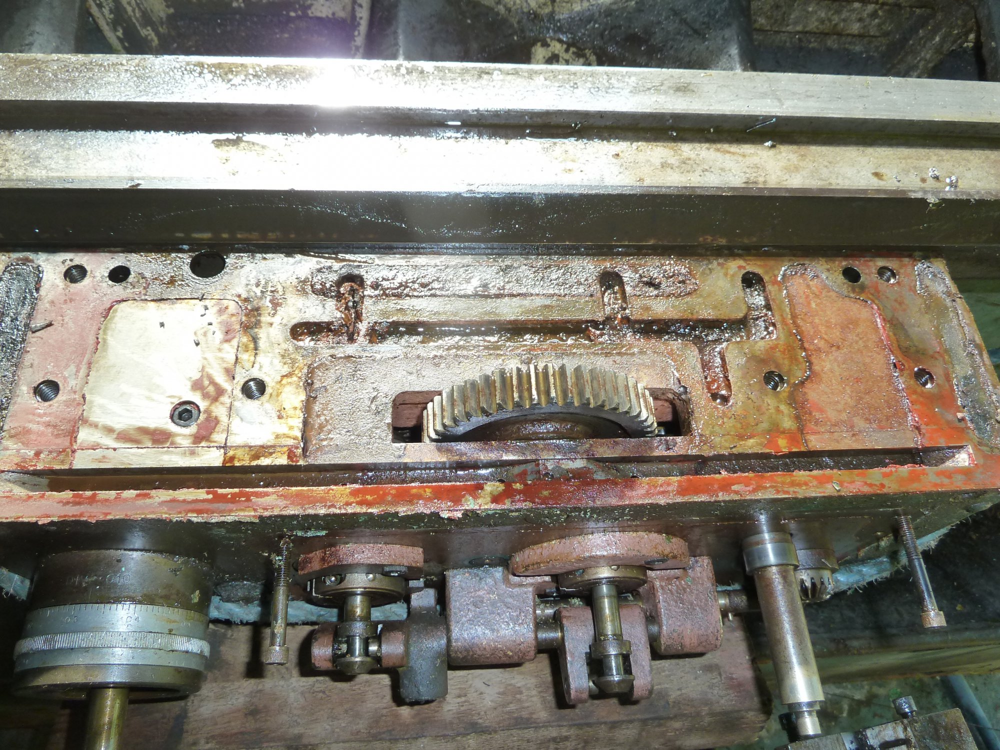

Some of you might have seen the arrival of my lathe in the show us your lathe section.
This is a quick update concerning the apron, the pics say it all really except to say, please don`t put grease in places that are meant for oil.

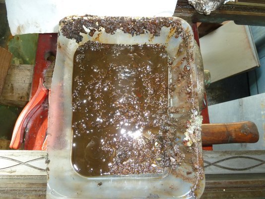

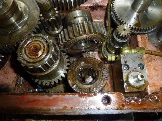

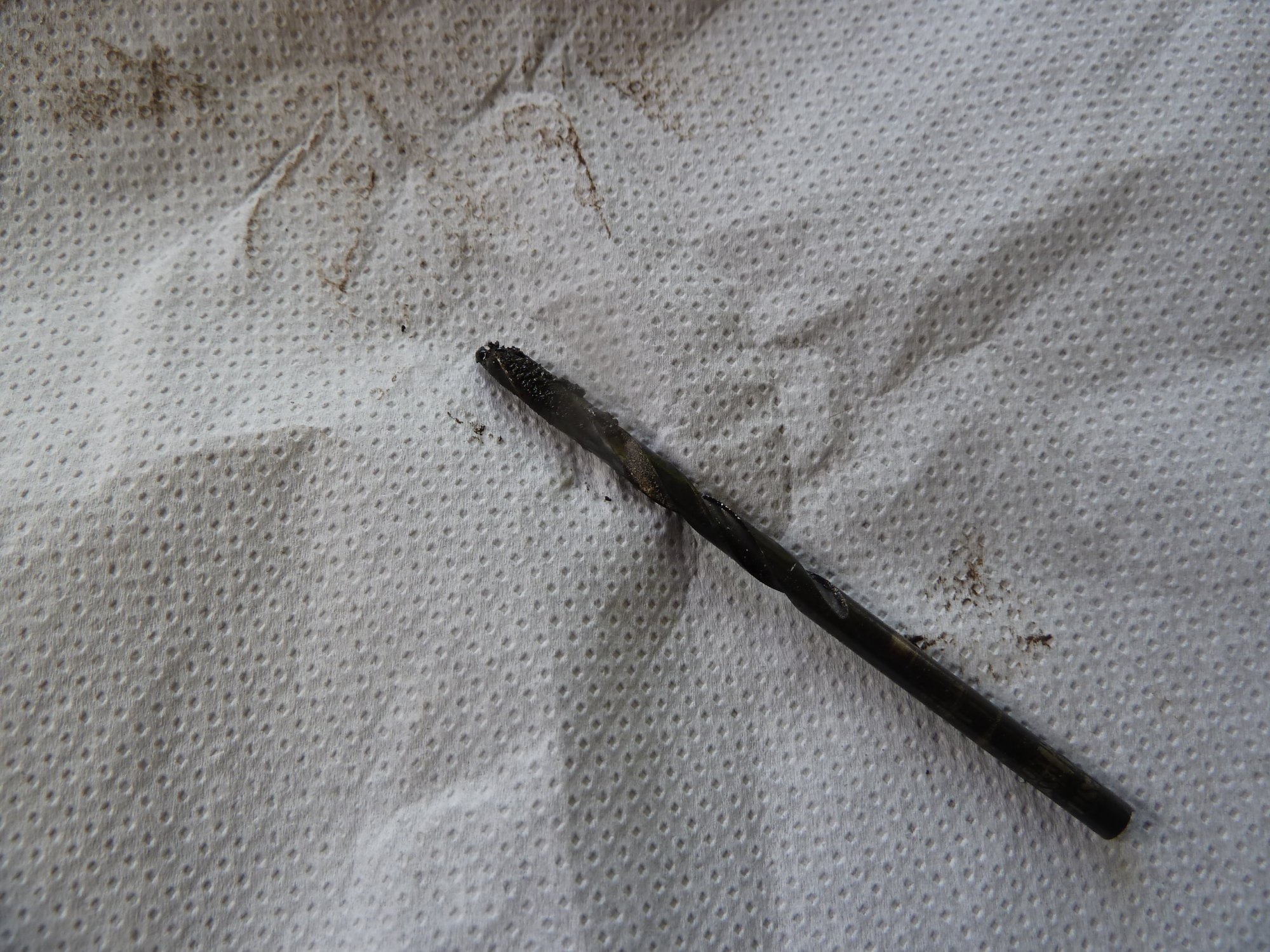

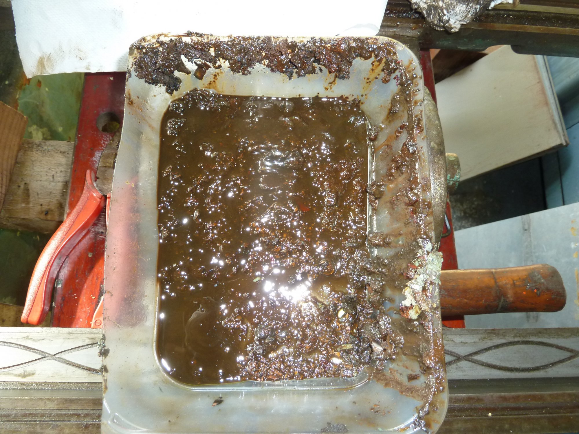

The crud in the tray is a mixture of old cutting fluid, dirt/grit, oil and grease. Now if anybody needs some grinding paste, what is in the tray would suffice. The oil ways were blocked as shown by the drill bit.
Enjoy, and again leave the grease in it`s tub please.
