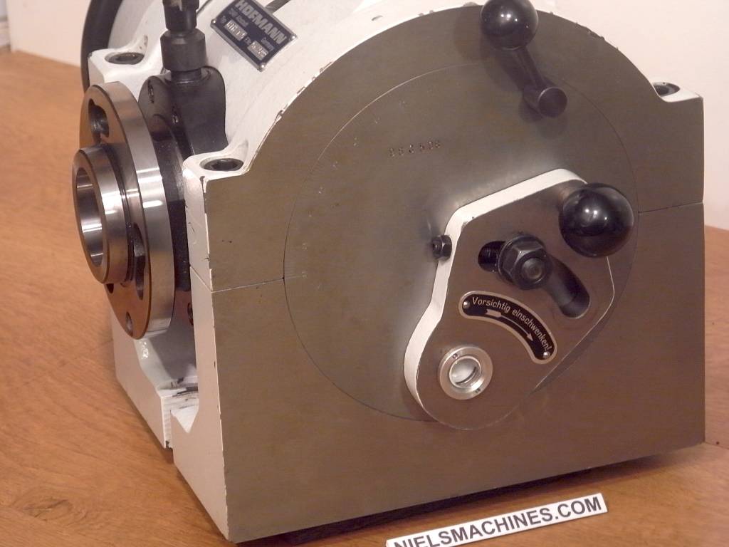

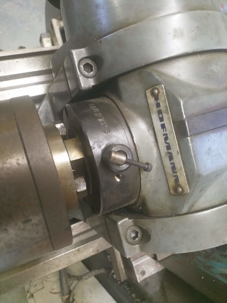

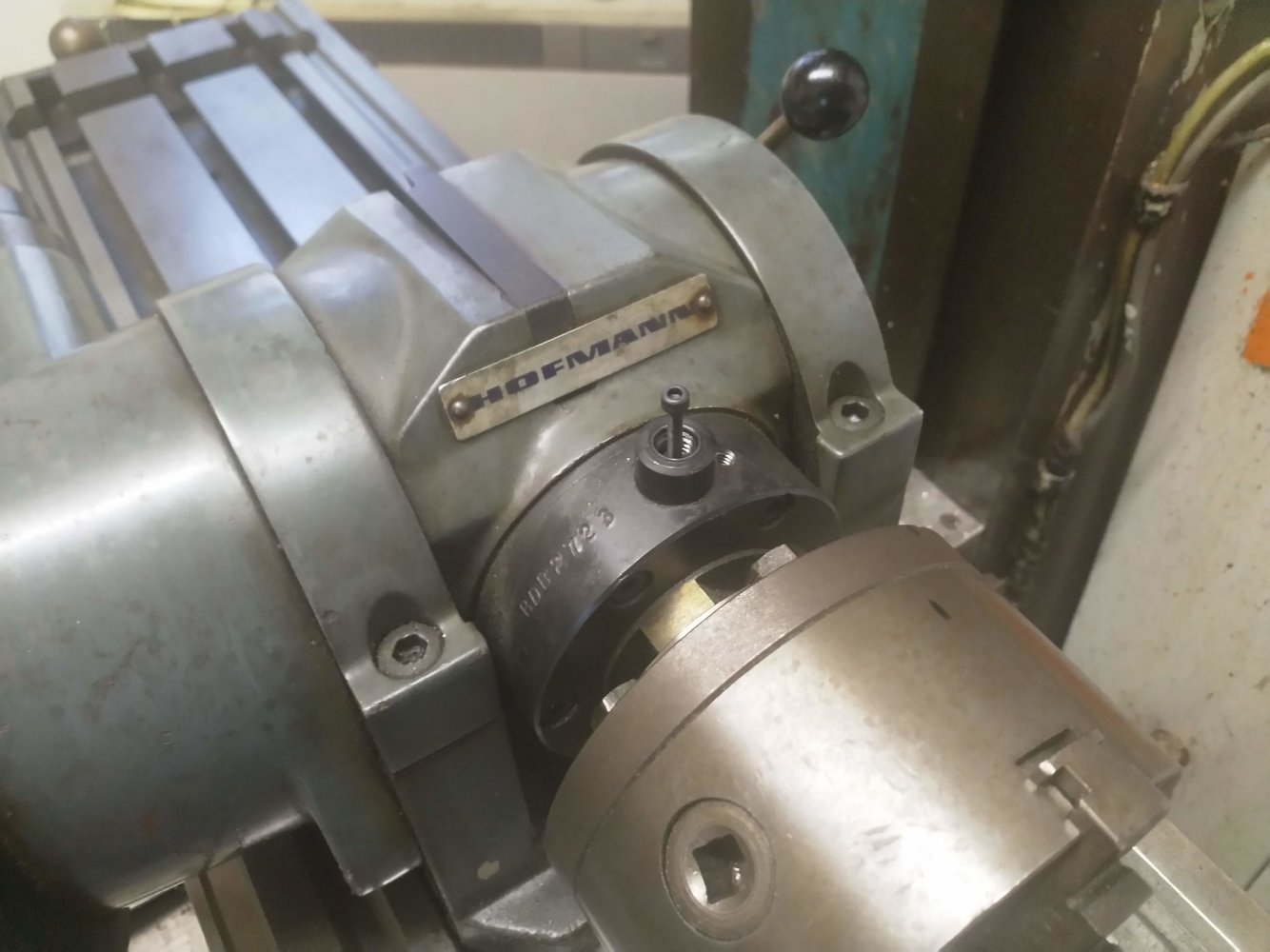

I just downloaded a pdf for the Hofmann UTH series from https://www.machinemanuals.co.uk/manual.php?p=100 it cost 9.95 GBP but is a pretty good clean scan.I recently purchased a hofmann dividing head. Does anyone have the manual they would be willing to share? I tried to contact hofmann multiple times but never received any reply.
