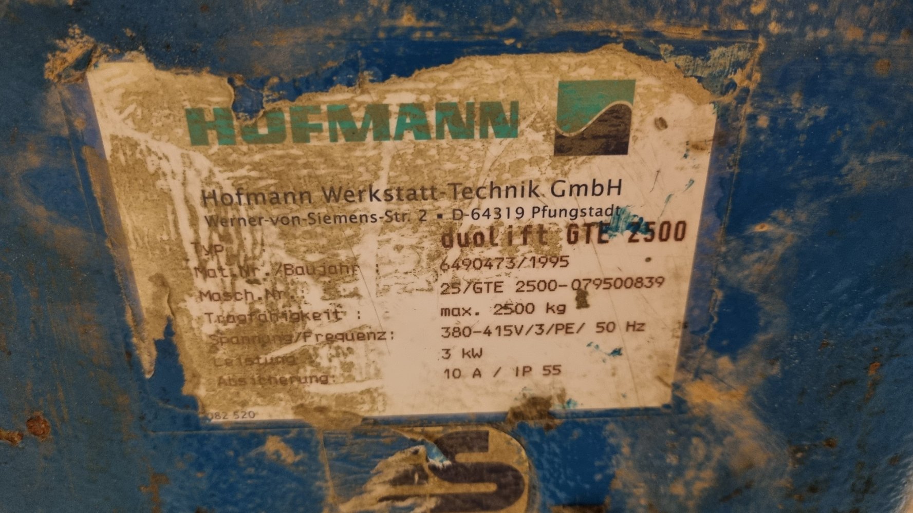

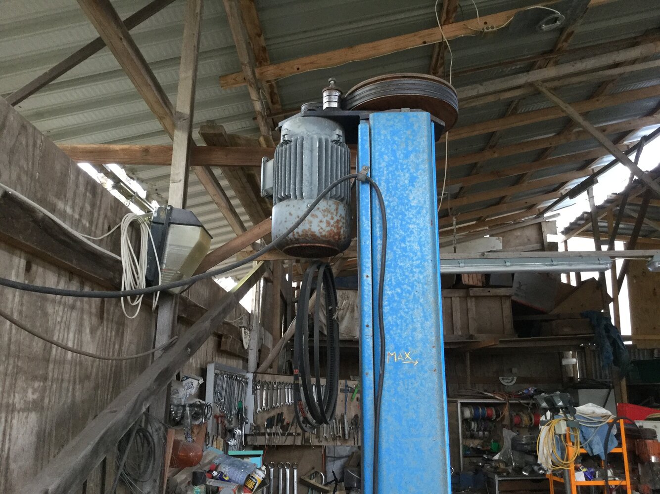

Hi. Im looking for some help with setting up the correct parameters on a vfd to operate a hoffman gte2500 duolift.
With no load on the lift it operates no issues,motor sounds strong. Vfd doesn't trip.
Once there is a car in the lift as soon as its taking any weight it starts to struggle.
Things to note. We installed the lift 3 weeks ago,using a vfd to power the 3phase motor.
the lift was operating and has lifted cars.
last week it was struggling to lift a heavier car,around 1600kgs so we'll within the limits of the lift.

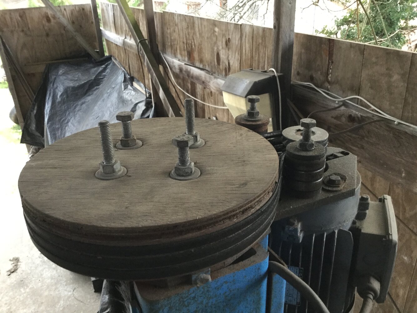

At this point there was a pop at the motor and the electric tripped.
That pop fried invertor number one.
we founs the cables into the motor melted.(in hindsight the cables were old and potentially worn,damaged as its been dragged around and in storage for some years.we should of rewired to start with but unfortunately overlooked it so here we are) most probably the settings on the vfd were not correct which may of caused damage too.

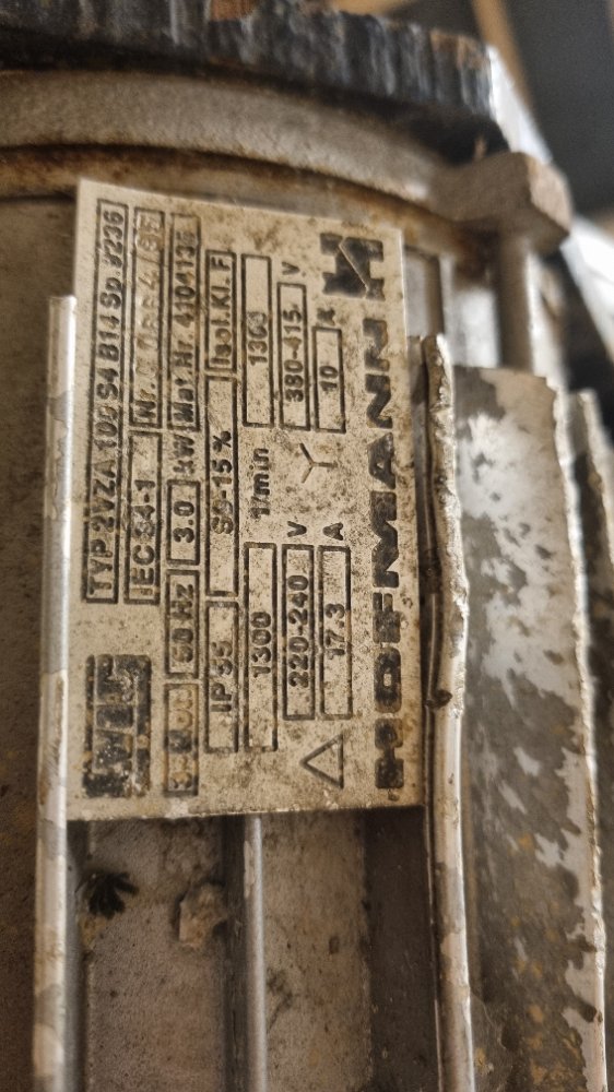

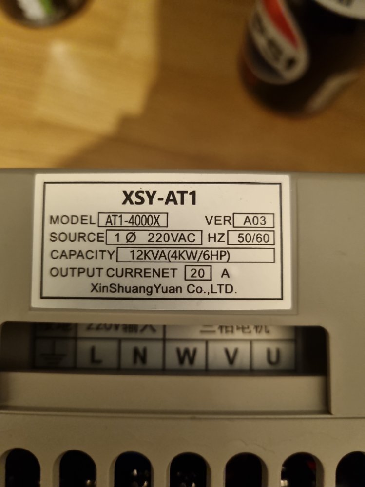

New vfd is here,fitted and motor rewired from switch( motor tested with multimeter and all coils ok )
Ive searched the Internet for days and found some settings fornthe vfd,however im finding conflicting results depending on where I look on Google and with AI.
Ive set the suggested parameters that I found to match the motors plate information. The lift operates great until its underload then its useless.
Im looking for help to set the parameters to give the power/torque to safely lift the cars without causing damage to the motor or the vfd.
The motor is wired un delta as per the vfd manual instructions.
