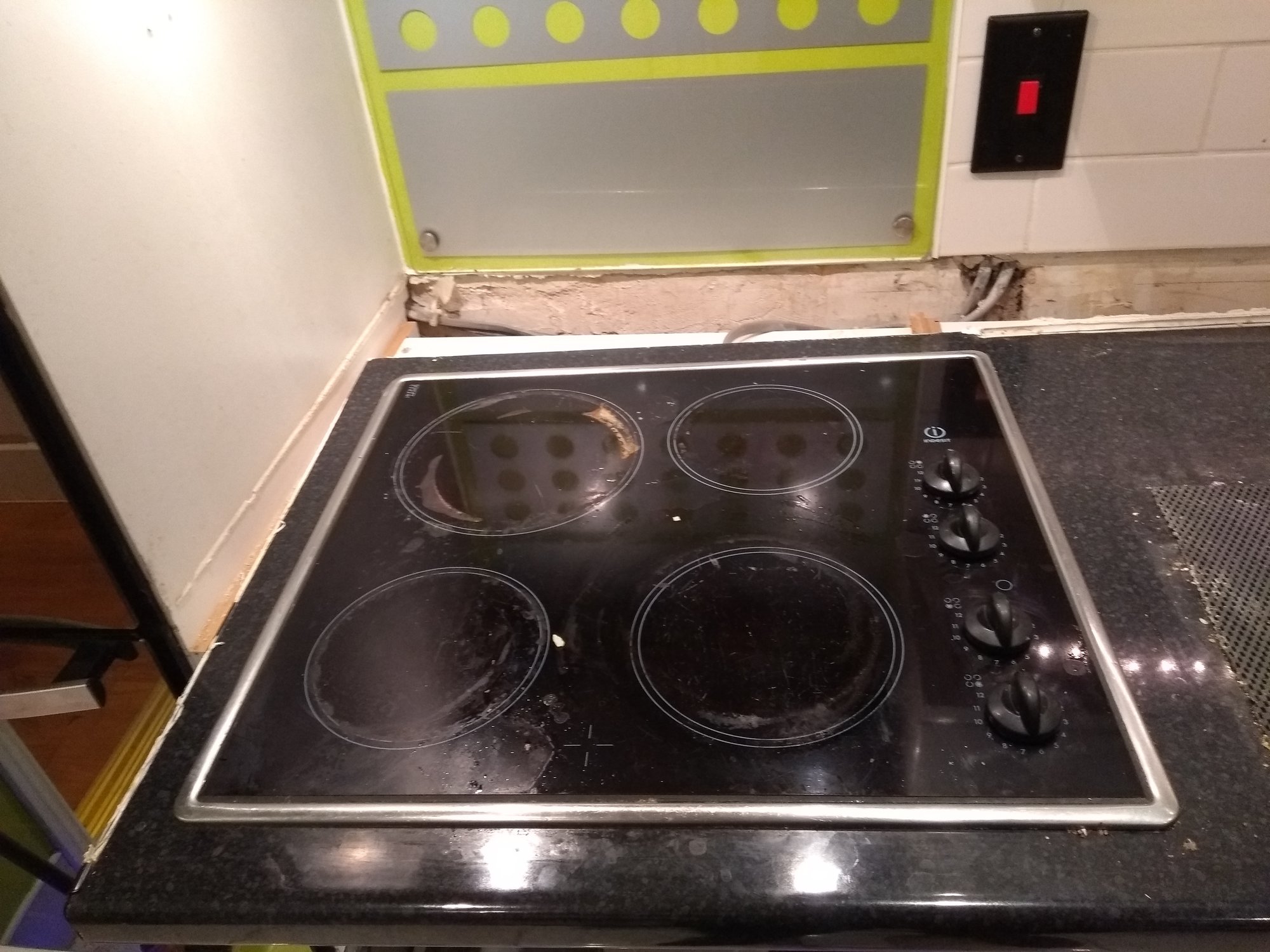

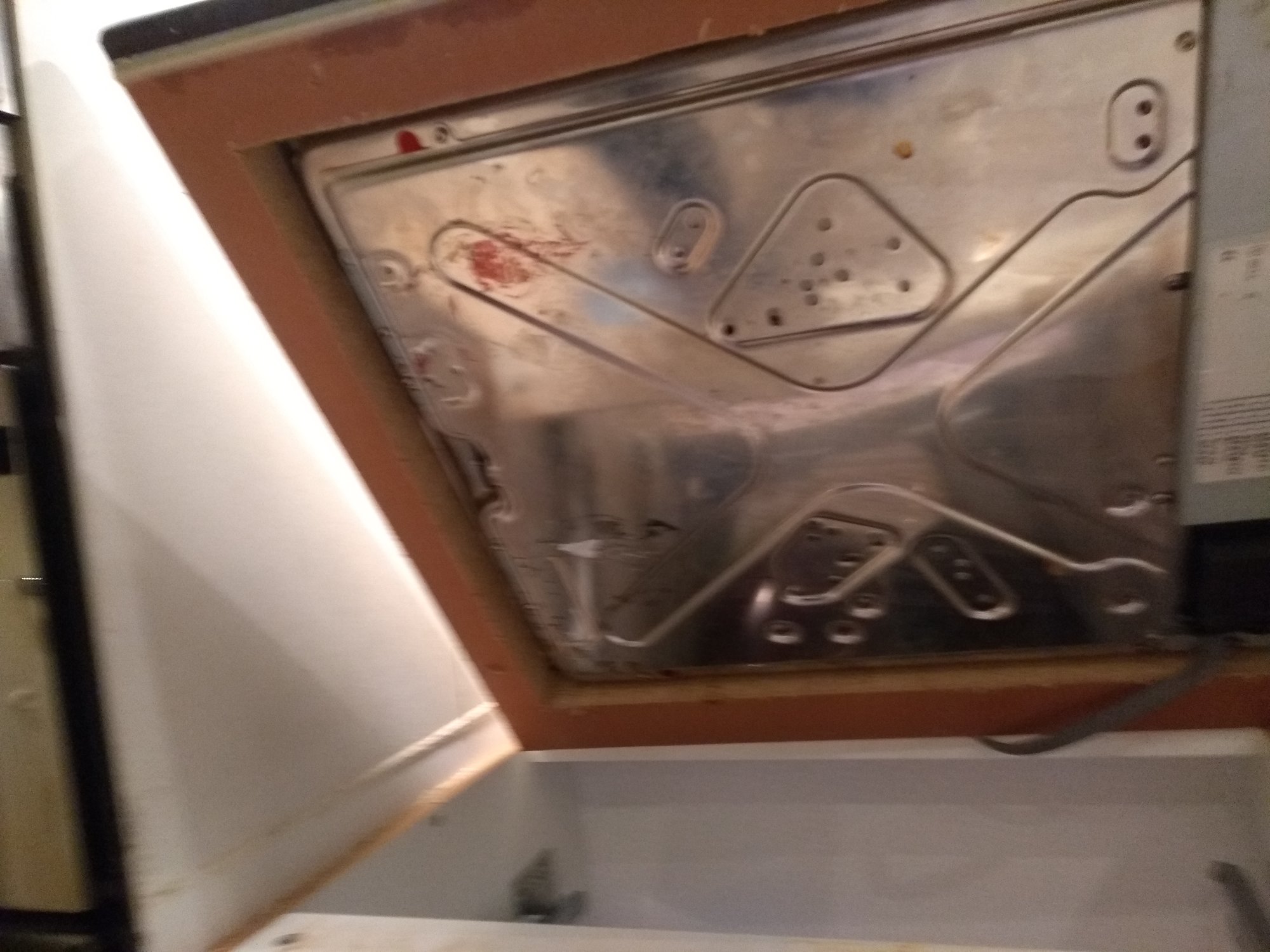

Yep, it's out now, stuck down with clear silicone.Clips don't seem to have been fitted. Have seen them with sticky backed strips around the rebate before. Run a thin flexible scraper around it and see it it frees up.
