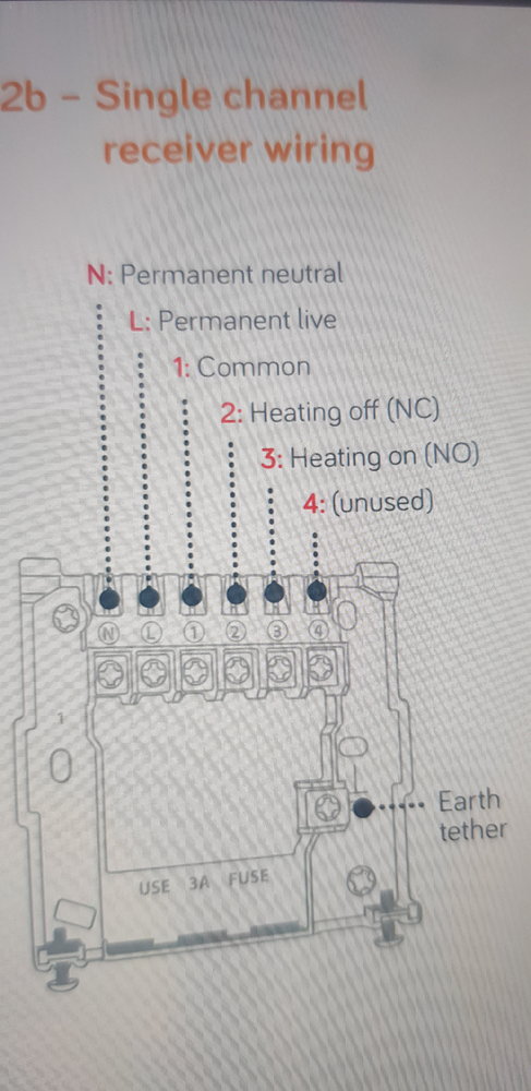

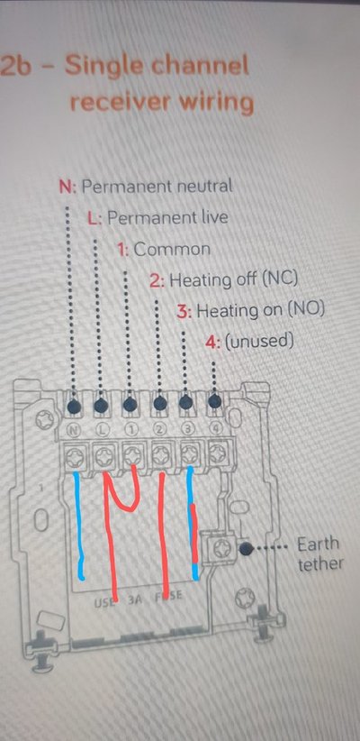

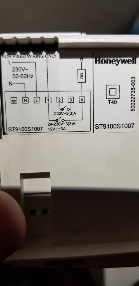

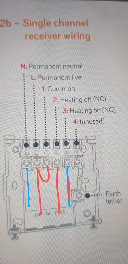

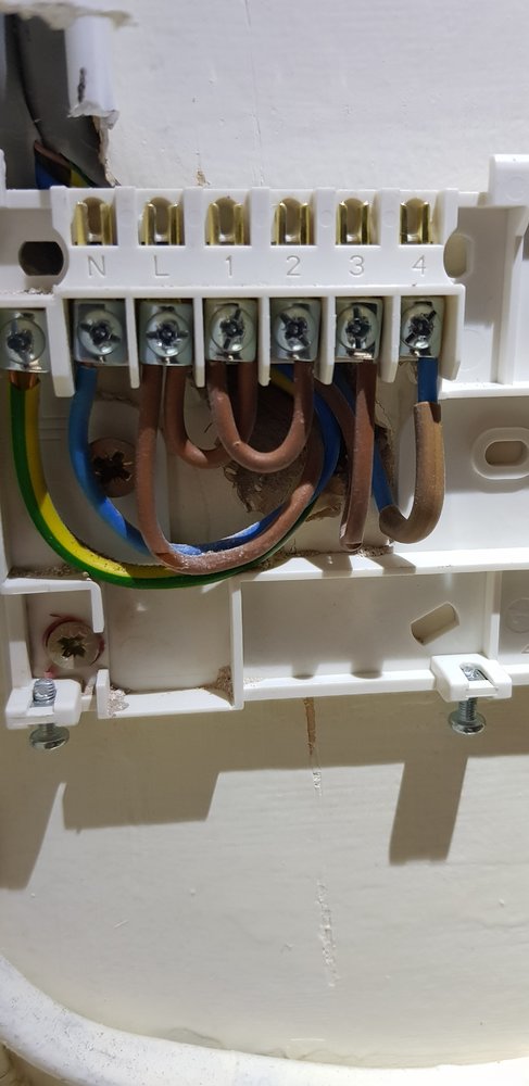

Hi All, I have a Honeywell st9100s heating control panel. I am looking to install a Hive receiver, I took the panel off and there are 2 wires looped. This is where it gets confusing. Can I do away with them?
N, L and earth are self explanatory. Slot 3 I have brown wire and slot 4 I have blue with brown sleeve.
Hive is a single receiver.
Basically what I am asking is do I need a loop and where do the wire on the right go.
Thank you in advance
Shaun
