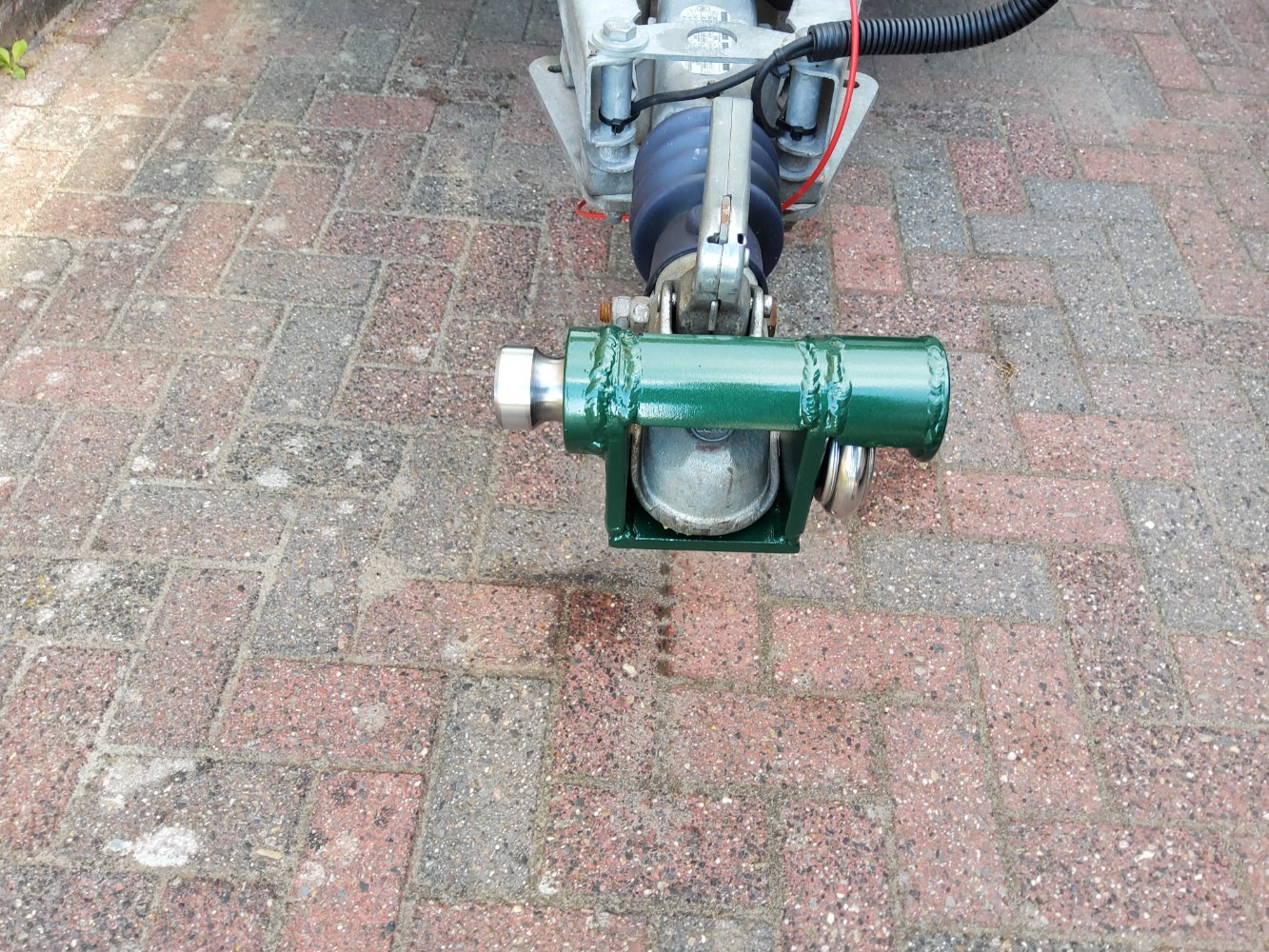

Got myself a bit bigger trailer two weeks ago.

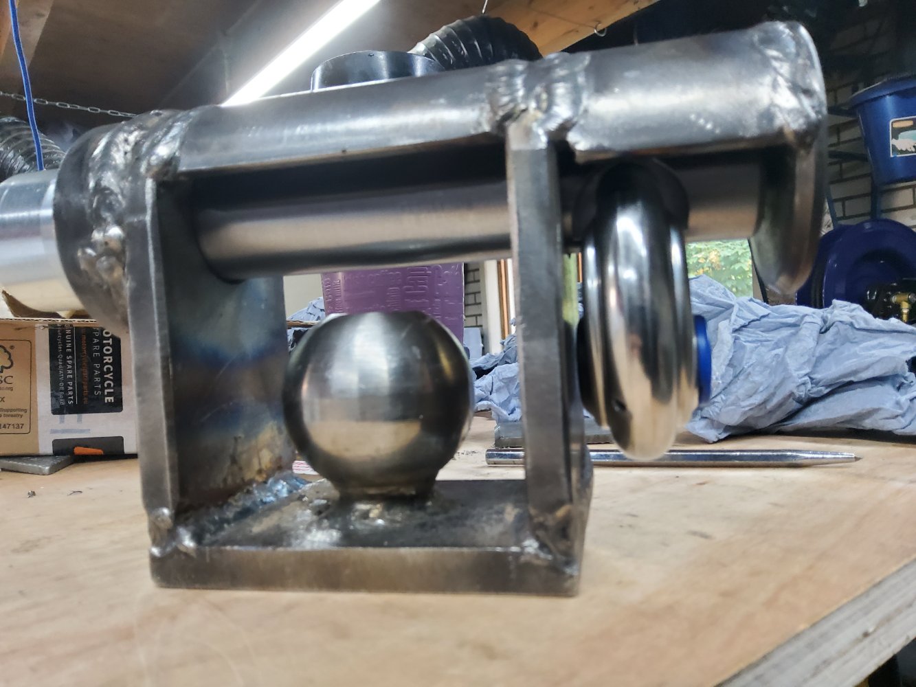

I could have bought a hitch lock, but where's the fun in that? So I made one.

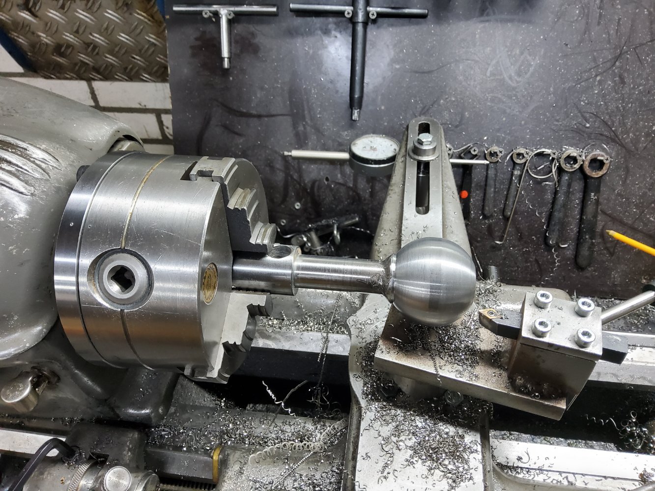

Turned a 50mm ball with the crude ball turner I made a long time ago.

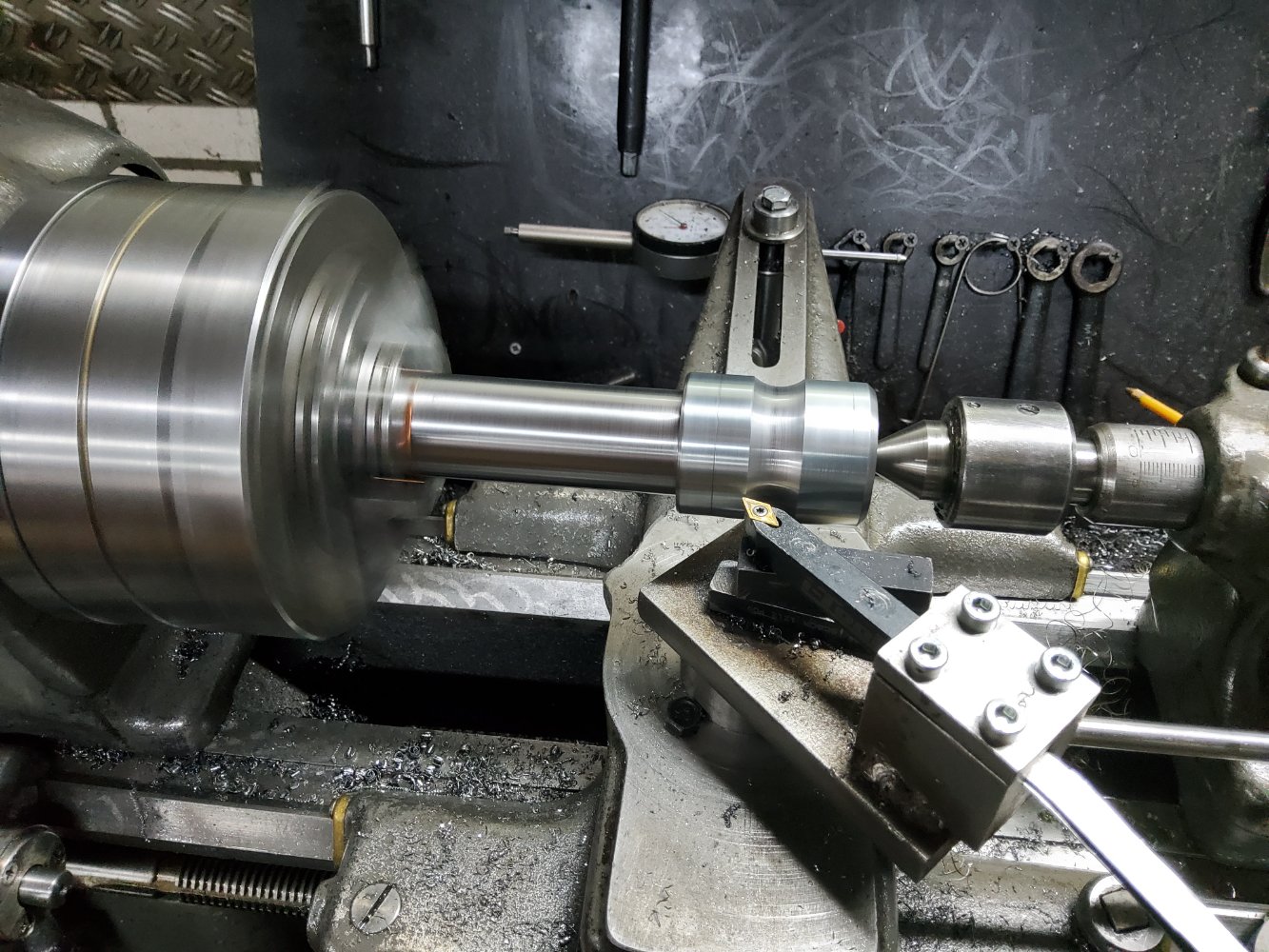

Turned a 30mm pin.

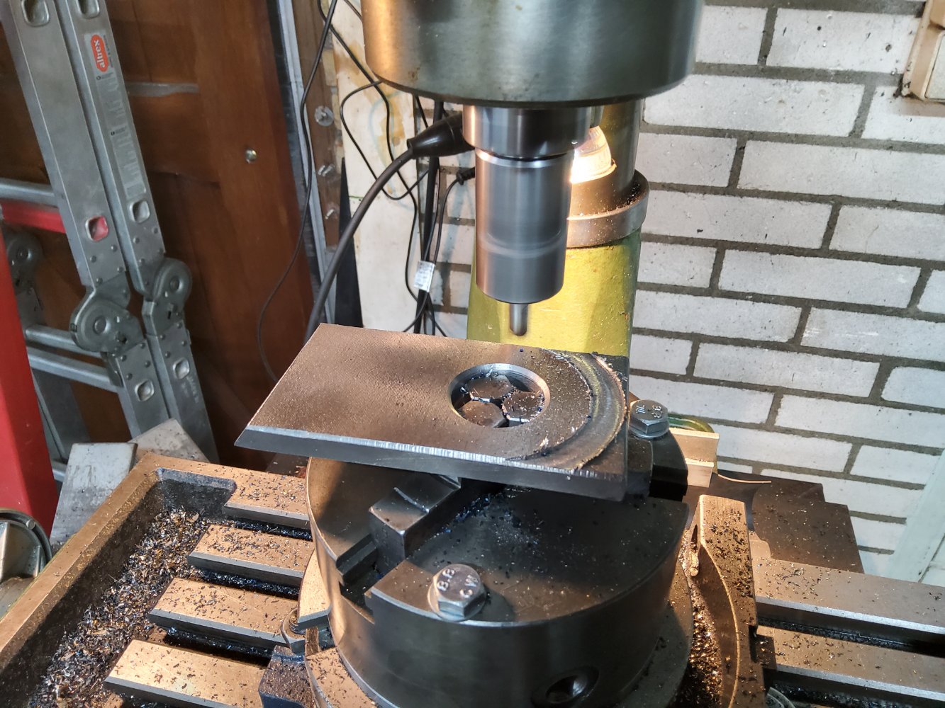

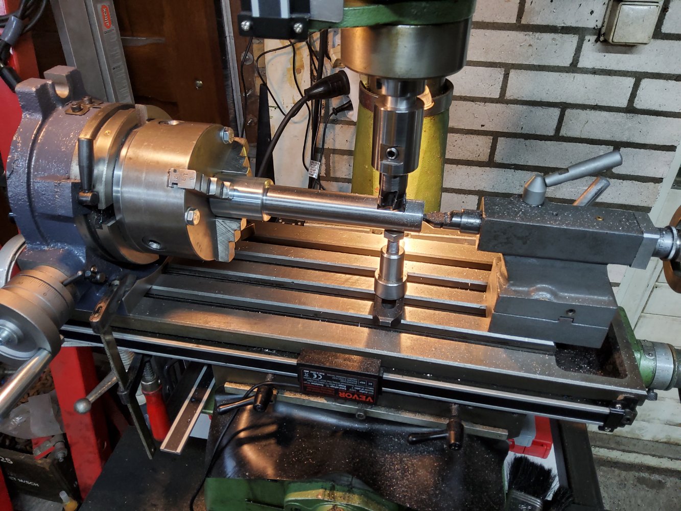

Milled a recess for the disc lock.

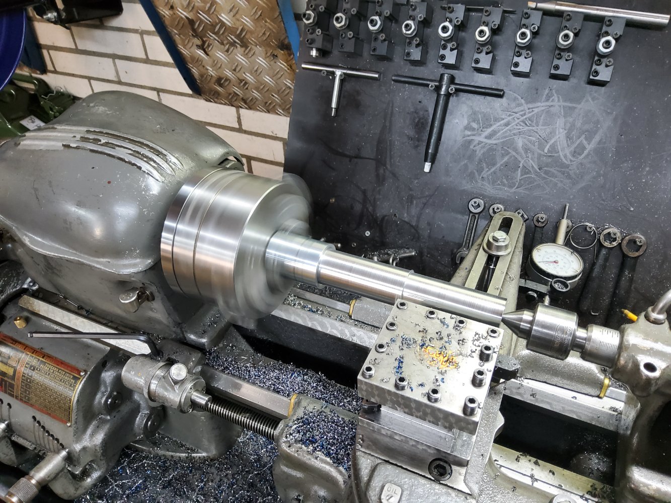

Turned a concave bit on the other end for looks and hand grip. I thought about knurling it as well, but haven't decided yet.
I had to support the tool because of the stick out. Didn't realy think about doing concave stuff when throwing this simple ball turner together.

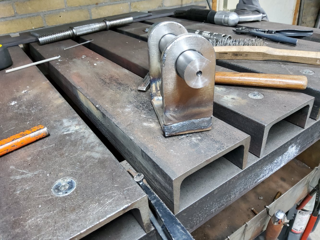

Side plates.
Covered the top with some 60mm dom tubing so they can't get to the pin and lock directly with a grinder.
Did I overdo it a bit?
Turned a 30mm pin.
Side plates.
