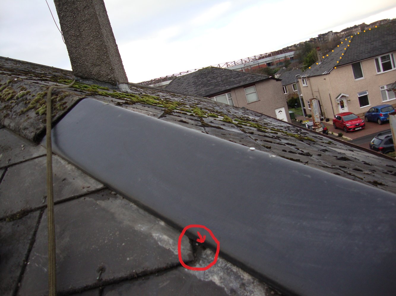

Working on a customer's roof today and find I need to replace a 1m long cement-fibre 'slate'
The tiles that go with these cost about £2 despite being very large (Marley/Eternit/Cedral Thrutone)
The ridges are about £70 each.
Anyway the one I took off has an angle or 120 degrees.
You go online and they are listed in angles from 20-60 so you think 'well mb my 120 is a 60 as 180-120 = 60'
There aren't any in stock anywhere online so phone some local roofing outlets who don't know what they are. Eventually find one further away who thinks they might have one lying around and helpfully goes to look for it and rings back but is confused about the angle as the only info on it is '35 - 84'.
Anyway I drive about 2 hours to get it and measuring it it's a bit sharper than mine: 110 degrees (or 70 if you do it the other way)
So to get to the point of this thread am thinking 'how can that be as they are only listed from 20 - 60 degrees' and then I remember when you are buying verge-caps they are marked LH or RH in relation to standing facing the front or rear of the property, not the gable-end that you will be putting the caps on.
So.... is it perhaps the case with these that you buy the one that matches the pitch of your roof, not the angle of the actual ridge-tile?
I guess if you can do it a more complex way by halving the angle of the ridge tile then subtracting that from 90. So my 120 tile would be 60 on one side and taking that away from 90 would make it a 30
NB on old clay tiles the angle is scratched into the tile (like 110 or 105)
900mm cement fibre hip/ridge tile has 110 degree angle but they only list 20 to 60
35-84?
