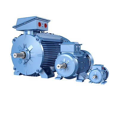

Lots of pondering later I've fitted the motor inside the machine with the fan direct mounted to motor
Problem is it's 60'c in there... Already had the motor with no other use so willing to waste it...
Google says high temp motors are a pretty common thing... But I can't find any to buy?
3 phase, 1.5kw, 2800rpm
Anyone know where I should look?
