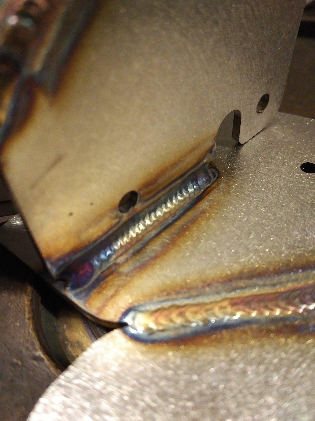

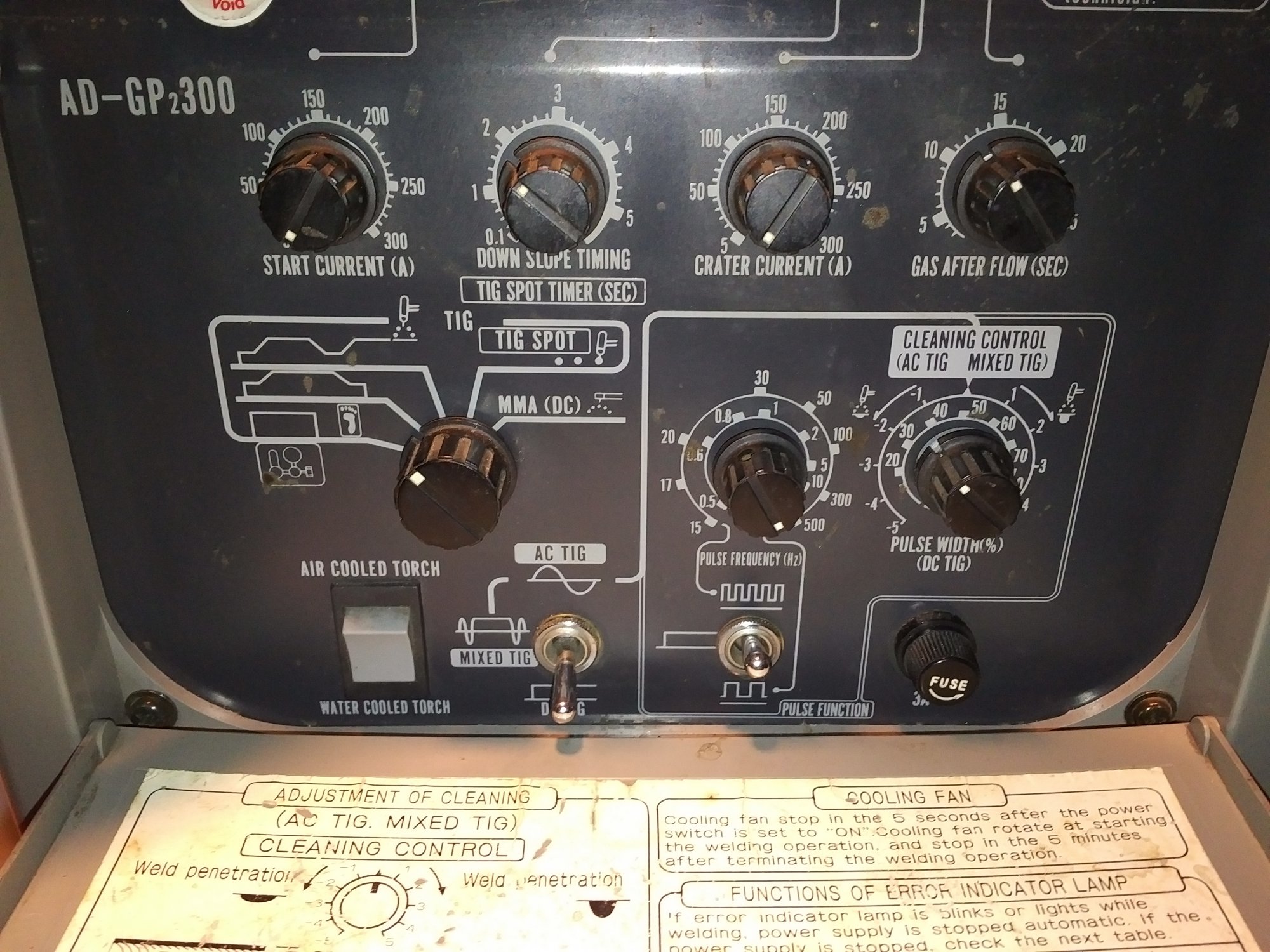

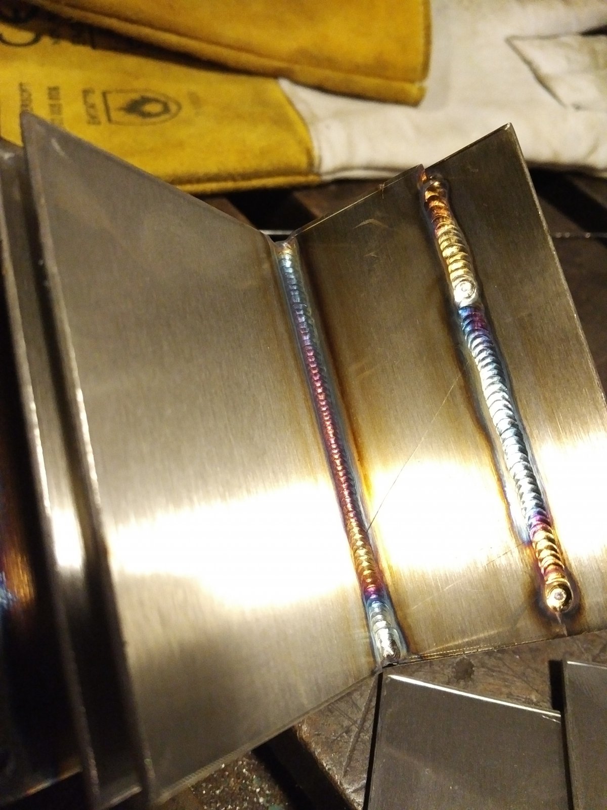

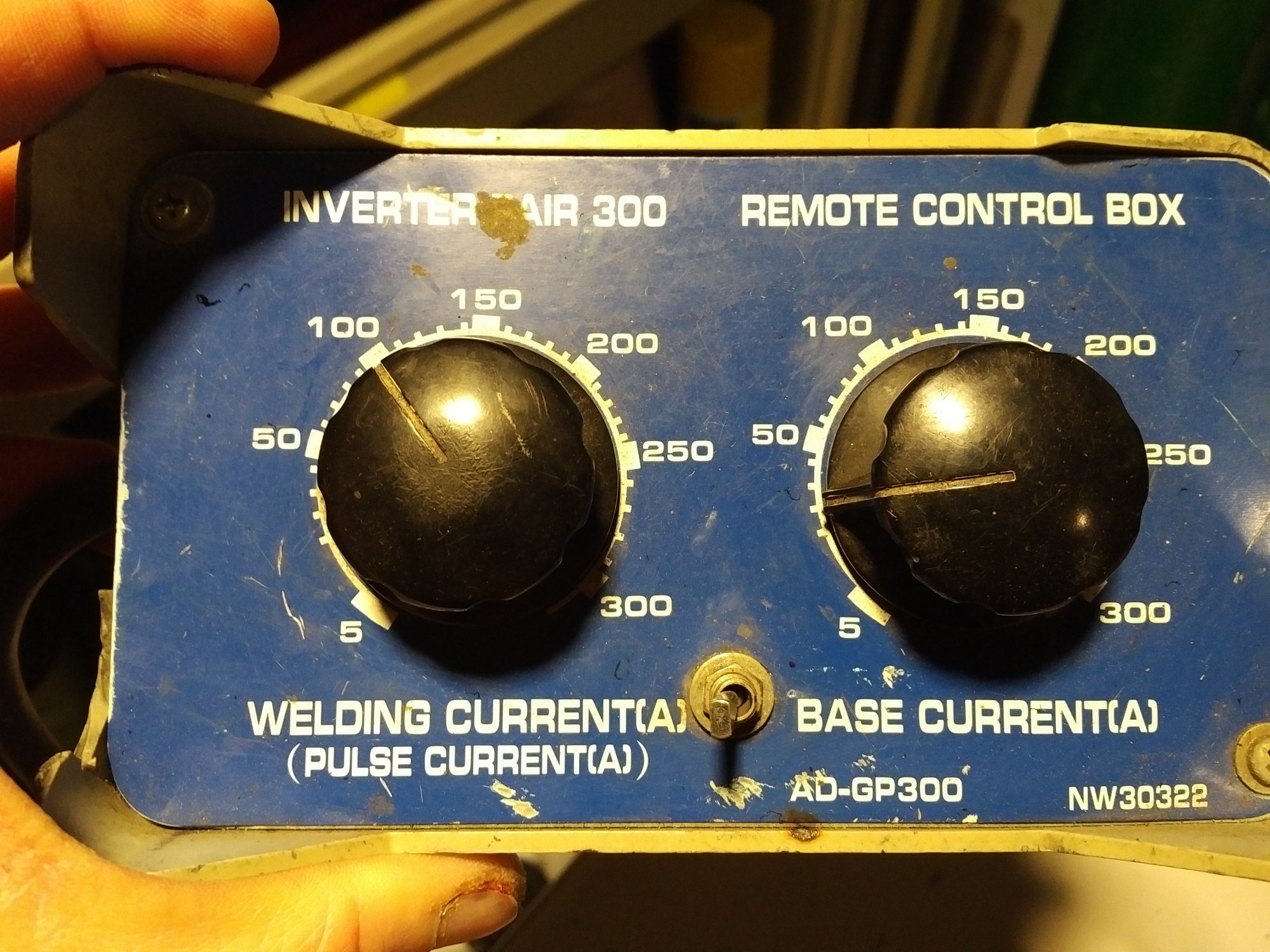

Having spent the morning with @Richard. Yesterday, I left with a new appreciation for high speed pulse. I have always struggled with heat input and travel speed on stainless, until now...
These are the machine settings I am using...
So, 500hz, 35% width, peak of 100, background of 30 ish... 4t, torch switch.
I'm well pleased with the results, thanks once again for showing me the light mate
