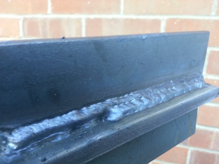

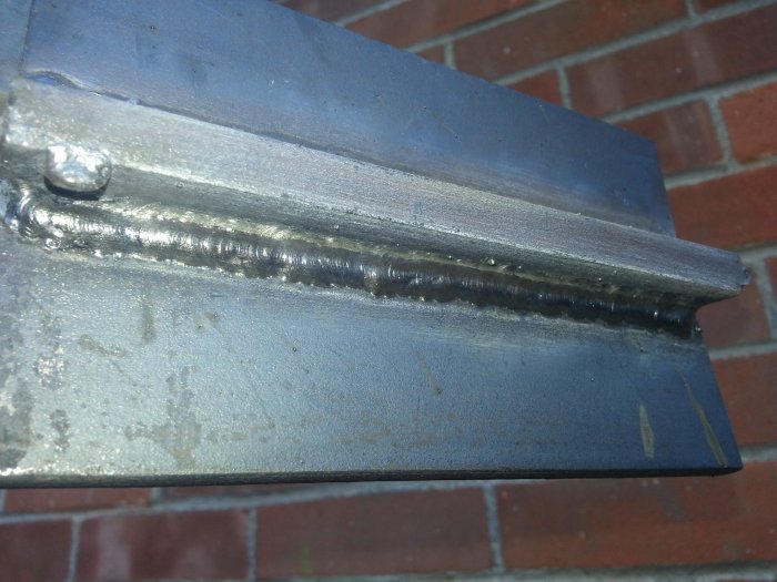

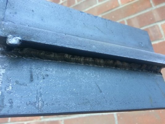

My brother has been teaching me to arc and mig weld. Now the Mig I found really easy, and to a certain degree I picked up arc fairly quick. The trouble im having at home (which I started to day) is over head.
Im doing t-joints fillet and cap (hope thats right) am using siftrode 6013 3.5mm rods and im either eating through the steel 1/4inch around 95 to 110amps or im getting wormholes all over the place...
Would love a suggestion on how to do this a bit better or a few tips or even a vid of someone doing it
. Ive hunted youtube for hours and can only fine American vertical v-groove welds.
Thanks for anyhelpor advice given.

burning through 6mm plate is pretty serious stuff. turn your welder down a bit more, aslong as you weld within the recommended range for you rods you will be fine. ensure the 2 plates fit up nice and tightly before welding and you really should'nt get burn through on 6mm plate.
