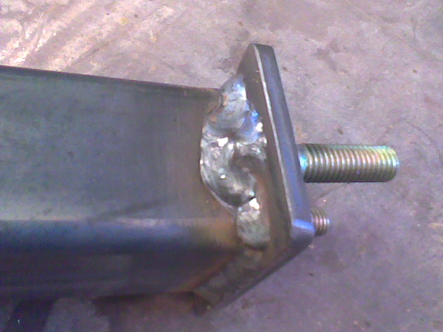

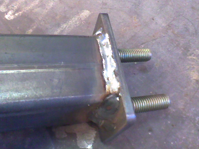

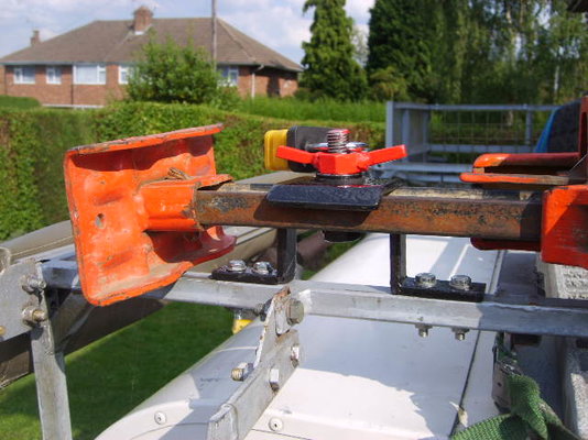

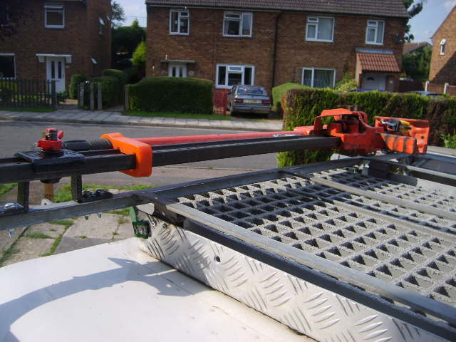

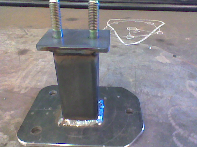

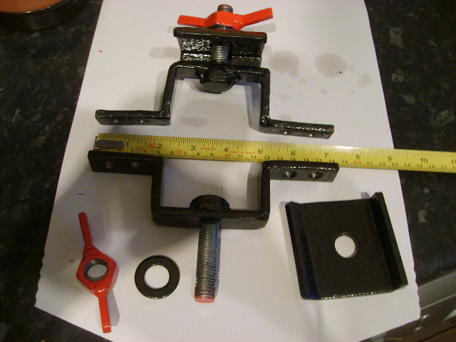

Hi all, sorry about the picture quality. I borrowed the idea from someone here. I needed to carry a hilift jack on a Jimny and this is the answer. The bracket bolts between the spare wheel carrier on the back door and the spare wheel. the jack fixes to the two bolts outside of the wheel. Eventually I will make a fitting for the CB arial to come up the back of the spare and mount the arial at the top.
The plate is about 5mm and the box section 50x50 mm 2mm wall.
Welder was a Merkle redmig 1600
