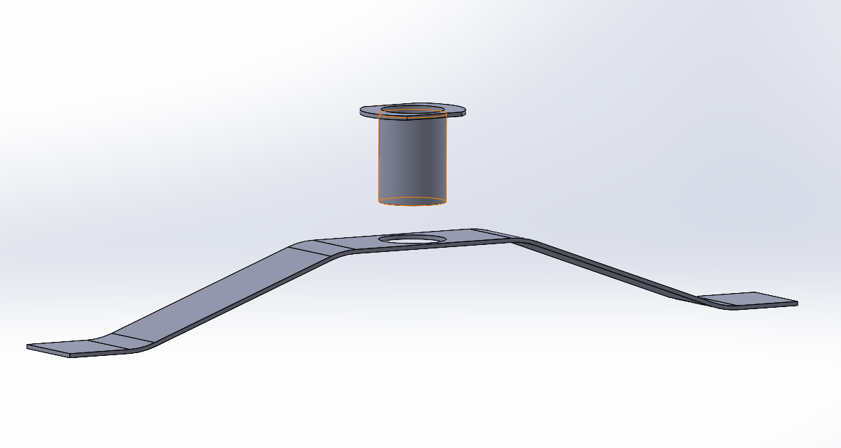

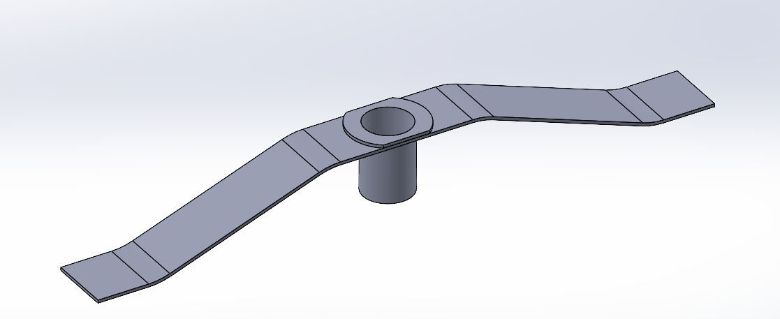

Hi, thanks for the response. It would be used to stabilise a larger structure. It's 1 meter (3,2 ft) long. It would probably be (galvanized) steel.yes you could weld it, whats its applicaion?
Hi thanks for the response. Would Silver soldering offer a big difference in results towards cleanlinness/strength?Yes, it's possible. Another way might be to silver solder the parts. It all depends on material and use
Thanks, is there a noticeable price difference between welding and soldering?It is a very strong joint, and low profile, whereas wirh MIG or TIG there will be a noticeable bead of weld (less so TIG).
Okay thankyou for all the help! All the best.If you're getting someone else to do it I wouldn't imagine so.
Yes I know that's why I put the galvanized in parentheses but thanks for the comment!Welding galvanised steel is not a good idea, because of the toxicity of the zinc fume given off. Better to weld the components as plain steel first and then galvanise.
