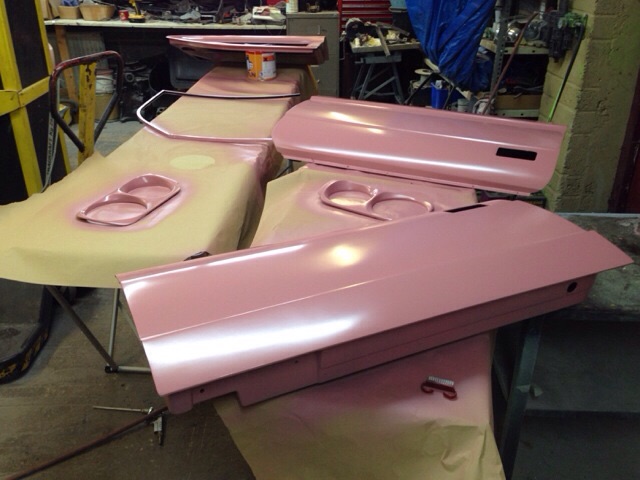

Does the lechlar have a similar build? I managed to get a smooth finish with the Jota on 3/4 of my panels but I think that was luck as the one I did yesterday was bumpier than a Cornish road.
No problems whatever. The Jotun can is from my early assumptions that all epoxy primers were the same. All the work in the picture is Lechler. I found that Jotun was harder to sand and was never a good finish, taking much sanding to sort out.
On my recent jobs I used Lechler Hi build 2k filler primer (LS105(29105)), I compared it to Lechler Green (on paper) and it seemed to win out (but I can't remember why right now).
I think it is wise to use the high build over the epoxy so as not to accidentaly sand through the epoxy back to bare metal.
Langy, have you compared the two?
