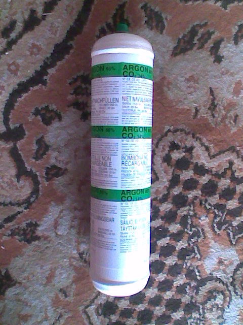

According to the website, I decided to buy a gas bottle with a mix of argon and carbon dioxide. Very long sought for us in Russia very difficult to find. But I found a bottle. The problem appeared with the gas reducer for these cylinders. Just spent a lot of time looking for him, and it was not in vain.
As a result, I have a complete set of welding machine with two gas cylinders (a mixture of argon 86% + CO2 14% and net CO2)
I liked to use a mixture of gases argon and CO2. Pure CO2 gas has not given a smooth weld seam as a mixture of gas.

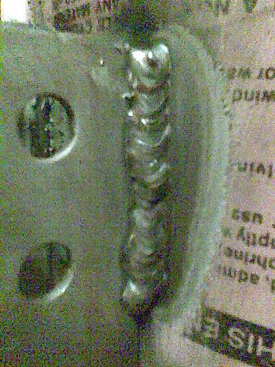

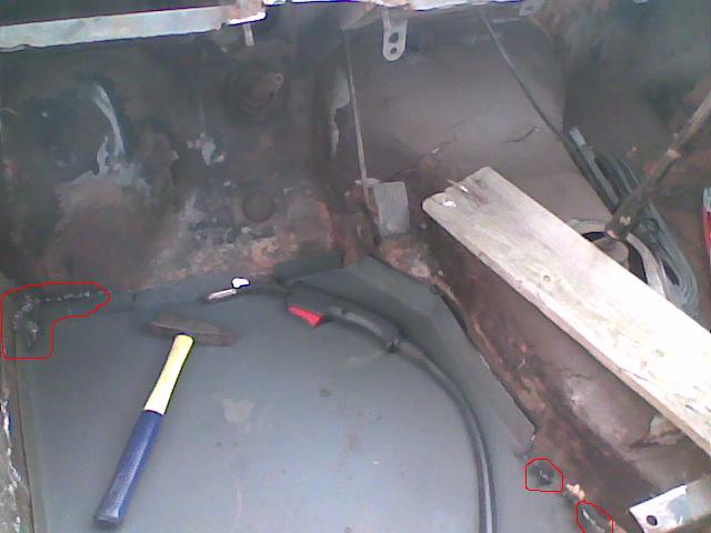

Before you begin to repair the body, I have done several projects for training and education. The project was implemented in a relatively indoors and has in my view good results. The welding seam was qualitative. But when I moved the welding machine to the car and proceeded to weld, the quality of the seam I was very upset. And most importantly, as I have not tried, I could not get a quality weld.
I used to set the voltage, welding wire feed speed / current, the amount of gas. The thickness of the metal, which I welded 1 mm. Welding wire 0.8 mm.
I think the problem is that I am not very well cleaned metal for welding.
Next time I'll clean the metal very carefully.
