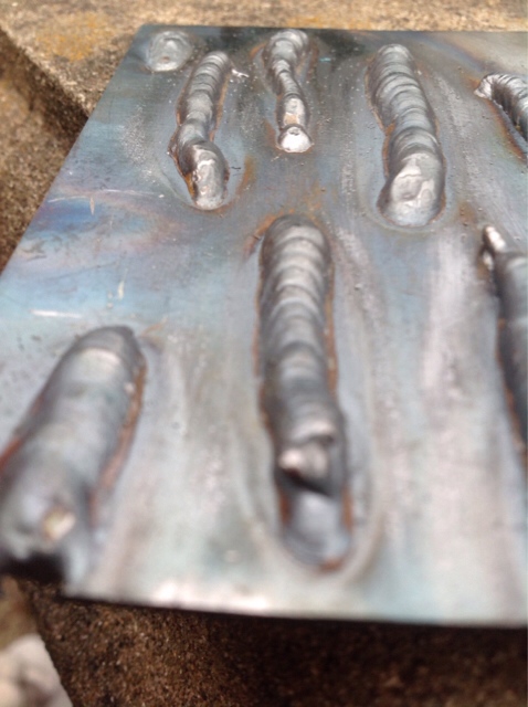

Here are a few pictures of the results I got any comments will be helpful thanks
Welder used
Clarke 150 te turbo
8 mm wire
Pub gas (c02)
On one mill plate
And the settings on the mig
They look pretty good to me, especially with pub gas. You need to look underneath to check the penetration. You did well not to blow through on 1mm metal.
