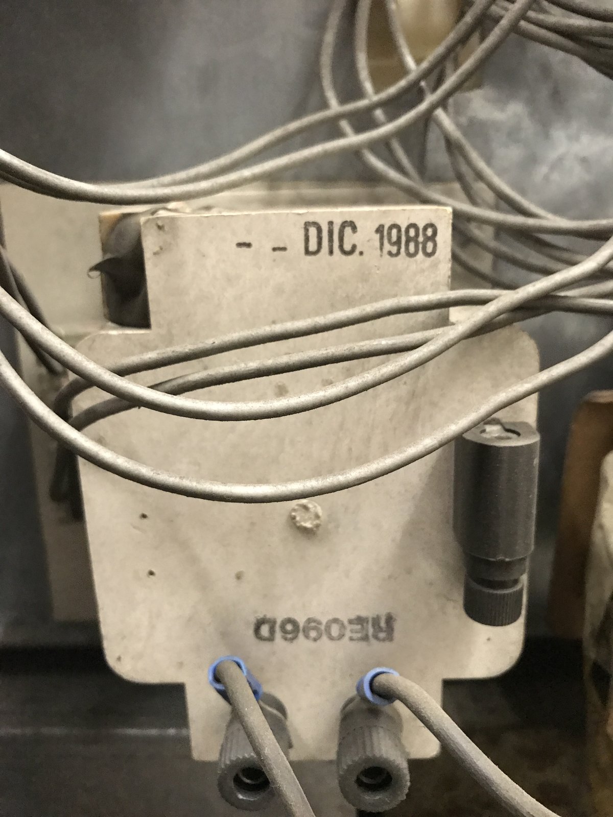

My hf generator broke on my Telwin Supertig AC/DC and a new one is about 350€ plus tax so I’m thinking about building my own. Looks like a fun project
I’ve googled a lot but I’m still pretty unsure of how to go about it. Since it’s a AC/DC I just want the arc start function when I’m welding steel with DC but I guess it should always be on when I’m welding aluminum with AC?
Any hints/videos of how I should progress?

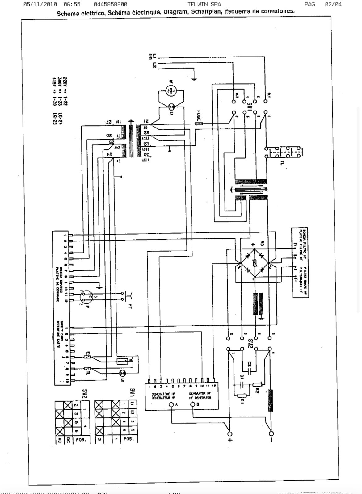

I wonder if a generic board will fit. My welder is a brand I can’t find any info about at all so I’m sure the board wouldn’t be a genuine replacement. I may be wrong.
Does this picture show enough info?
