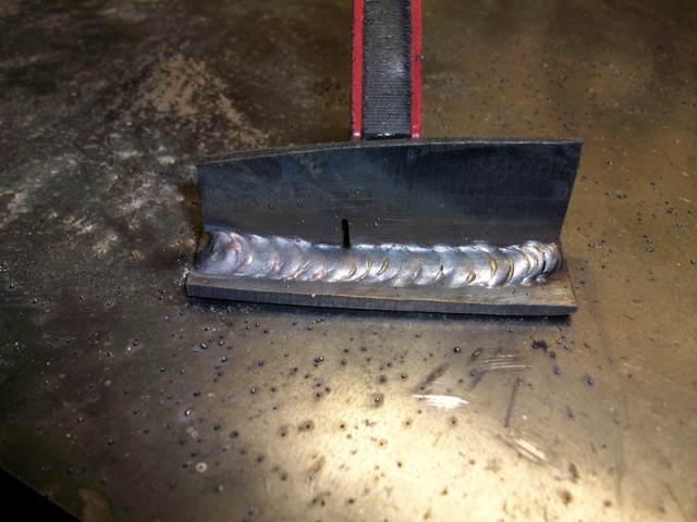

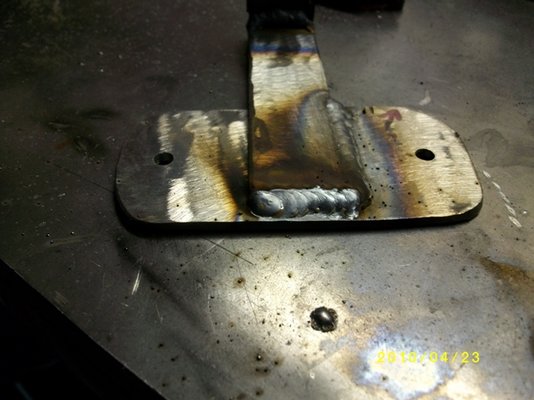

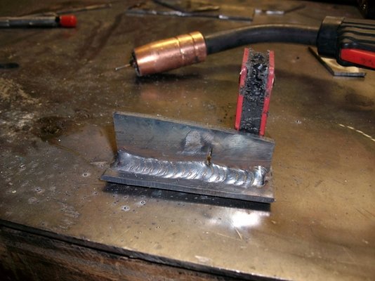

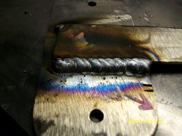

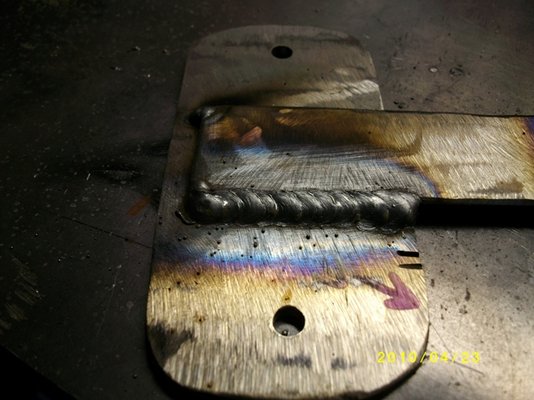

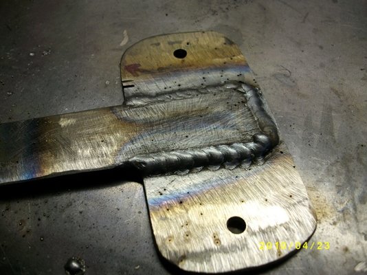

Yeah is machine needs more oomph or his wire speed could be better too hot not enough wire( for that wire) for the steel i'd be suprised, pleasently however if you had any peno, it not your fault but you will want over 200 amp to weld over 5mm with out effort.
