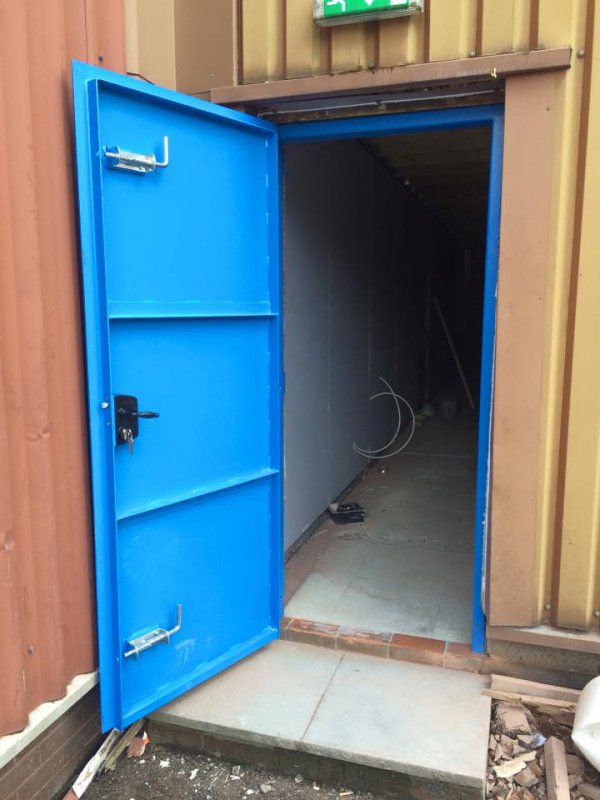

I've seen a bit of talk about how sh..rubbish these doors are, and that they can be opened relatively easily with a screwdriver.
Question is, what can be done about it?
I've got three to look at sorting out, and I've come up with the following;
20mm SHS, riveted into the edges to increase resistace to the bottom being pulled out.
Sprung bolts and steel plates bolted in to the floor, again to prevent the bottom being pulled out.
What replacement locks are available for them, that could increase security?
Bearing in mind that for two of these doors they'd have to get passed three cars, two locked gates, two trailers before they got to the doors, then the doors would be a struggle to open because of everything behind them.
The third door looks to have been tried in the past, hence putting some box section down the edges, to add a little strength.
Any other pointers?
