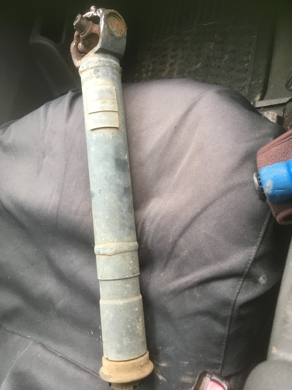

No diff-lock on ours.If it's got diff lock you can drive home rwd, take it steady though
It’s still got diff lock, it’s just missing the linkage. You *could* get under it and manually select lock with a pair of mole grips. You can get the linkage to retrofit it with the stubby leverNo diff-lock on ours.
Sorry Dan, I meant no option to engage it from the cab.It’s still got diff lock, it’s just missing the linkage. You *could* get under it and manually select lock with a pair of mole grips. You can get the linkage to retrofit it with the stubby lever
Fortunately we have a LR specialist nearby who are going to wait for the car and sort her out with a courtesy car.

If I had the time I'd sort it myself but she needs it back ASAP, plus it's booked in for something else anyway.Specialist? It’s 8off 9/16 bolts. Too much money if you’re willing to pay for someone to do that job!
They didnt all have them. Some have them all fitted up, some have them but no linkage, some (like my late D2) dont have the internals in the transfer box (i’ve checked and no nubbin on the top of the extension housing where the linkge would connect - LR made it an option on later models choosing to rely on the traction control only off road).It’s still got diff lock, it’s just missing the linkage. You *could* get under it and manually select lock with a pair of mole grips. You can get the linkage to retrofit it with the stubby lever
