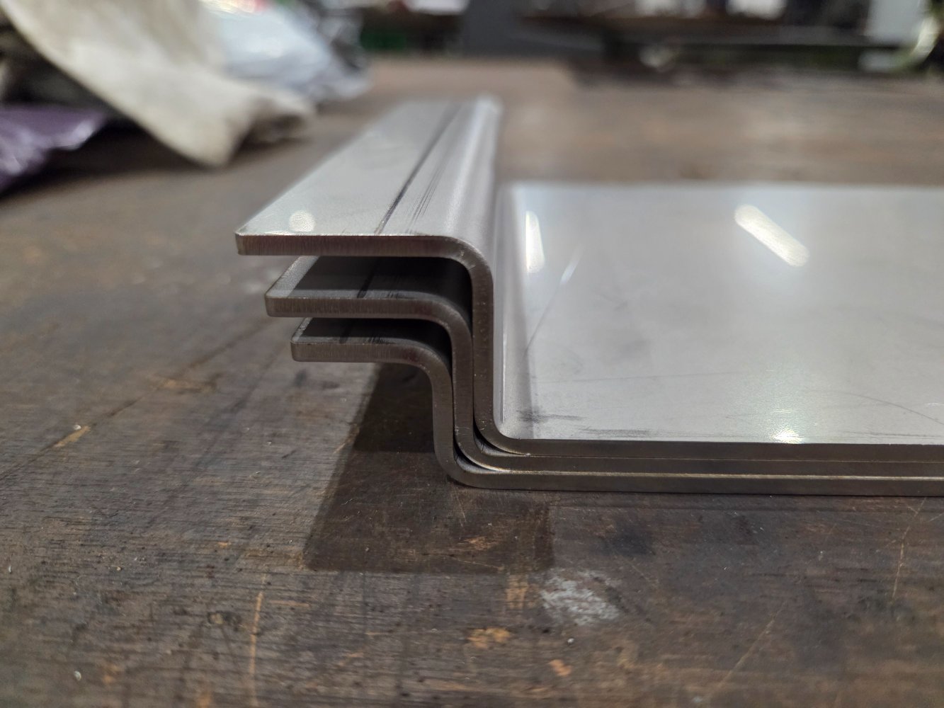

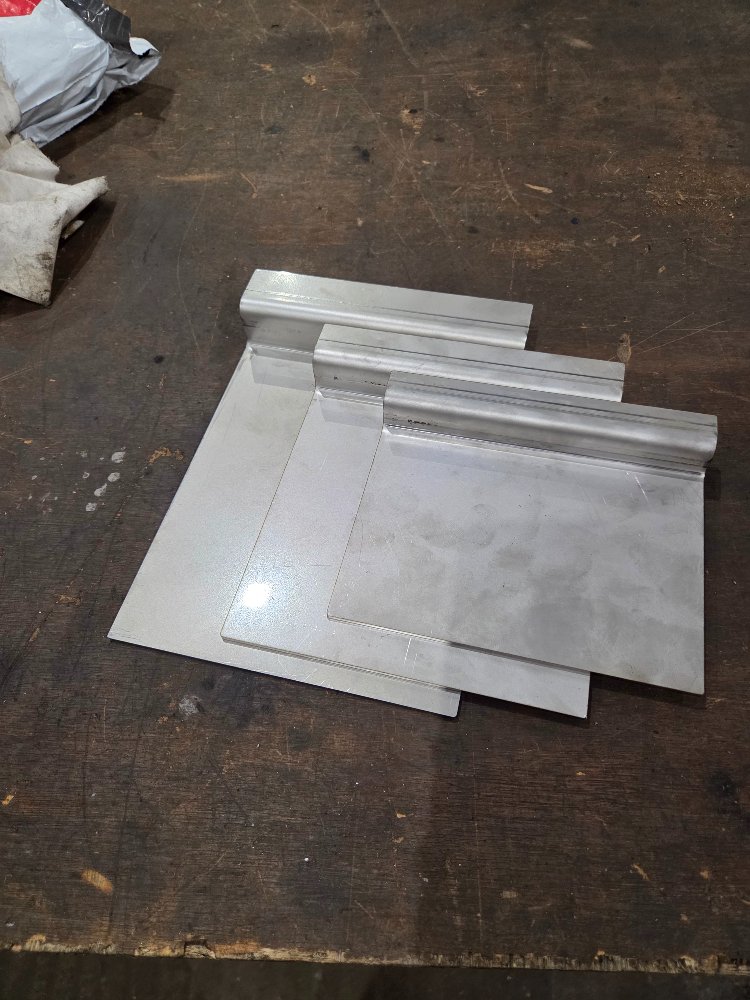

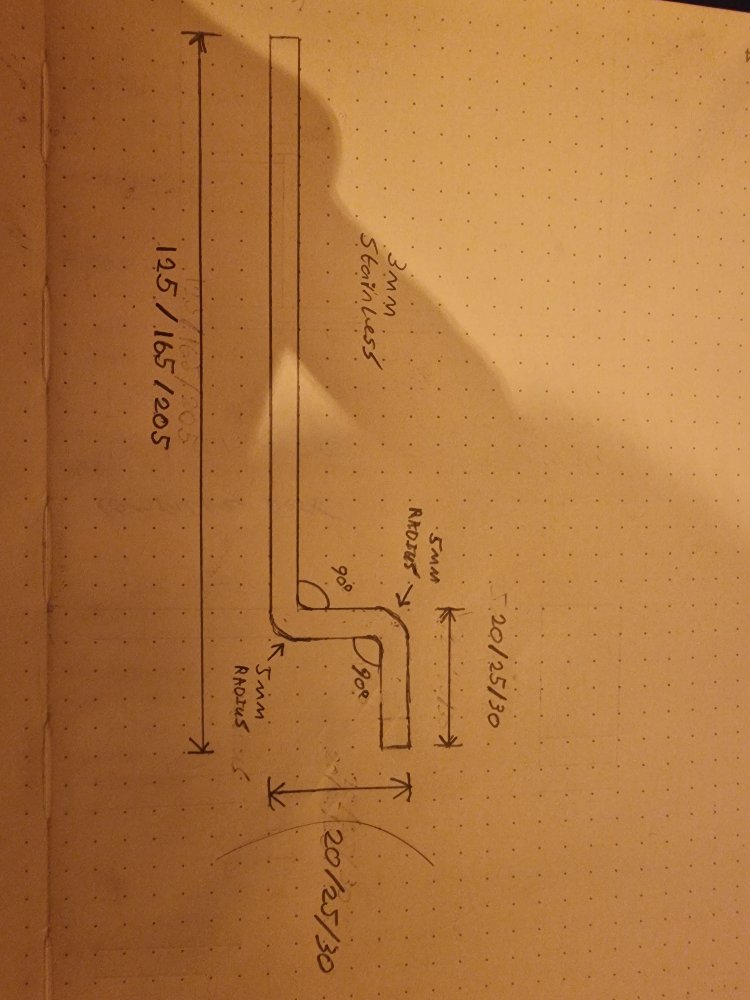

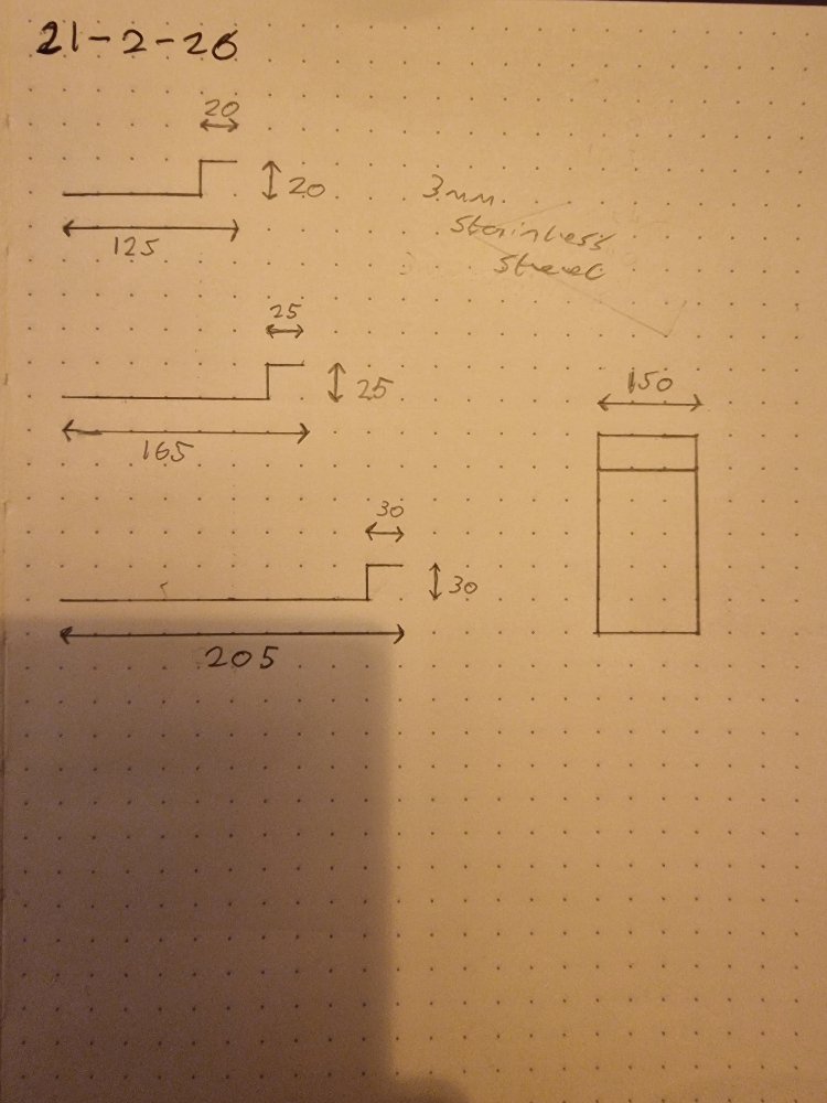

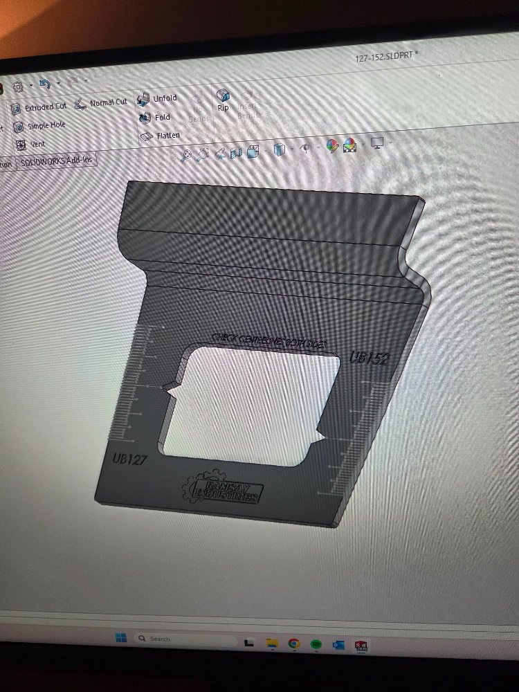

If the 3mm stainless with the 20-30mm bend dimensions is problematic to press, could it be (red) hot bent?
The item is only 150mm wide. Make the former to suit the smallest dimension and then add a 5mm packer each time you move to a larger one.
It is only the height that is critical, so leave the ends long and trim afterwards.
