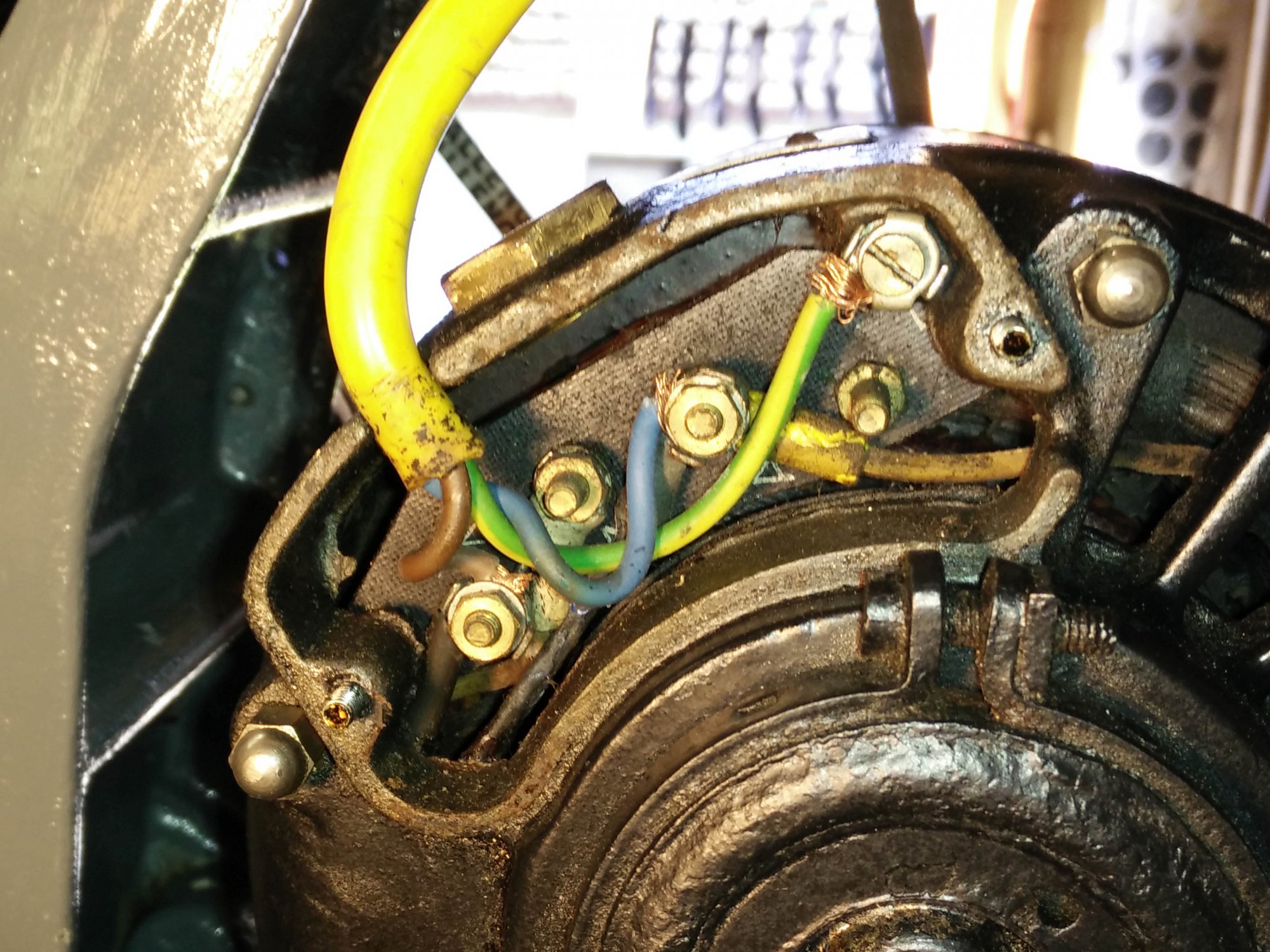

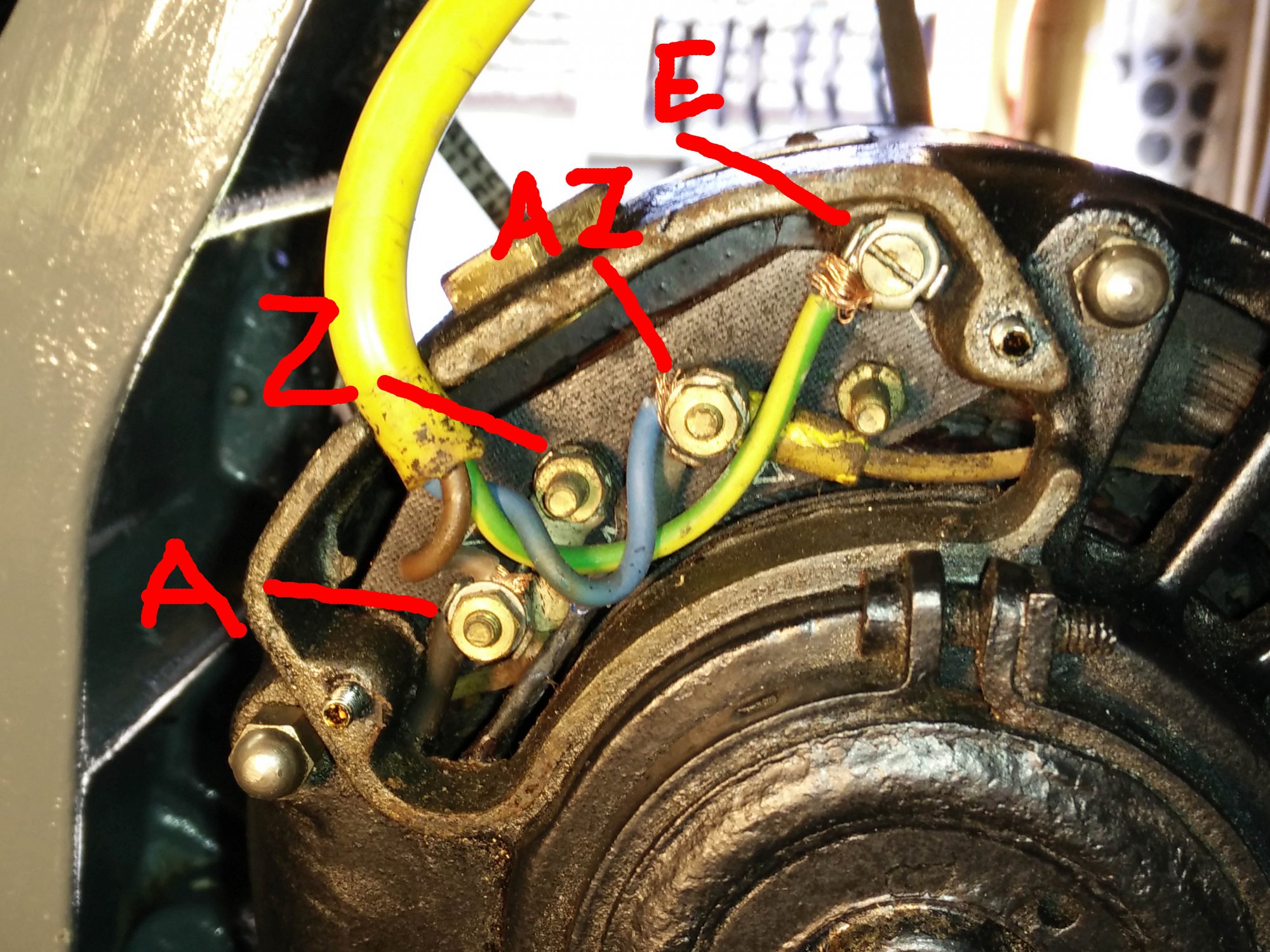

I've reached the stage with Maurice where it's time to perform a Dr Frankenstein on him [not yet, Fritz!] and breathe some 'controllable' life into him.
The motor, single phase 240V, has these, which seems straightforward enough, even for a Numpty like me

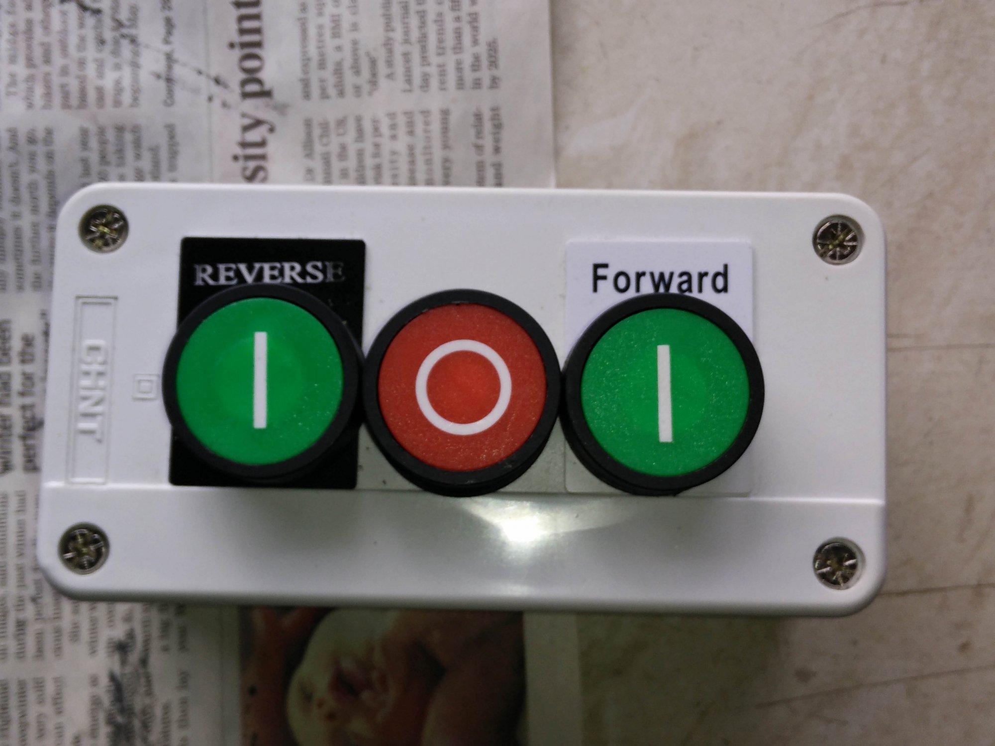

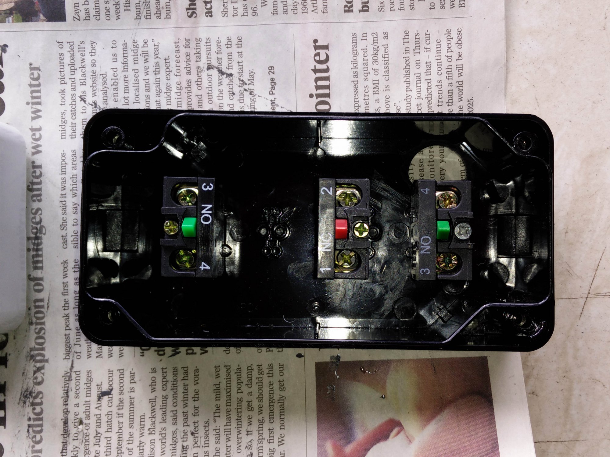

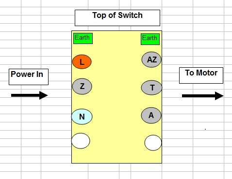

I have an NVR switch which I'm happy enough with wiring in, and a Dewhurst switch with two banks of four contacts and this is the end of my knowledge/experience. I really need an idiots guide to connecting to wiring, i.e. "connect the brown one to contact X and the blue to contact Y" etc. Please don't link to online wiring diagrams, I've seem those and remain none the wiser.
[how did I get this far through life without killing myself....
I also found this in a drawer but suspect it isn't suitable for my purpose, but confirmation would be appreciated - it has six contacts in total

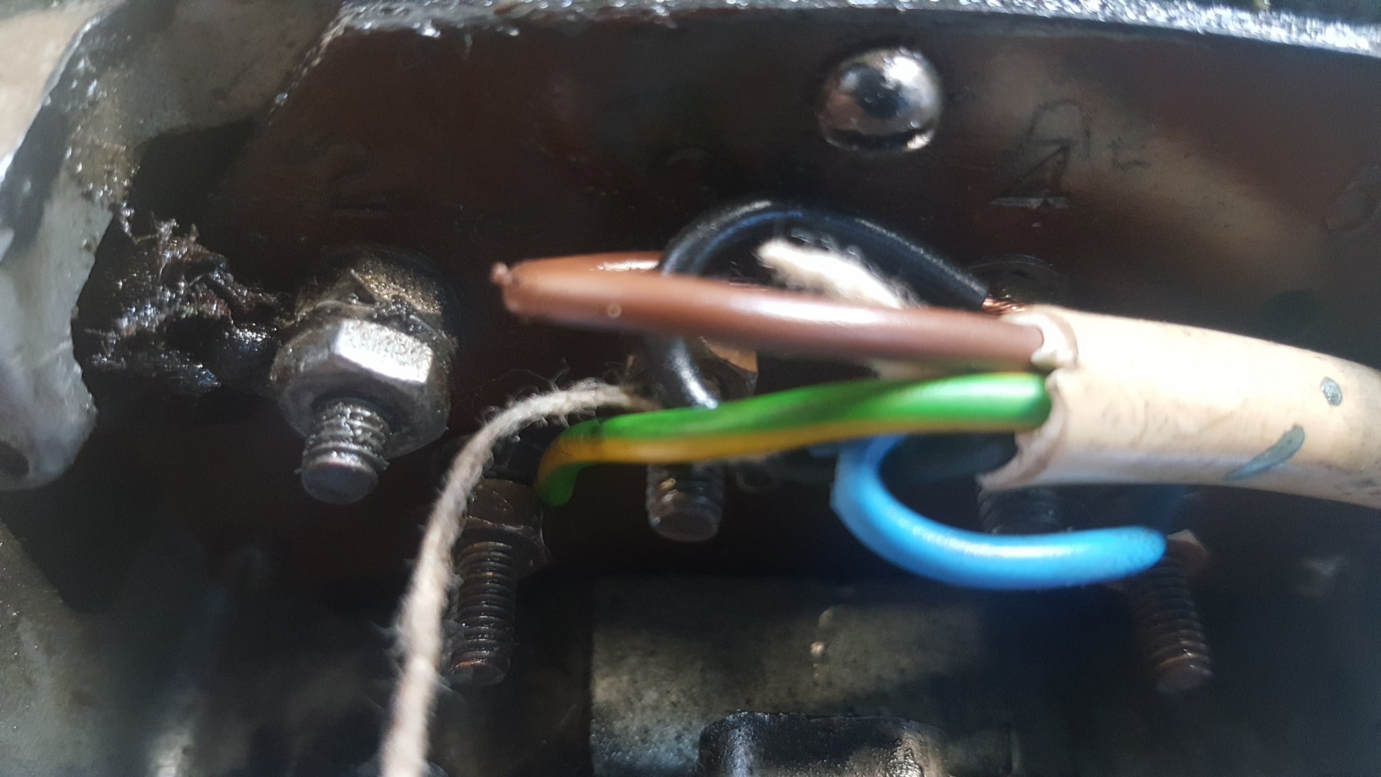

] and the RCD trips again. reset and try 'Reverse' position same again. Reset RCD again and replaced the fuse in the plug in case that was the cause for the none response. No difference.
