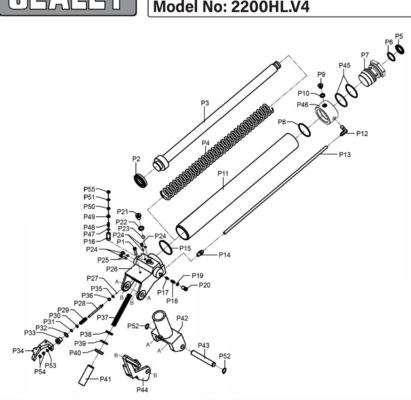

but 2200hl.v2-p04 does not seem to be available online.
Thank you. I know ccw-tools have the seal kit and various other bits. No big spring though. I'll take it apart.I bought a seal kit for my 2200HL. Only one place listed it, i'll try find who it was.
The spring is internal on the piston rod.
You may have air trapped which makes the hydraulics seem springy.
That sounds more like a pressure relief than a bleed or anything else. The symptoms are like air trapped somewhere, can you press the jack back down after it has lifted ?There is some kind of bleed hole a the bottom though. it might just be for emptying the fluid from the ram. it's a grub screw / ball-bearing seal.
