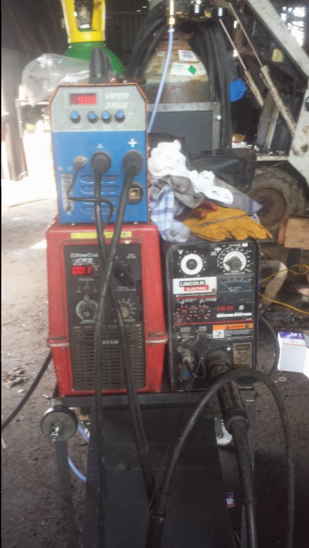

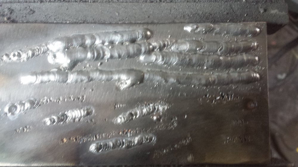

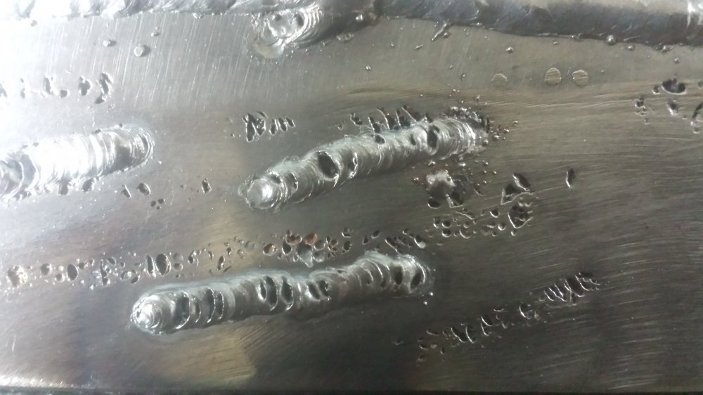

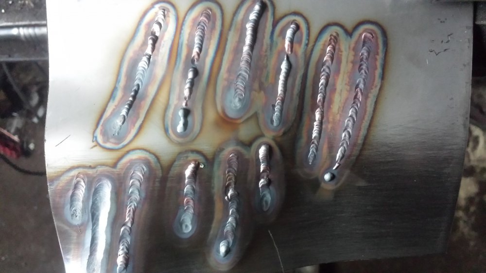

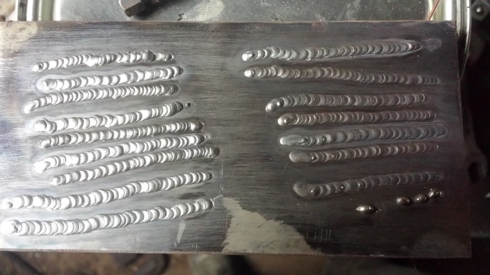

Hello first time posting but been learning from here with a while regards mig welding. Im a farmer so luckily my welds dont have to look great. Have a good grasp of mig at the moment but tig welds are coming out shoddy looking.
They are porous and just not right. Running argon at 8 lpm and 2.4 tungsten on 6mm plate at 90 amps. Not too sure if its something thats wrong or that I just need more practice. I've read through the tig tutorial a bit and cant pinpoint whats wrong with the setup.
I threw on a few runs of mig just to show I can use that...badly..

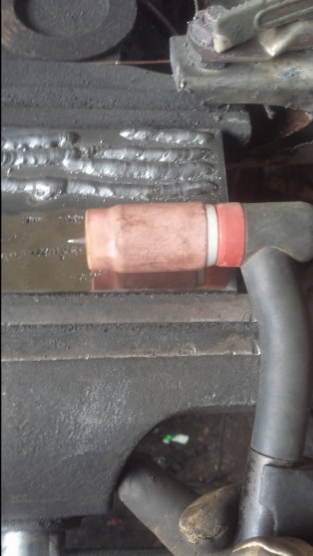

This is the stickout I'm using. About 5mm on a NewArc Viper 2000s run off a powcon 400SM power source. Dont really know of any other info I can give but ask and I'll try to answer and thanks in advance for any help or ideas.
