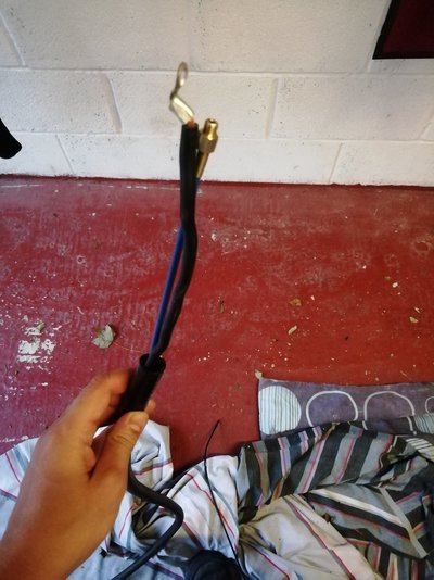

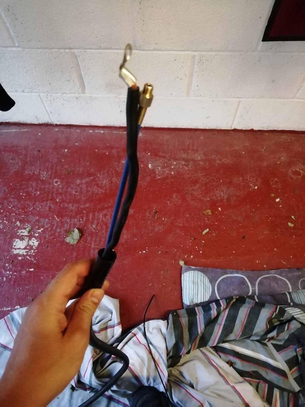

I have an old clarke 100en and I attempted to change the liner with the clarke metal liner. Unfortunately it was impossible to feed it into the outer sheath liner would get so far and kink. It was also impossible to pull it through with wire.
I ended up pulling the outer sheath off the machine to attempt to put the new liner in and slide the sheath back over the bundle. Unfortunately this was not possible either.
Now I've ended up with a machine with out an outer sheath to keep the wire bundle together see pic.
I'm not sure how to proceed with this. My patience has reached zero with the machine and I'm reluctant to spend any more money on it.
Is there some trick to getting the bundle back into the sheath? Or are you supposed to wrap them somehow? I just can't see how it's possible to feed them through the sheath I have it's just too small a diameter.
I think at the moment it's looking like it's going to the tip and I'll buy a new one.

All threaded no problem once I'd sprayed a generous amount down the sheath.
