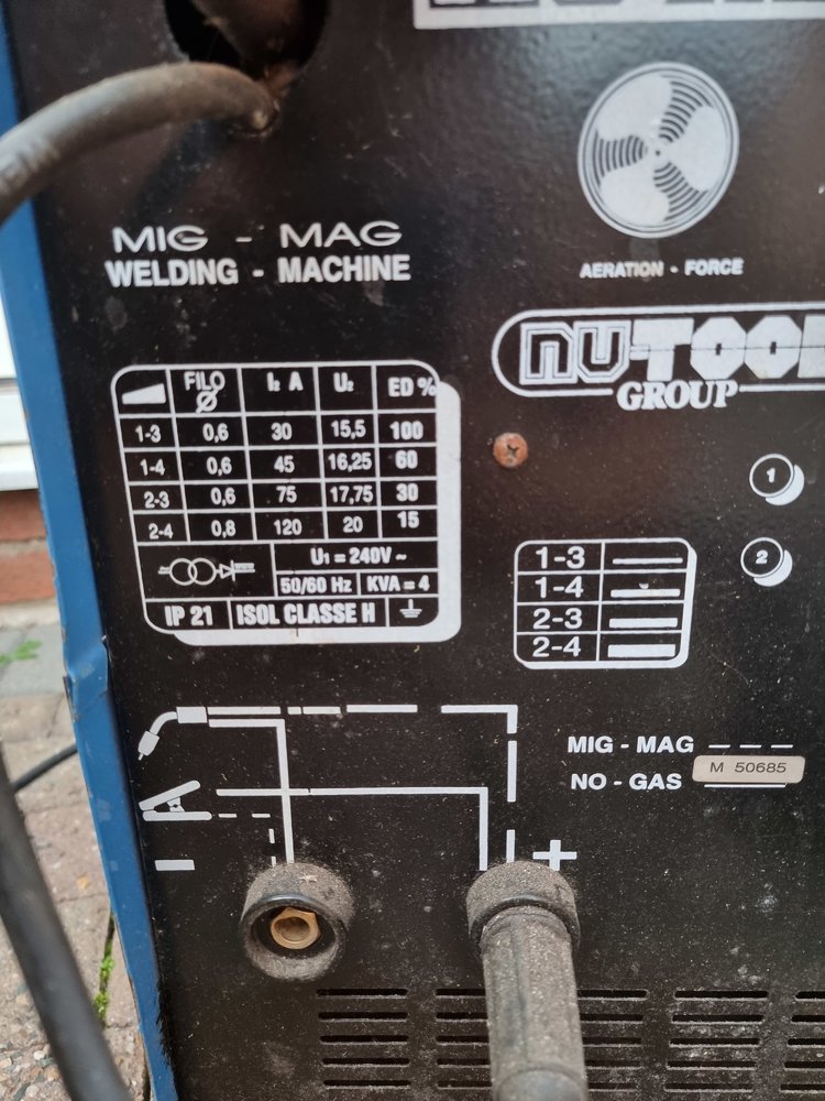

Yep, but suck it and see.Brilliant thank you for your help I really do appreciate it mate. just to confirm I understand properly if I'm running on setting 1-4 with 0.6mm wire then I can run the welder for 6 minutes continuously welding then it needs a 4 minute break is that correct?![]()
Thank you mat glad I'm back in line now XD been a very long time since I don't my 12 week welding course!Welcome to the forum.
Yes, that's what I'd make of 60% duty cycle.
Haha I know mate I just was asking so I know that I'm understanding my welder using the chartSix minutes is an awful lot of continuous welding. You'd need a ton of material to have to weld anywhere near that. It's mainly prep and a little bit of welding.
