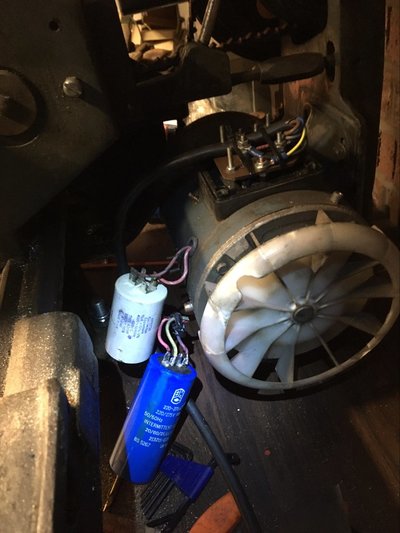

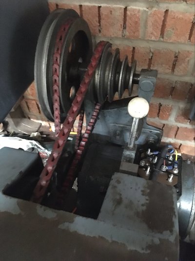

When I've got my boxford set to the highest speed it runs really slow. The motor/pulley shaft seems to be running very fast but the chuck is turning very slow and is easy to slow down/almost stall. The chuck turns quicker in the lower gear settings.
When I first got it the lathe it took a while to spin the chuck up to speed in top gear but it got there.
Strange thing the motor seems to be running at full speed. I can hear the centrifugal switch clicking in on start up and hear it dropping out after turning off when the motor is running down.

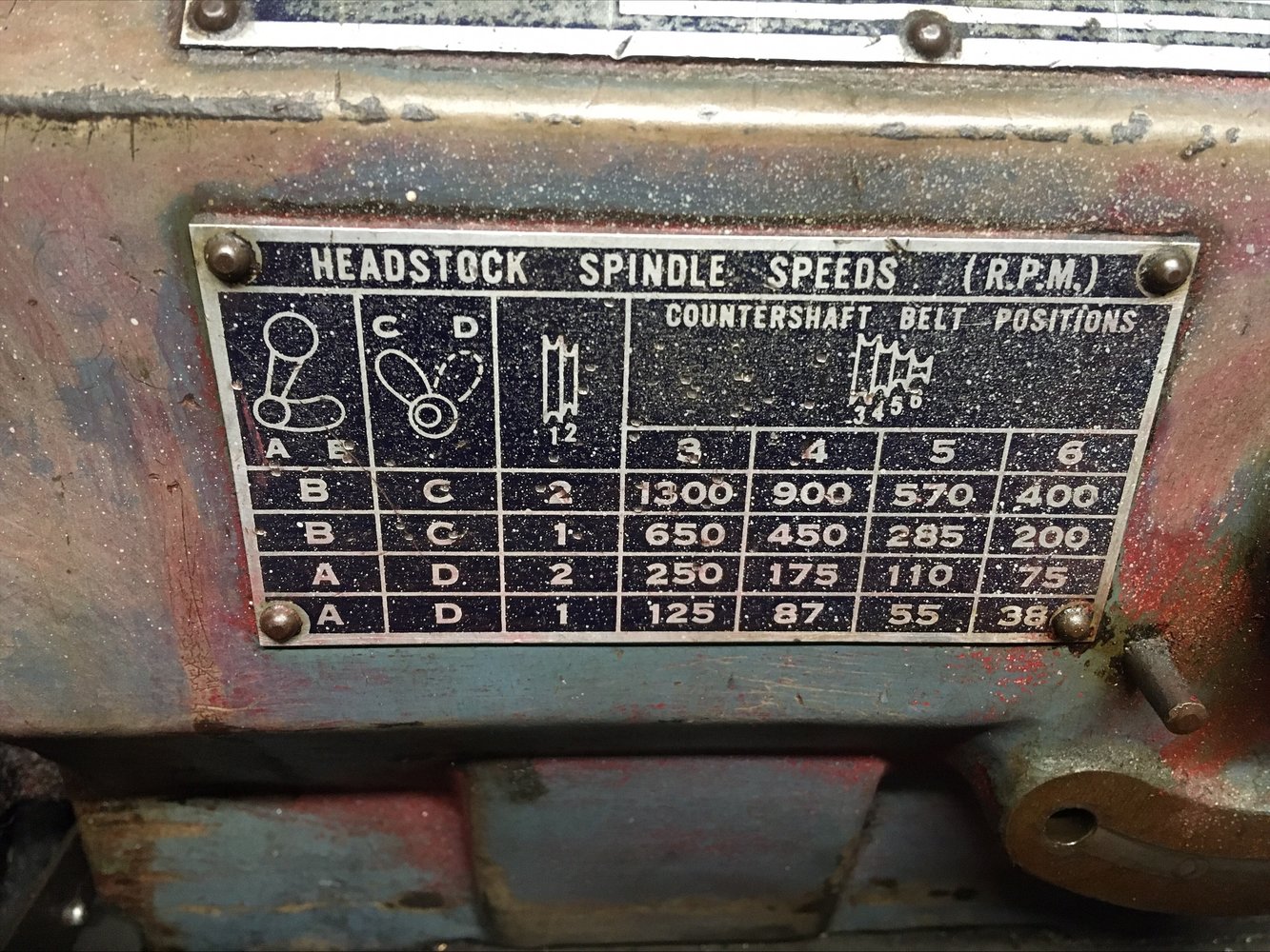

Speed plate, settings are set for the 1300 RPM.
I thought it was maybe a running capacitor fault not getting the motor to full speed but the centrifugal switch can be heard clicking in and with the belts off and the motor running idle it seems to running at full speed to the eye anyway, I've no tachometer.
I've meggered the windings to earth and getting 7Mohm.
Would you just slap a new running capacitor on and see what it's like? Any other tips?
Motors have always been a dark art to me
It runs faster at the 250RPM setting than the 1300 setting which suggests a struggling motor but the motor seems to run at the same speed no matter what which doesn't add up.
Speed plate.

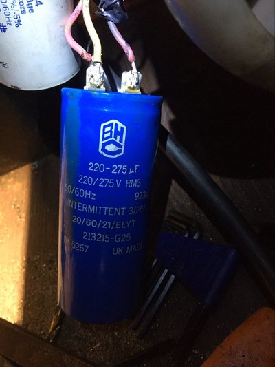

Current capacitors
Edit: further info.

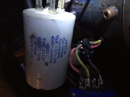

Disconnecting the white cap the motor doesn't start so I'm guessing that's the start cap and the blue the run cap.
Blue says intermittent does that suggest the wrong cap is fitted?
Start Cap.
Very helpfully the motor plate is missing so zero data on the motor type/speed to work out and check the right replacement capacitor size.
