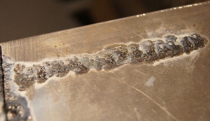

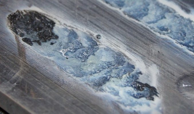

I'm hoping someone out there can give me some pointers on why I've experienced a disasterous first attempt at TIG on Alumiunium.
I’m a reasonably proficient steel MIG welder and have recently bought an AC/DC TIG machine with a view to using it for finer welds and for Aluminium.
I did a good bit of background reading and watching of “basics” videos before I fired up the torch and these were really useful to get me up and running from zero experience.
After a couple of evenings / days running beads, lap joints and fillets on various shapes and thicknesses of steel I am producing a reasonable weld (for a newbie) and am fairly confident I can get to achieve the cosmetic quality I aspire to by getting some hours behind the mask and improving my technique.
So I decided to dip my toe in the water with a bit of Ali – just to see if I could get a similar “newbie” result on that material.
To say my results were bad would be an understatement. I’m almost embarrassed to post some pictures of the results, however I could really do with some pointers and the advice on this site is really top rate.
I’ve tried various and numerous settings combinations but most are to no avail.
I would describe the problem predominately as in-ability to get a clean shiny weld pool started – all the video’s I’ve watched show a nice clean pool coming up after the arc starts, and then the welders move it down the plate and feed the rod. But I can’t seem to get this far – the weld pool doesn’t want to form.
I’ve posted some pictures below – so you can see how bad the results are.
These are a combination of every amperage, tungsten size, grind shape, pulse mode on and off, AC frequency , cleaning, etc setting in the book.
Set up is as follows:
• Machine: R-Tech 161 AC/DC
• Tungsten: White tip, I tried 1.6mm and 2.4mm. I tried ground to a point and ground to a shallow cone. Also tried red tips at 2.4mm.
• Filler rod: 5356 grade – 1.6mm diameter
• AC Frequency: 100Hz to 150 Hz. Tried other settings also.
• AC Balance: Set at 50% - but also tried lower and higher.
• Amps – tried everything from about 55 up to 130
• Materials being welded: 2mm Ali sheet , Grade 5251-H22. And tried 6086-T6 – 5mm thick – just to run a bead up the strip.
The last run of the day came the closest to actually looking like a weld. The material seemed to melt and I shoved in what felt like a long length of filler to the pool at a very shallow angle which resulted at least in some joining of the two materials. But as you can see from the quality – it’s not a weld.
As I said at the top – I’m not getting anything like this on steel in DC mode – in this mode I can sense the kit is welding properly and the wld quality is as good as I'd expect for a beginner.
Any observations, suggestions, tips to try would very much be appreciated. A set of base settings to have a go with would be very helpful indeed.
Sorry for the long post!
Top left = Attempt at weld pool, no filler – grey appearance and black pitted marks on surface. Weld pool would not form.
Middle left = Various runs on the sheet – many combinations of settings – same poor result and no weld pool formed. Plenty of melting reverse side on higher amps.
Middle Right = Lap joint and best run of the day - 55 amps, 2.4 white tungsten balled, 1.6mm filler, AC Freq = 150Hz, AC Balance = 50% – very fast adding of the rod.
Bottom: 5mm 6086-T6 - similar results
