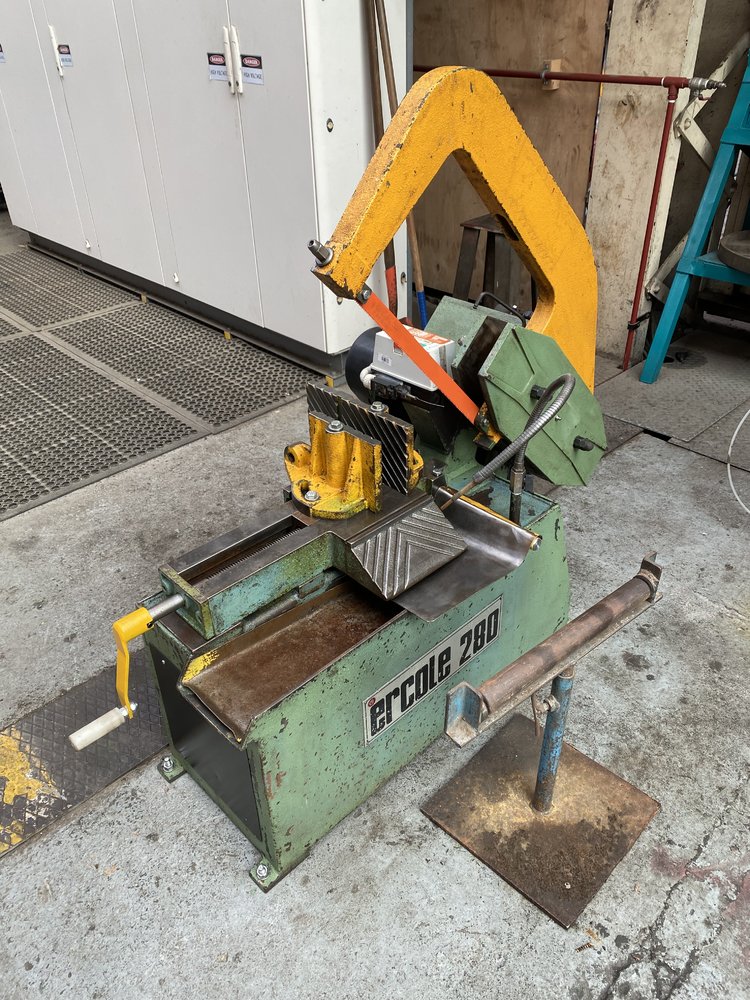

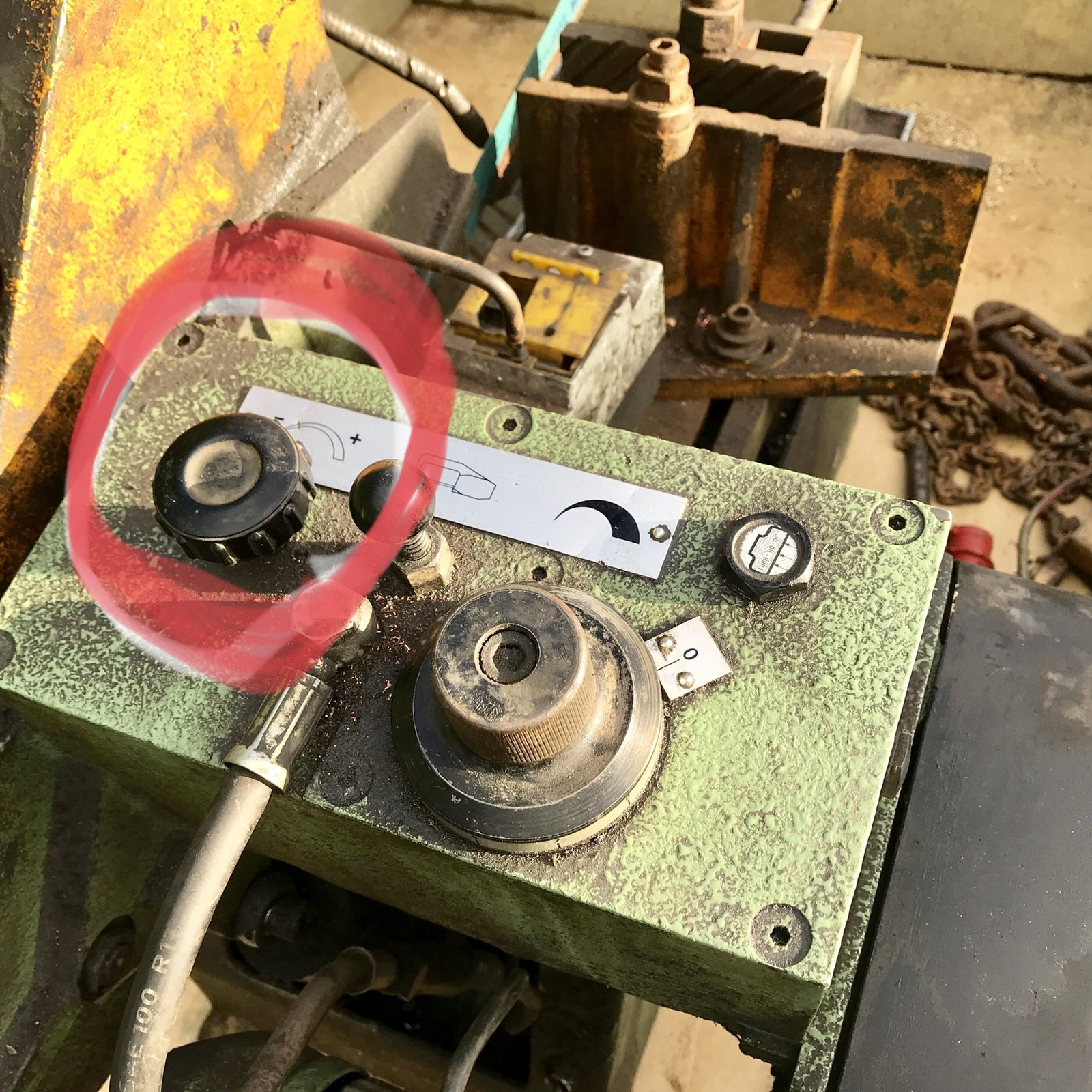

simplesawman New Member Messages 9 Nov 11, 2017 #1 Hi everyone, does anybody know what this control does on a ercole e280 power hacksaw
brightspark Member Messages 41,559 Location yarm stockton on tees Nov 11, 2017 #2 adjust the fall speed of the saw frame maybee ? shut it off and lift the frame see if it falls slowly . if so open it up and it will fall faster if it is
simplesawman New Member Messages 9 Nov 11, 2017 #3 The other nob controls feed rate and these seem to work a bit different to my old quarters and smith as gravity lifts the blade up
eLuSiVeMiTe Member Messages 16,438 Location ...... Nov 11, 2017 #4 Anything to do with adjusting the lift of on the return stroke?
simplesawman New Member Messages 9 Nov 11, 2017 #5 eLuSiVeMiTe said: Anything to do with adjusting the lift of on the return stroke? Click to expand... Oh it might be I will look tomorrow
simplesawman New Member Messages 9 Nov 11, 2017 #6 Also is it correct for these to cut on the push stroke
eLuSiVeMiTe Member Messages 16,438 Location ...... Nov 11, 2017 #7 Just watched a few vids of similar from the same manufacturer and they all cut on the push
500e Always buy fire insurance a flood is a hard start Messages 9,372 Location South West Nov 12, 2017 #8 On our 550 it is feed rate & has same graphic
Dieselman 63 Forklift Certified Messages 5,866 Location Wellington, New Zealand May 10, 2023 #9 500e said: On our 550 it is feed rate & has same graphic Click to expand... Awesome! Should have known to check the forum. Just resurrected this one, it’s been out of use for at least eight years but works perfectly.
