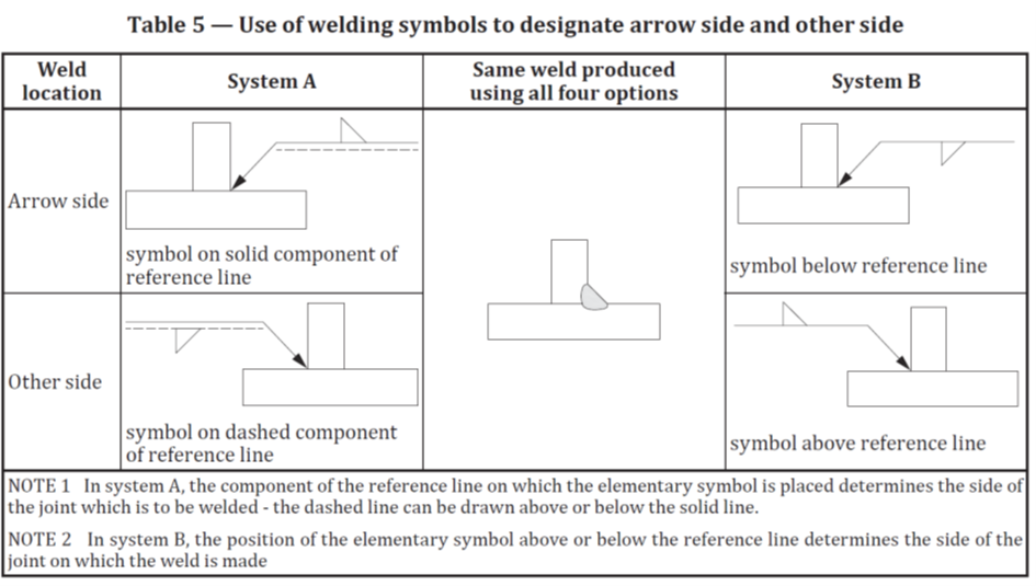

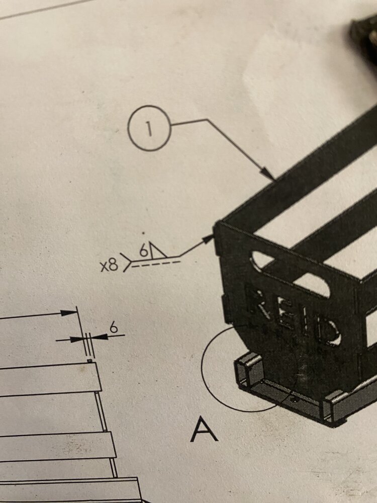

So the dashed line is superfluous.....just checked - looks like its to standard BSI BS EN ISO 2553:2019, system A. the dashed line is described in table 5, and the example shown is "weld to be on same side as arrow". the x8 in the tail is 8 locations (2 per edge, 4 edges).
No - if it was missing it would mean weld both sides.So the dashed line is superfluous.....
Could anybody pls help me with these symbols. Does it mean fillet weld one side but confused with the staggered lines, thank you.View attachment 494376
That's probably one of the clearest ways of illustrating it that I've seen - where's it from?View attachment 494512
This is your example: top left.
so you have to make a a6 fillet weld.
and 8 times in the same position.
and now you have to see if what is written on the drawing is correct

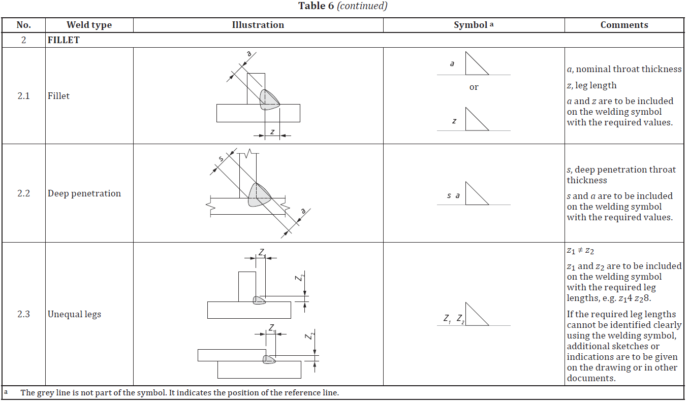

This is from ISO 2553:2019(E).
You have to be careful with the American version AWS A2.4, it is different and has no broken lines.
