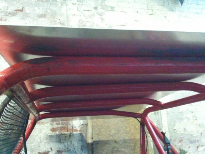

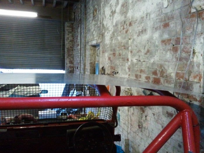

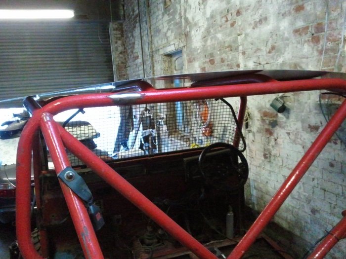

Im looking to fix this panel ontop of my cage to form a roof. Just wondering the best way to do it. Do i need to shape the panel or just fasten is down as i go, although i can see the corners being a problems
Weld some strips of steel 3mm thick 3/4" wide down inside edge of rollcage then drill strip and seal and poprivit roof to this ,this is how i and others in the clubs im in do it,,, hope this helps,,,,,
Of you didn't want to weld to the roll cage you could get ot make some 'P' clips to wrap round the tube and bolt or pop rivet to the sheet.
If you have enough clamps you could clamp it first to check it is going to fit correctly
