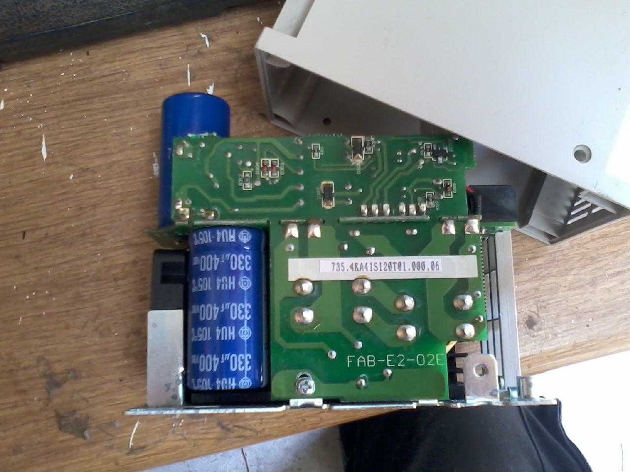

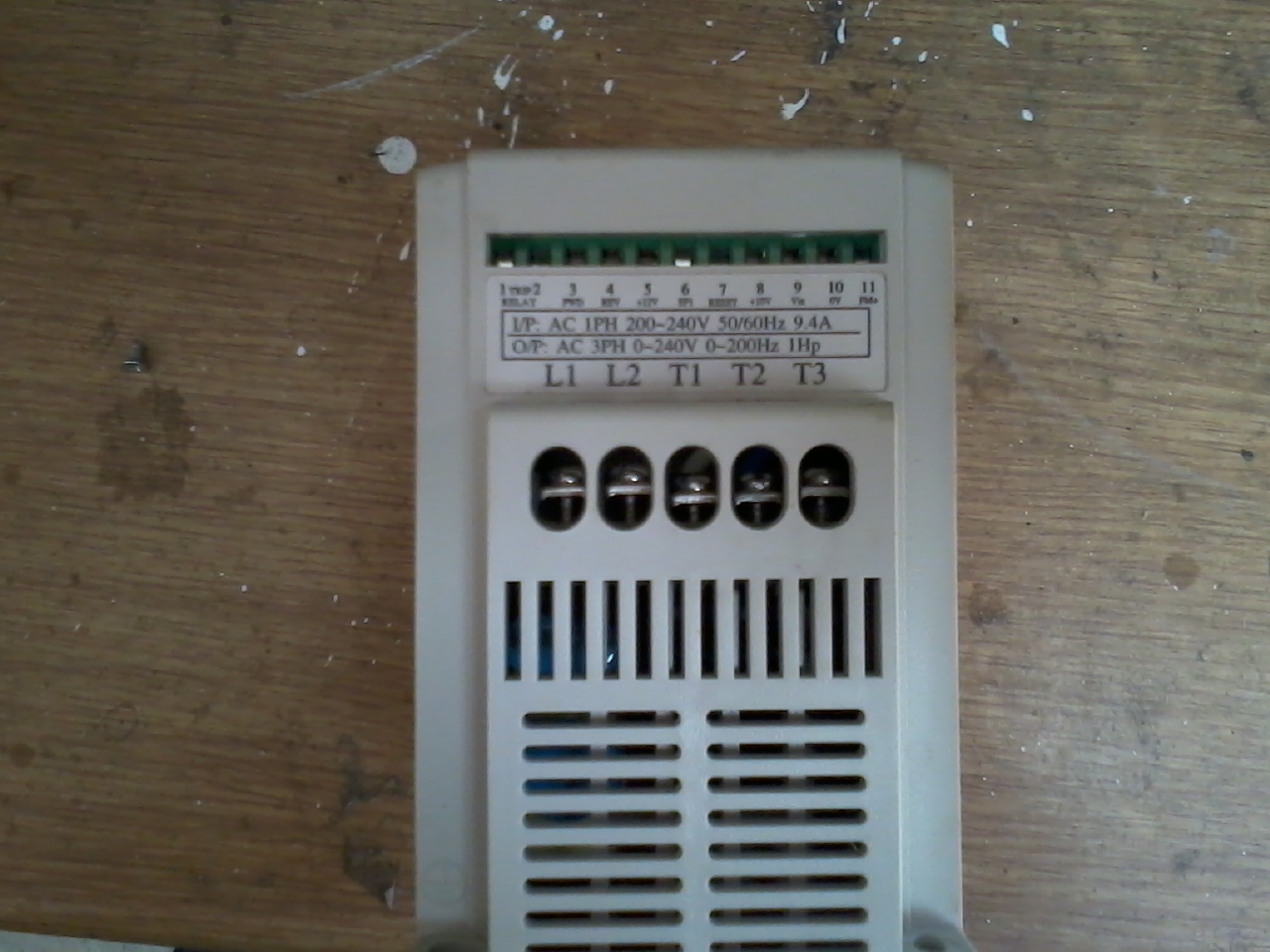

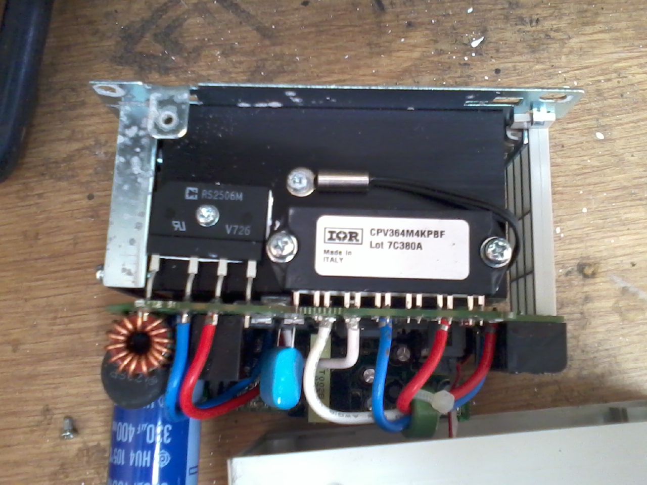

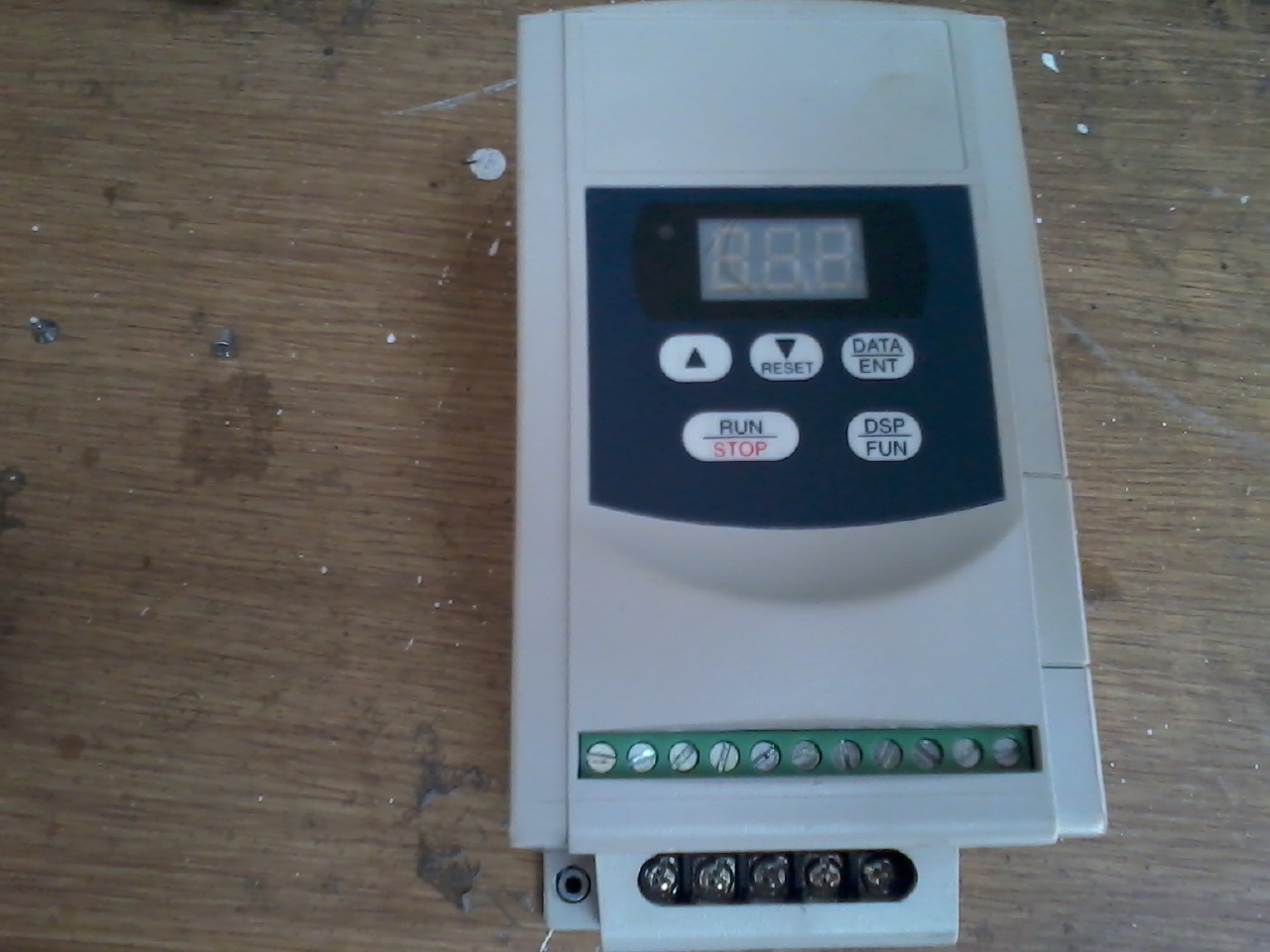

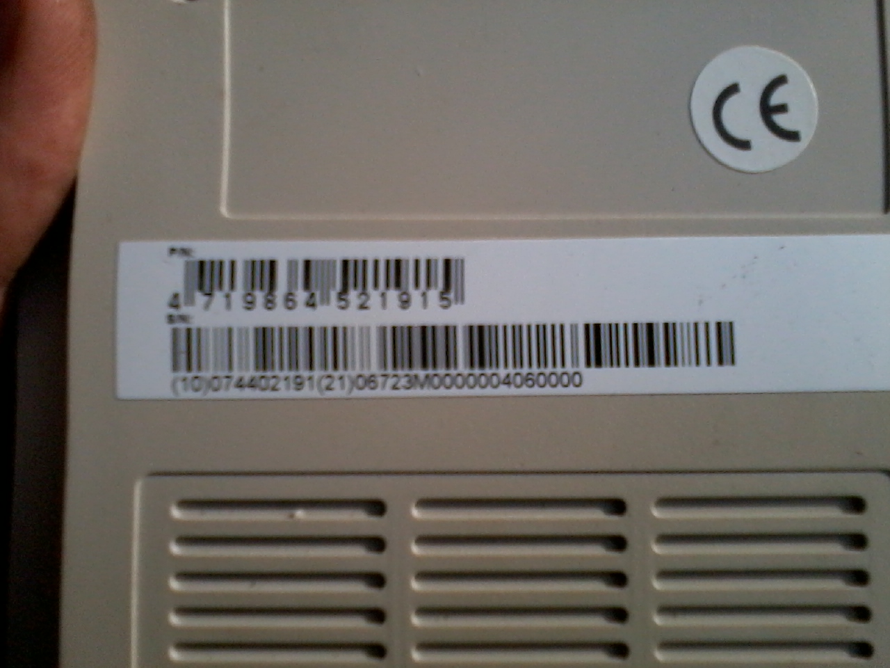

Here are some photos of the inverter, it is unbranded but with some European components. It doesn't look original, maybe somebody will recognise it so I can look for a manual. I am getting error codes if I try to reset it but without the codes I can't diagnose anything.
